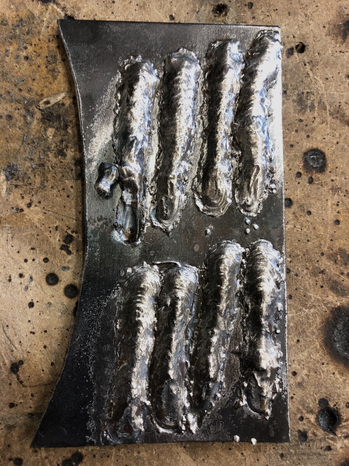

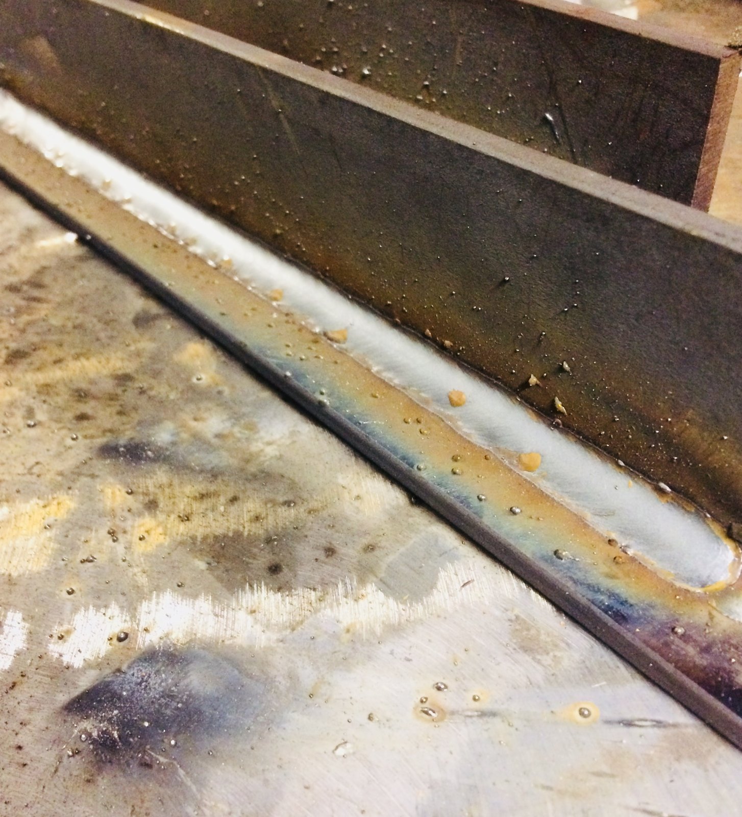

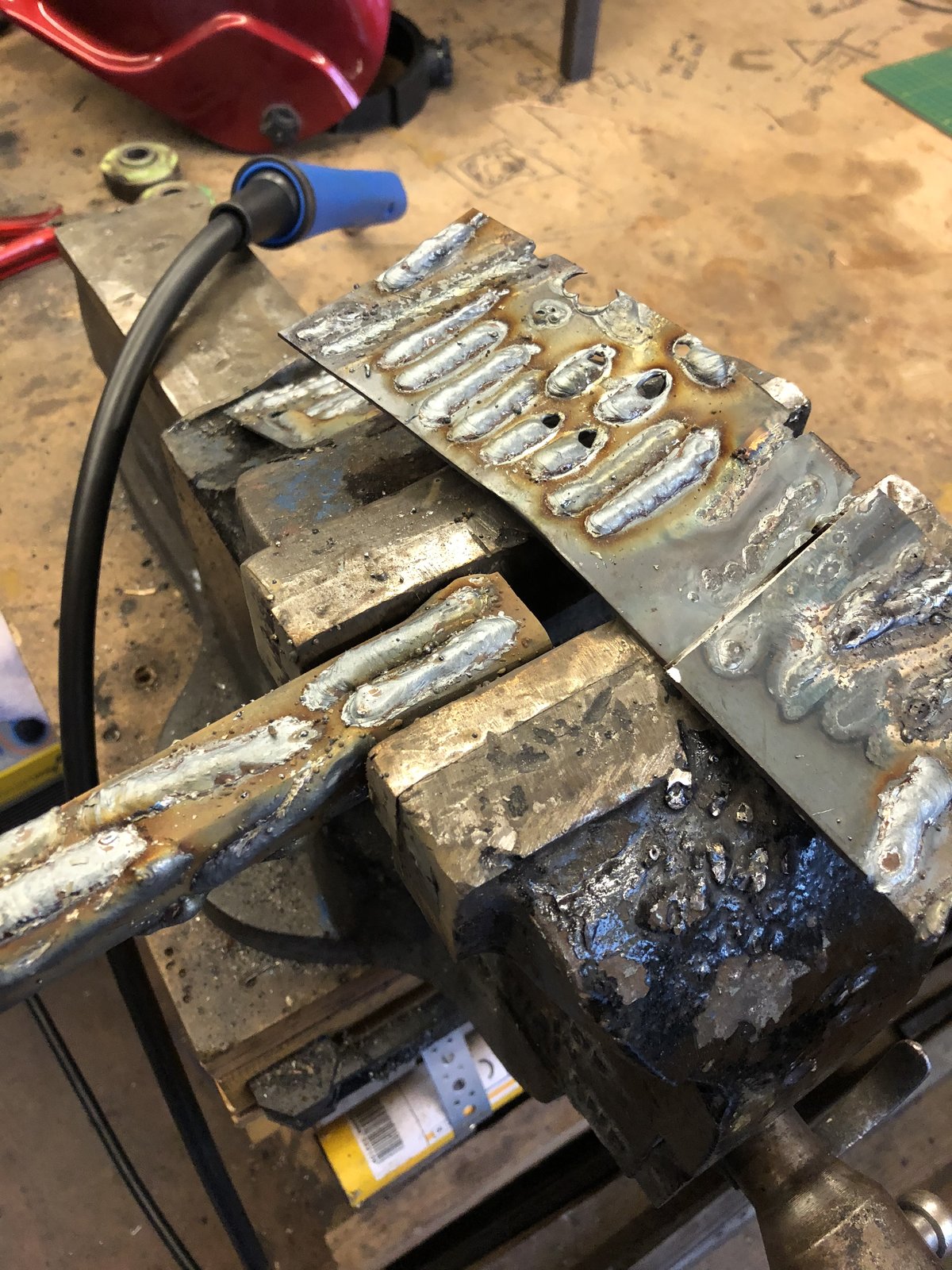

Please see my example
. Something must be wrong with your smartmig. It can not be the shielding gas. Have you set the maschine for welding with gas because it is a gas no gas welding mashine... At 160a it should do much better...Must be people here what have the same stuff and certanly can show you good welds... I have two Telwin Machines one old that goes to 120a and it performs better than your Pictures...
If smartmig was so crap no one will buy it.
