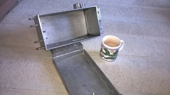

I make things out of mild steel. Normally most of these things live outside and therefore require a coating to prevent corrosion. I've been through a whole load of different things and they are all lacking in some fashion. To date I've been through:
So I've been doing some research and there's a couple of ones that looked interesting: Etch Primer and Epoxy Primer.
The Etch Primer seemed to be the bees knees but I see that it's been replaced/superseded by Epoxy Primer these days so that's what I thought I'd go for. My problem is that I'm not 100% sure on whether I've found the right stuff, it's a decent brand and I haven't made any stupid or incorrect assumptions. Would SWK be kind enough to sanity check me here please?
I'm looking for something:
For application I will be using brush and roller. I do have a small compressor and some paint guns that I got from an auction but I have no desire to use them for this as I would imagine I am terrible at it. I also have absolutely no wish to get into what's needed to spray 2K safely for me and anyone or anything in the surrounding environment. Obviously I'll be wearing appropriate PPE for hand application but atomizing it just increases the risk to a level I'm not comfortable with.
I've looked about and there's a couple of manufacturers that seem to be respected, Lechler and HB Body. Through no other reason than I can get a kit from one and not the other, I have found the following and wanted to know if this is all I need to get started?
I assume I'll be needing thinners as I'm brushing/rollering. I remember Langy saying he diluted his Lechler 10 - 15% for rollering and if I could get my primer to look half as good as his I'd be over the moon. Is the dilution rate based on the mixed quantity or the primer quantity alone?
Also, can I overcoat with a rattle can (I use Plasticote which has an acetone solvent) to get a colour I want? I'm not bothered if the top colour gets knocked etc so long as the underlying metal protection is still in place. I see that tinting the primer can be done but as I'm just starting out with this I want to get the bare basics before I commit to anything extra.
When I mix can I use a flat ended blade as I would with a "normal" paint? Do I need to pass what I mix through a filter at all given I'm not spraying or is that another step to make sure everything's homogeneous?
Sorry for such a long post but this has been annoying me and stopping jobs for so long now I just want to get the right stuff and move on to the next job! Here's the item I'm going to be doing first, it's an electric/network supply adaptor box. Goes above ground right in the way where it'll get kicked and is subject to a lot of coastal spray (I'm about 500m from the sea). Constructed from 4mm mild and about the size of a shoe box.
Thanks very much if you can offer any help and apologies again about the essay
Snooch.
