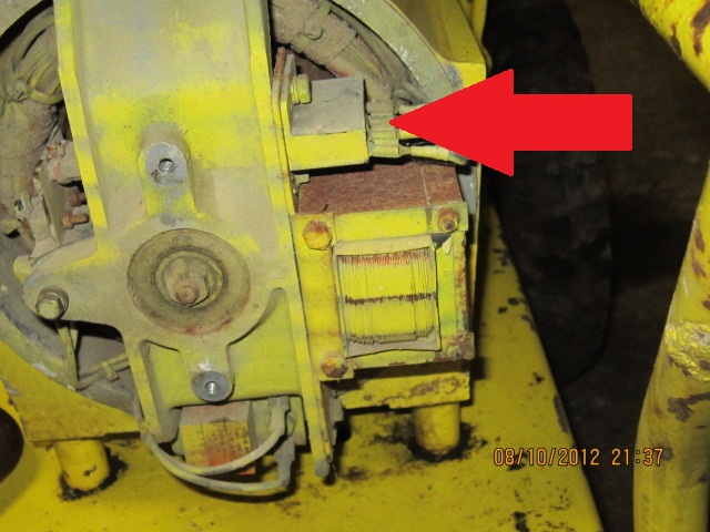

from memory i dont think there is any adjustment on those governors
just found an old markon with an avr check yours it could have either thought they were to old to have the avr but obviously not, the avr is the circuit board you see

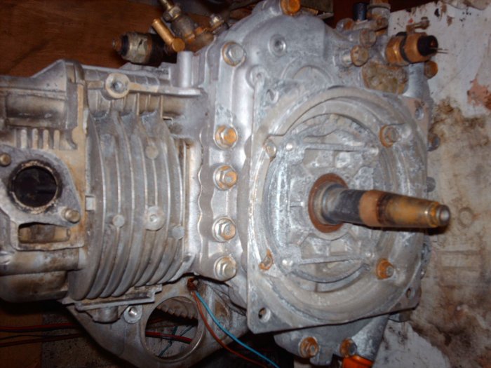

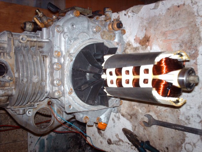

it will be a tapered crank with a bolt through from the end
the outer case will just pull off once unbolted from the engine and mountings unscrew the lock nut and then the armature will be free to be removed from the crank
crank taper and one with armature attached note bearing still on the end and the nut having no relevance to the casing that has been removed
