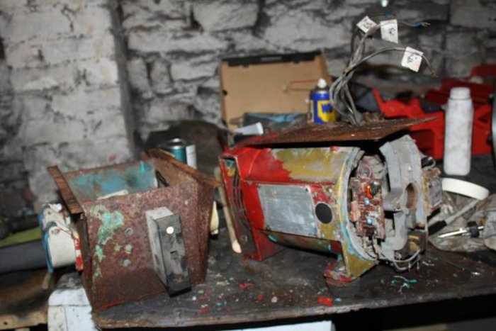

Recently got a diesel generator,it has a petter ad1 engine and a markon generator on it, the engine starts and runs fine, and will run an angle grinder or the like,however if i plug a kettle into it,it takes forever to boil and puts a good load on the engine. It wont even power a 500watt halogen floodlight fully,the light output is dim,
It has both 110 and 220 volt sockets. When i measure the voltage at each though im only getting 165volts at the 220 side and around 80volts on the 110volt side.
Would any one know if engine speed could effect this,if it was low,wouldnt the frequency of the current be low.
I dont know an awful pile about electrics,so hoping somebody on here will.

to measure the frequency,or seen as thats for a 13 amp socket,would i get a differant reading by connecting it into a 16 amp socketor does current rating effect the frequency
