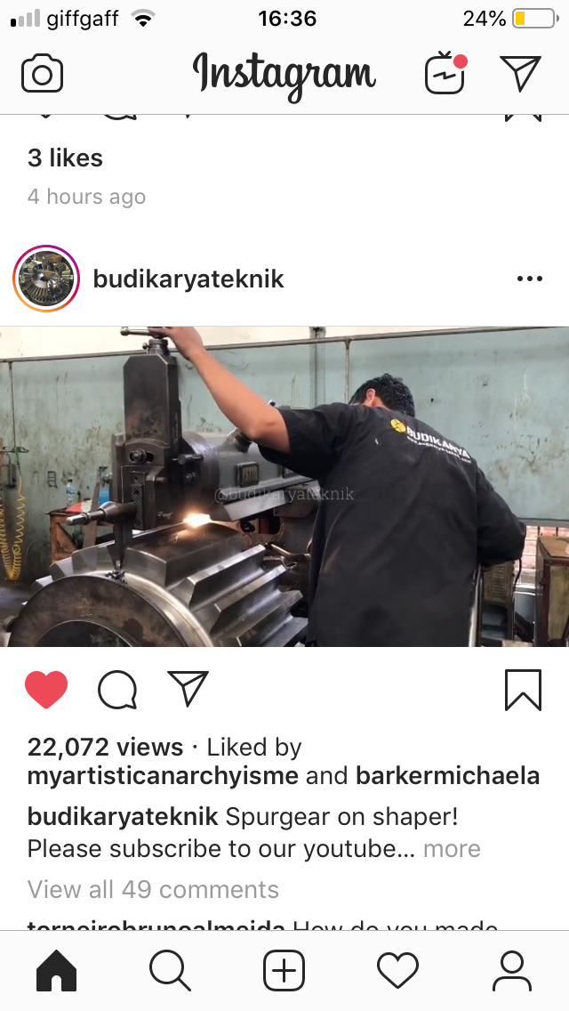

Saw this on Instagram
I was impressed!

Any idea how that would be set up to cut
They dont look involute so no addendum and dedendum to contend withAny idea how that would be set up to cut
Can't make out the tool profile in the pic

That's what I was puzzling overIn that first pic it looks like he is only roughing out the bottom of the cut. Must use a form tool to then get the shape ?

Would they have cut one side of the v then indexed to the other side and cut then finished off the middle to square the root?
No my trade but like to understand.
