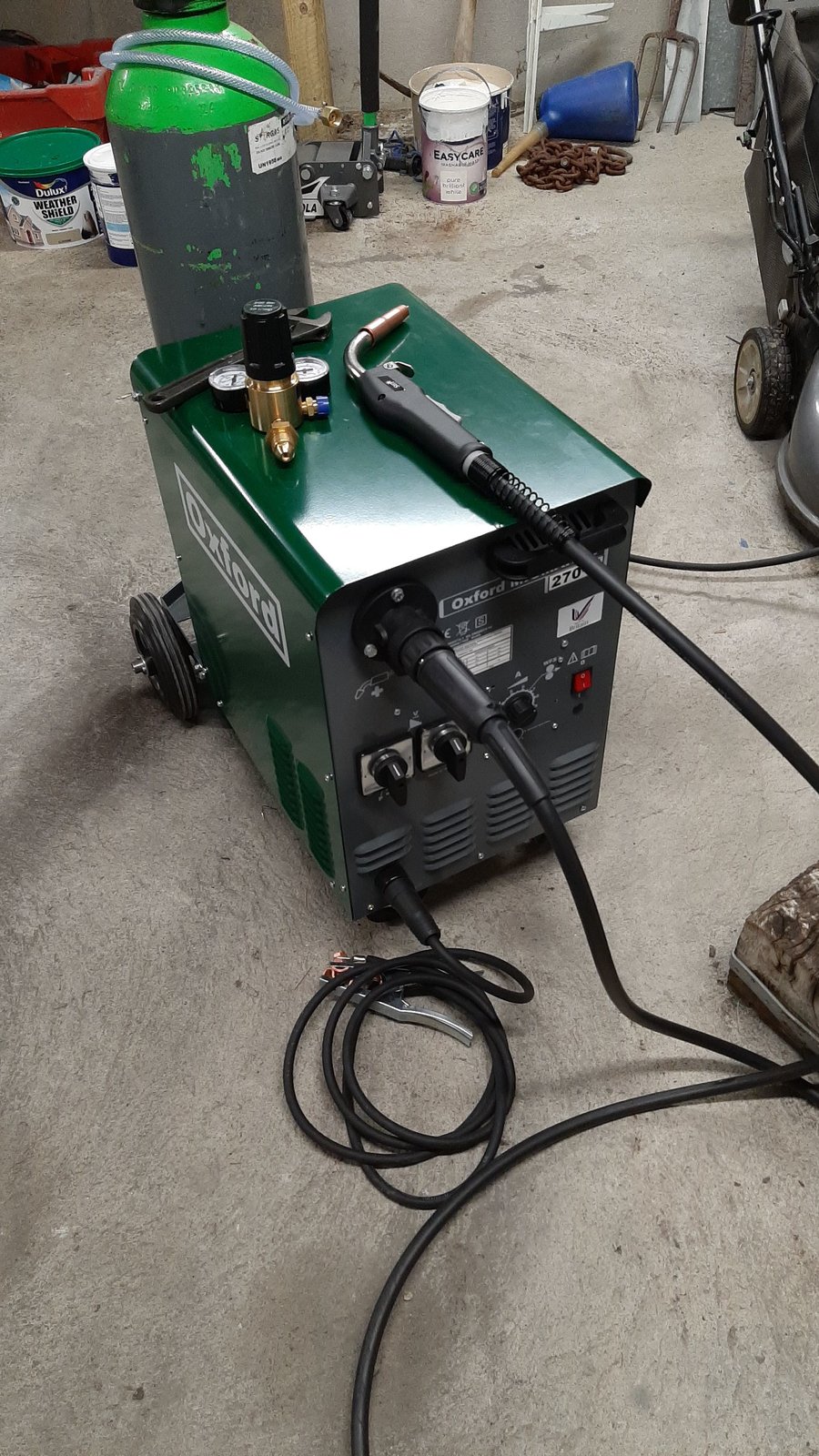

Hi just bought a mig welder and wondering is gasless wire any good be four i go out and buy a bottle of gas
My welder is oxford 270-1 migWhat welder is it, some of the cheapest MIGs can't have their polarity swapped easily and have no provision for adding gas? Starts to get expensive if you need to put down a large deposit and buy a regulator, flow meter, hoses, spanners etc. as well as the gas.
Depending on what you are doing gasless wire may be suitable, I did a job a few weeks ago welding a load of 2mm galv steel outside and used cheap wire from Amazon that worked fine. Don't buy a big reel as it won't keep - the flux will absorb moisture.
That's quite a good welder, you may have the opposite problem to what I thought - does it have the option to run gasless? Some way to switch polarity?
