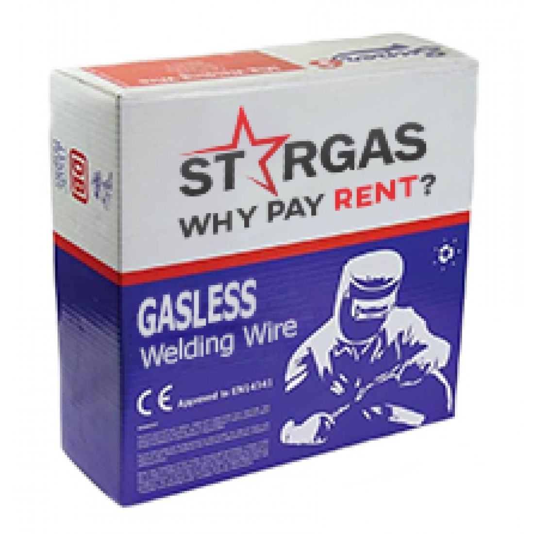

  13. Davey223 Member
    Messages:
    83
    Location:
    Ireland
  14. Davey223 Member
    Messages:
    83
    Location:
    Ireland
    Is that a good wire

    From Sunday.
    You will need to reverse the polarity on your machine to electrode (torch) negative
  16. Farside
    Farside Badly Welded Man
    Messages:
    3,696
    Location:
    Ireland
    Not got any direct experience of Stargas, and considering they don't make it themselves, are likely buying in by the cheapest quote from some far eastern supplier, I'd avoid it.
    As said, Lincoln, etc.
