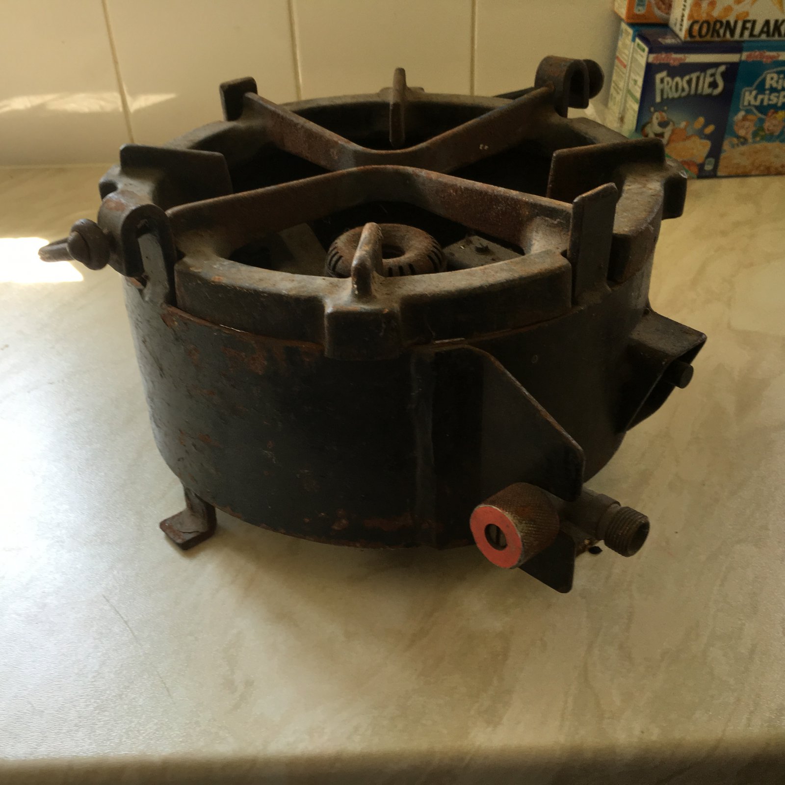

I've got several propane regs and some new 8mm hose, just need the little barbed connector to go on to the threaded section, and yes your right they do consume some gas but put out an awesome amount of heat.Standard LH fuel thread for propane I think Parm.
Edit: should be 3/8" LH BSP. Given how hungry it is 8mm bore should be enough but SWK will be able to advise better.
Planning to use it at a local beer festival where I've been asked to do a "Jungle Curry" for 150 people. I can now use my 35" diameter cooking pot
Up until this popped up yesterday I wasn't quite sure how I was gonna do the big curry as I had no heat source
