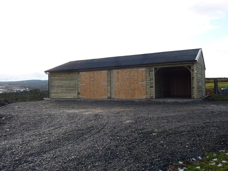

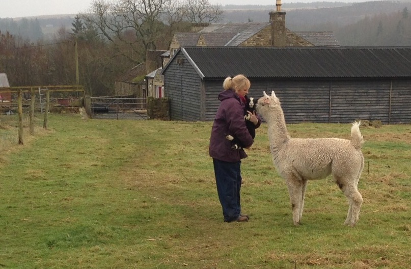

Heres a couple of pictures of my onduline roof, it is boarded underneath with OSB for stability, the boarding makes it last far far longer, as Ive a field shelter where I used it but it sagged a bit in the really hot weather.
According to the data sheet its good down to 10 degrees, you just increase the overlap a bit.
