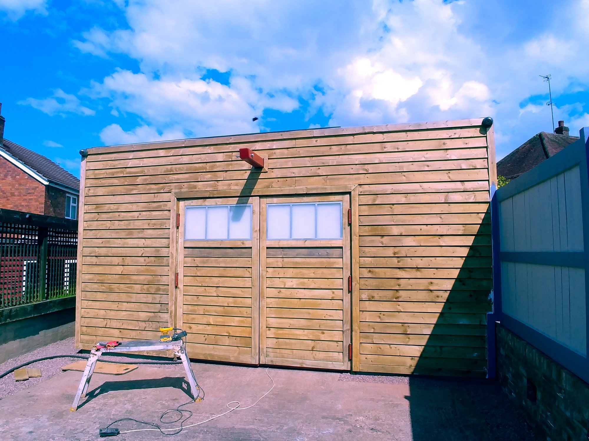

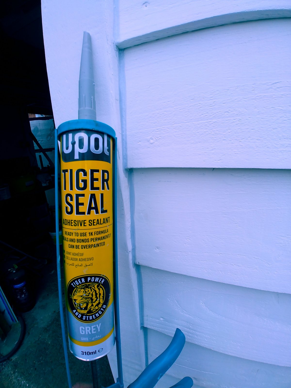

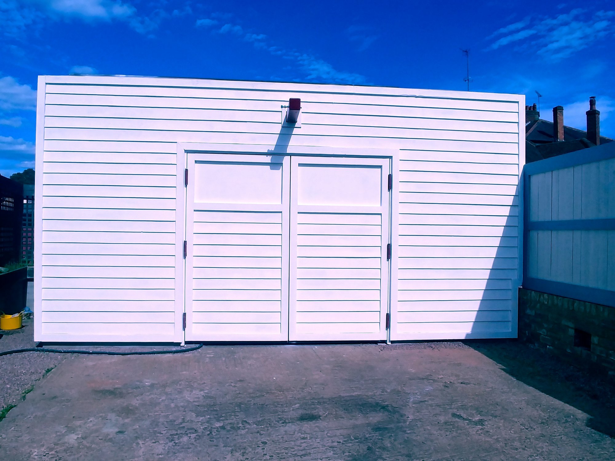

Refined feather edge....thats clever.That looks like decent cladding material. Thank you for info.

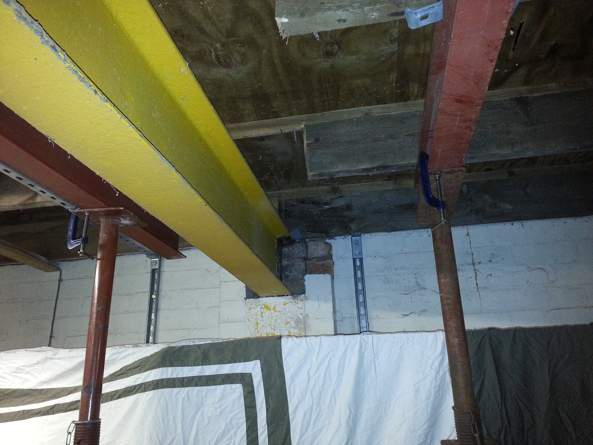

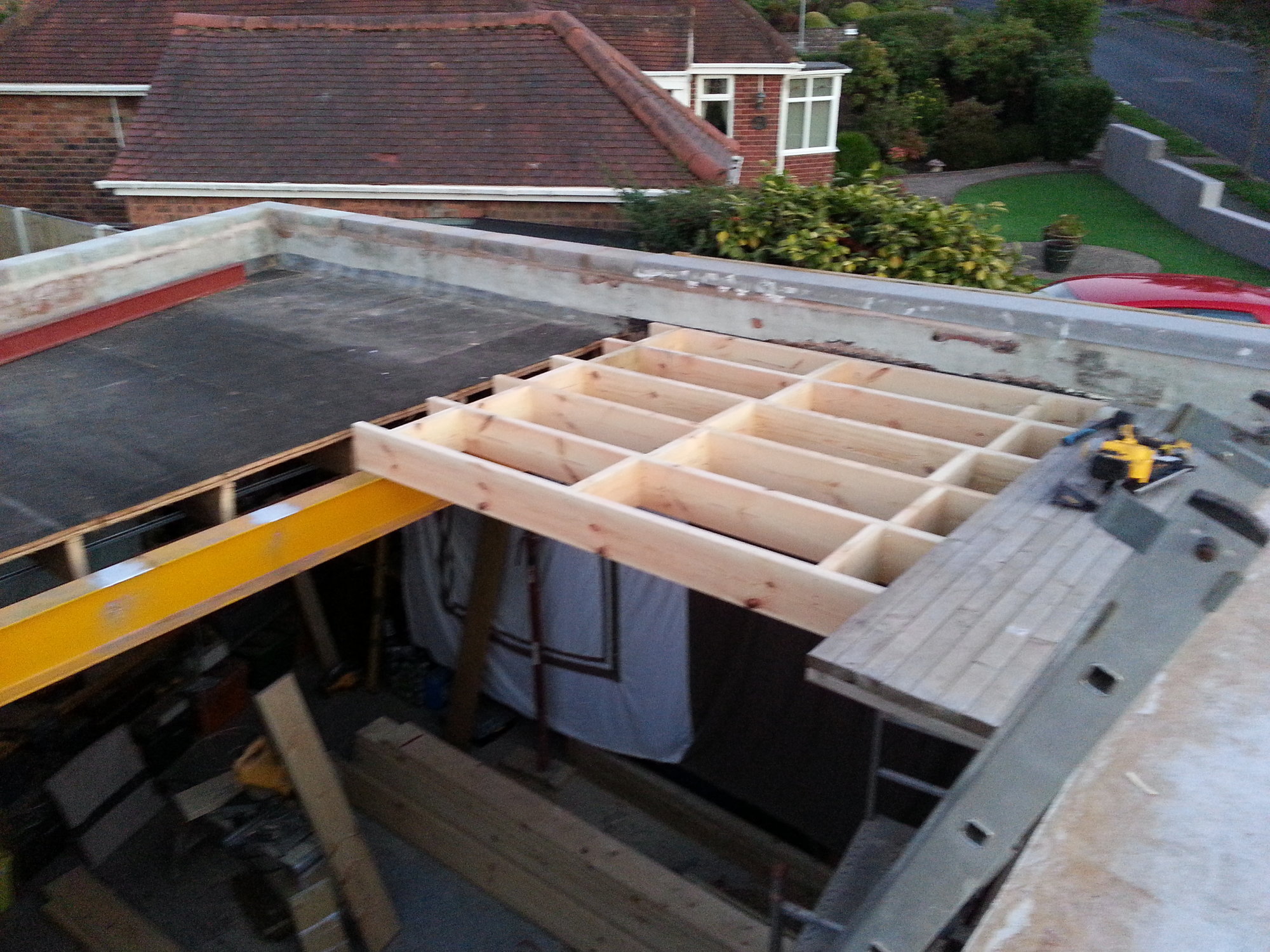

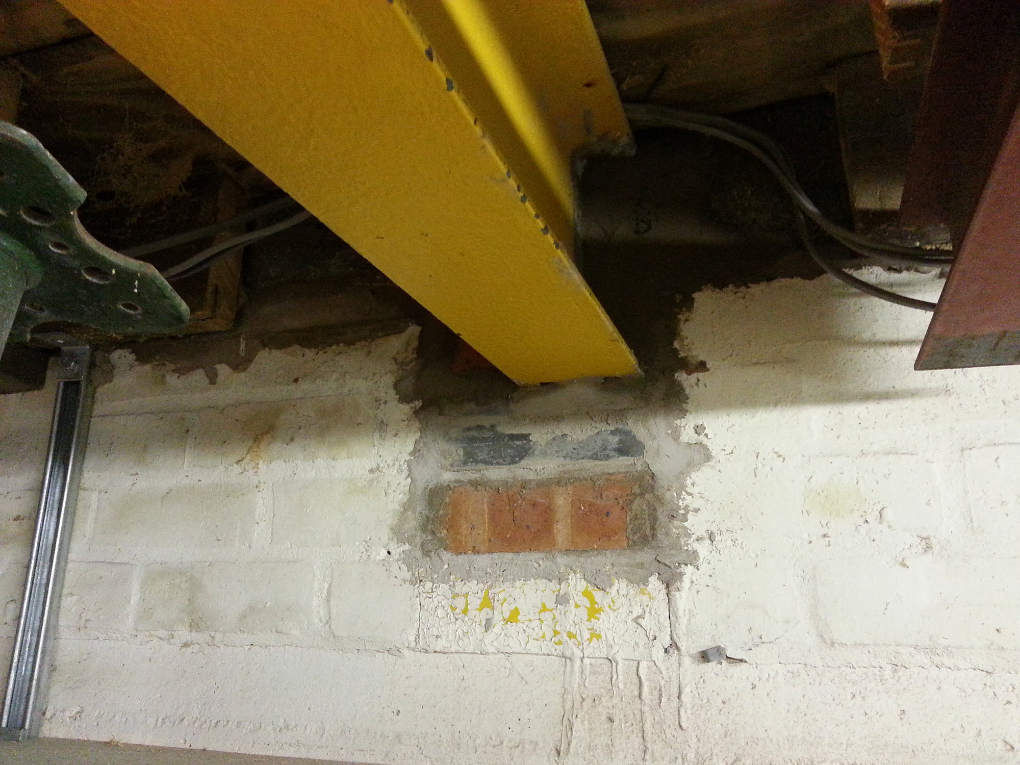

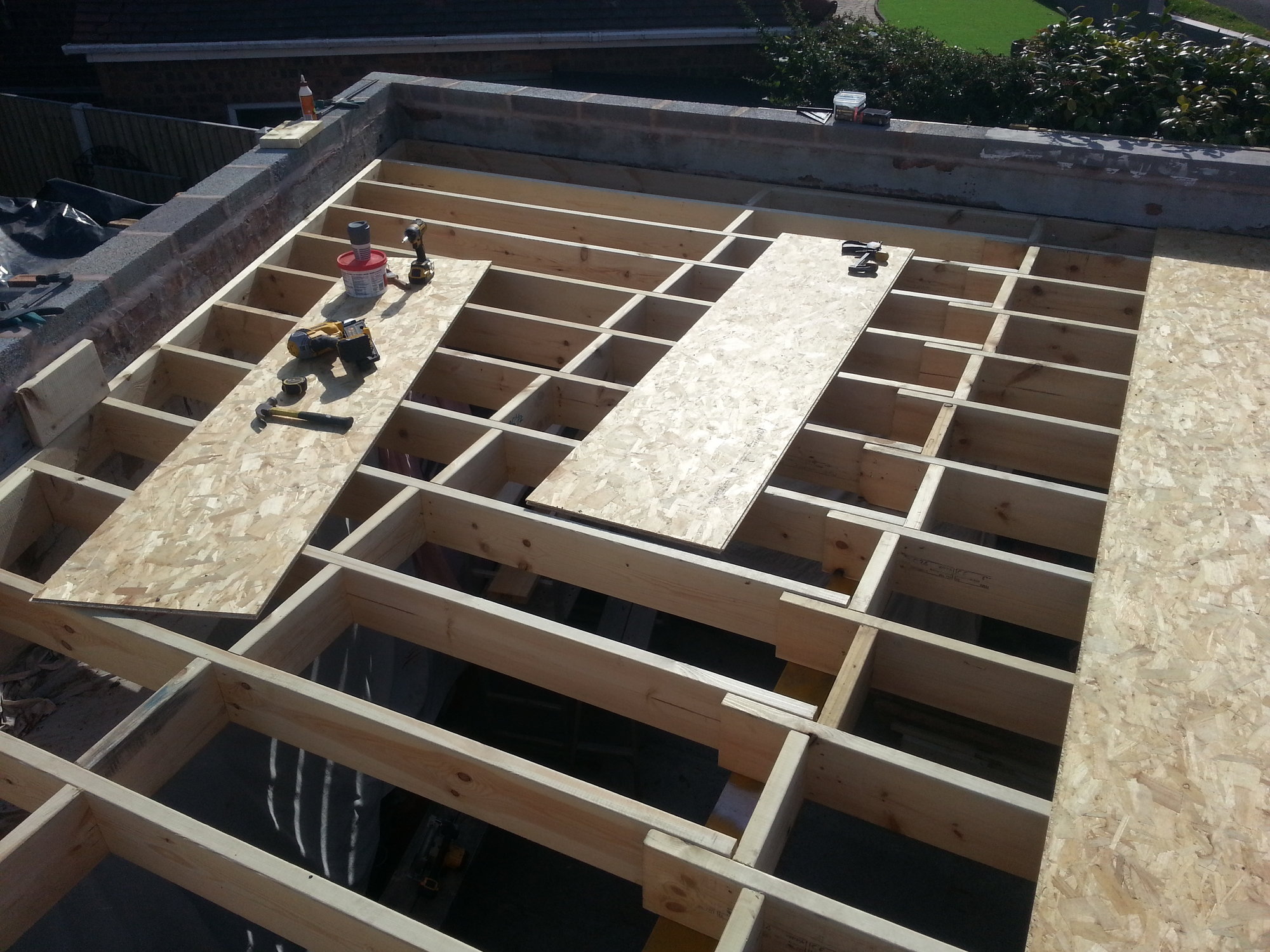

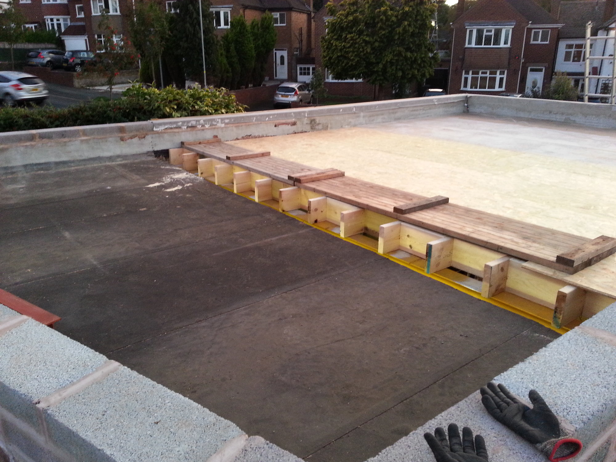

Do you mean where they join up on the yellow beam?people say do osb come in tongue and groove boards

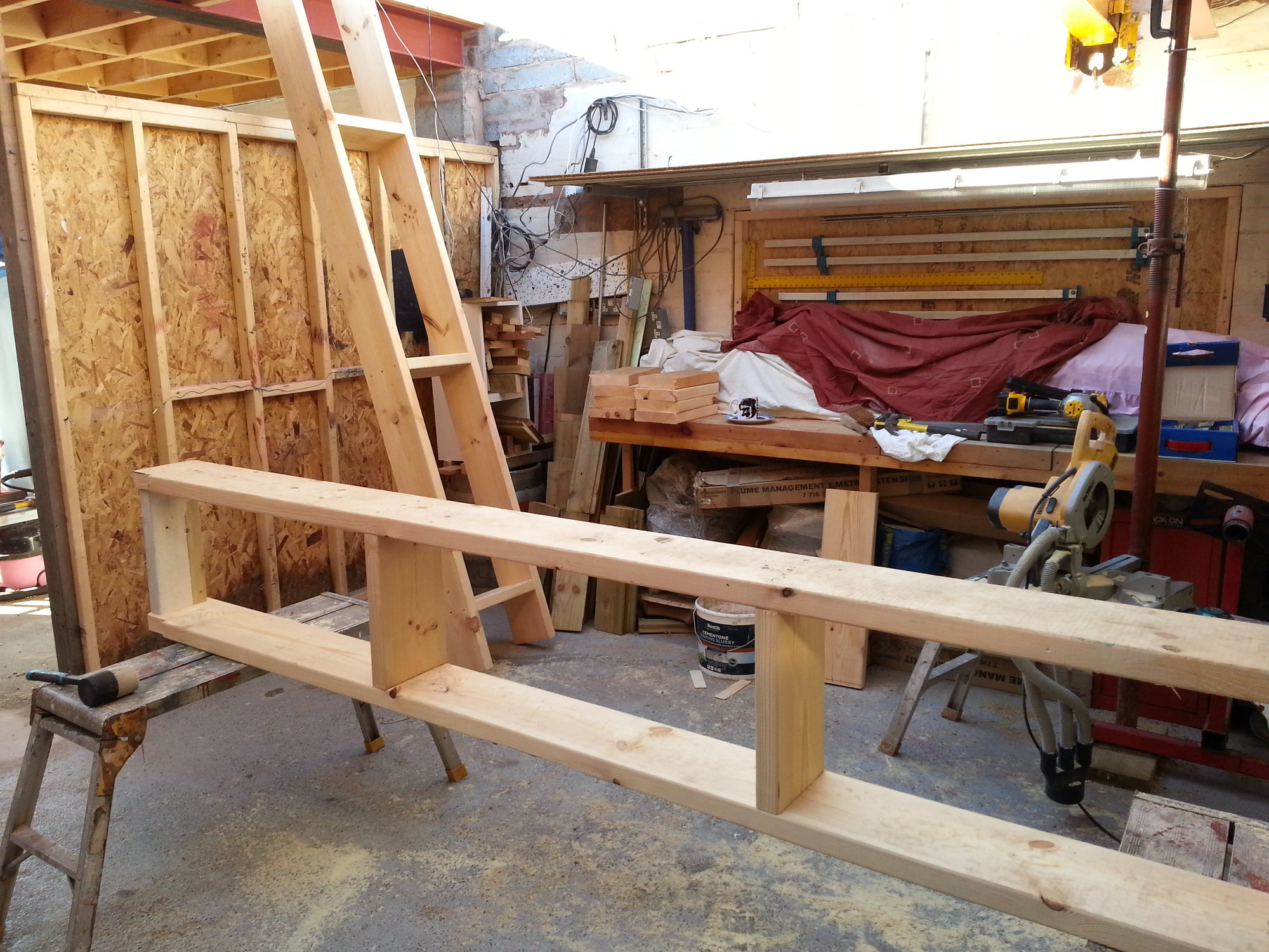

nice build there just noted that you hadnt fastened your beams up to the other beams on the pics though

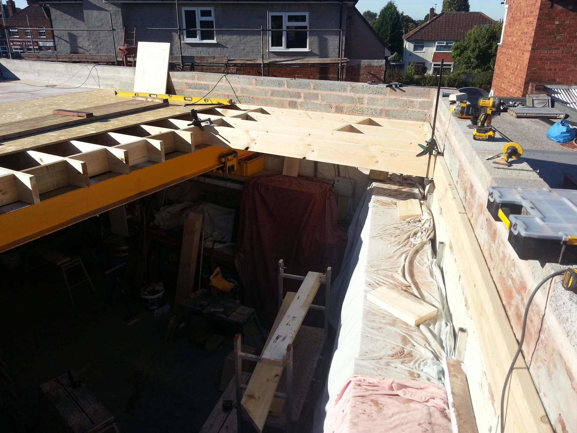

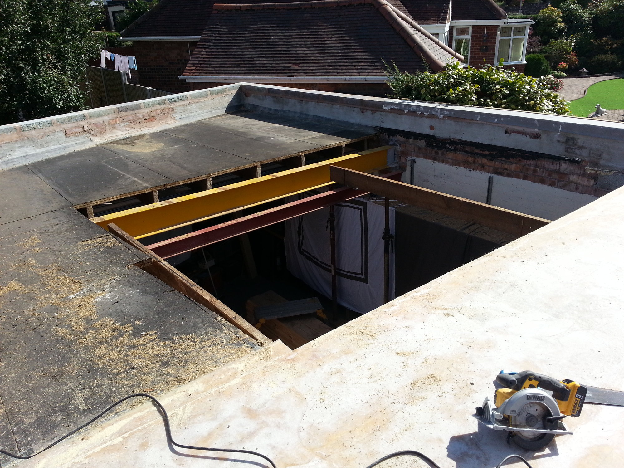

It did occur to me to let natural light in but the LED panels we put in are more than bright enough and later on i want that roof as a floor subject to getting planning permission for an apex roof on top.Did you think about putting a skylight of some sort up there, to increase natural light in the garage?![]()

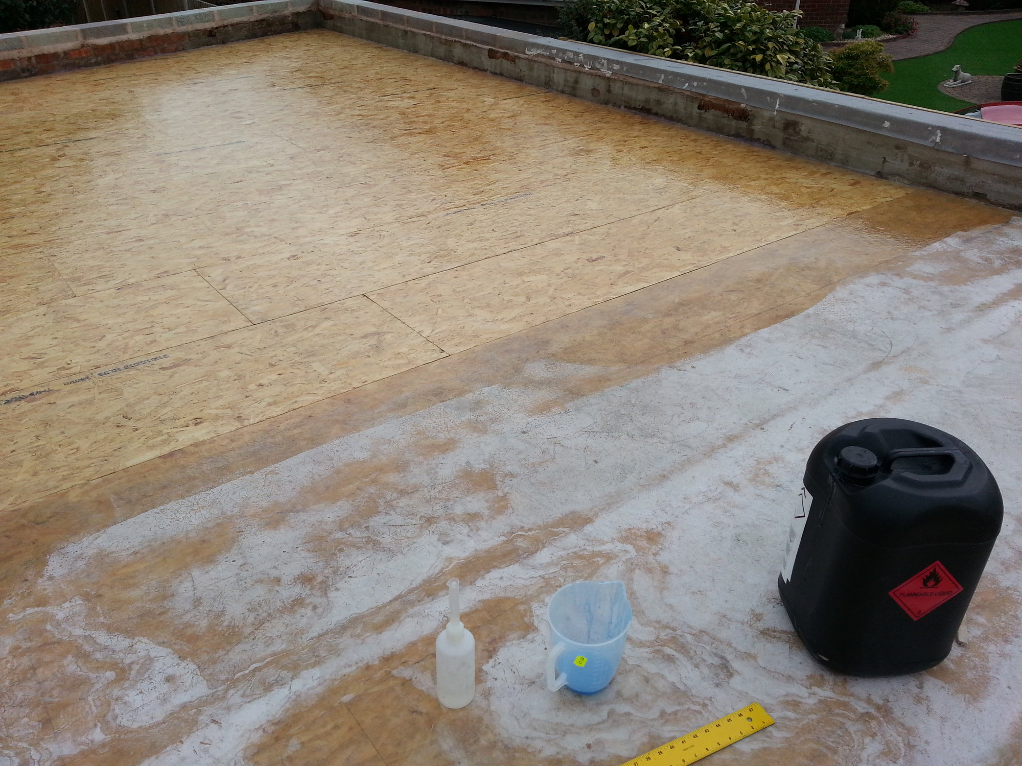

There is a 110mm outlet in the front corner that i fibre glassed in at the last moment before the grey finishing coat, It runs inside the building so if i ever get a sink inside it can maybe go in the corner into the same pipe, It may end up for now that we turn it into a grass roof from seeing other buildings with grass roofing it cuts down noise and adds to insulation.Looks a fab job but i am not feeling the glass and resin...Whats your provisions for water discharge? i might be having a blind moment but cant see any roof outlets or gutter drip edges
Adds a tremendous amount of weight too, espescially when wet.There is a 110mm outlet in the front corner that i fibre glassed in at the last moment before the grey finishing coat, It runs inside the building so if i ever get a sink inside it can maybe go in the corner into the same pipe, It may end up for now that we turn it into a grass roof from seeing other buildings with grass roofing it cuts down noise and adds to insulation.
I found a pic of the drain hole i put in...Looks a fab job but i am not feeling the glass and resin...Whats your provisions for water discharge? i might be having a blind moment but cant see any roof outlets or gutter drip edges

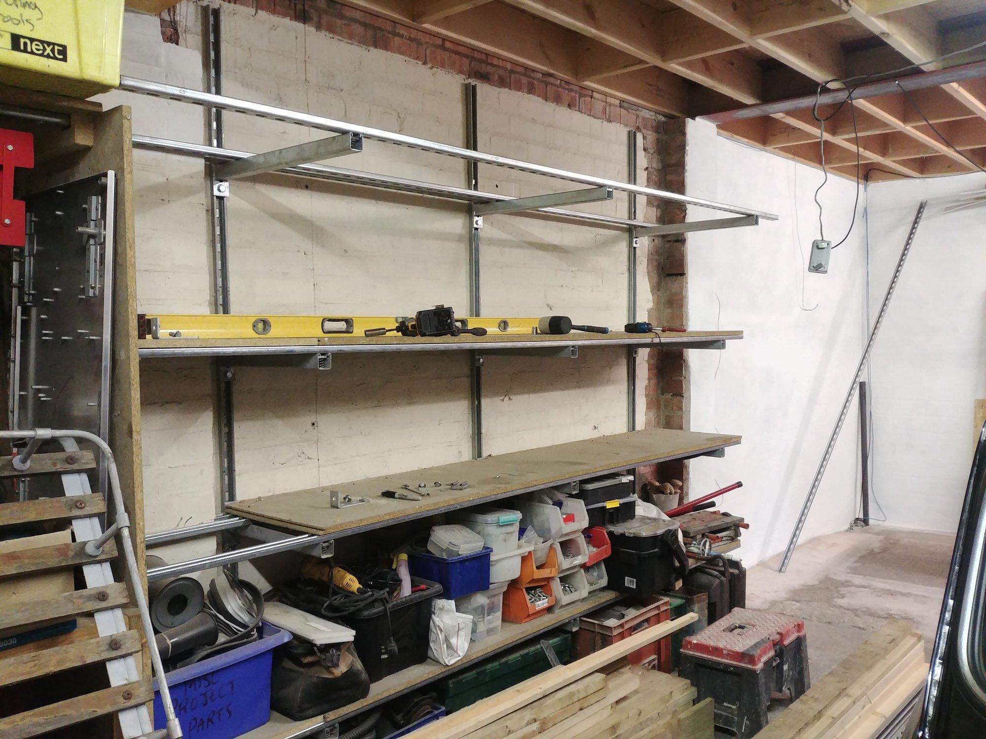

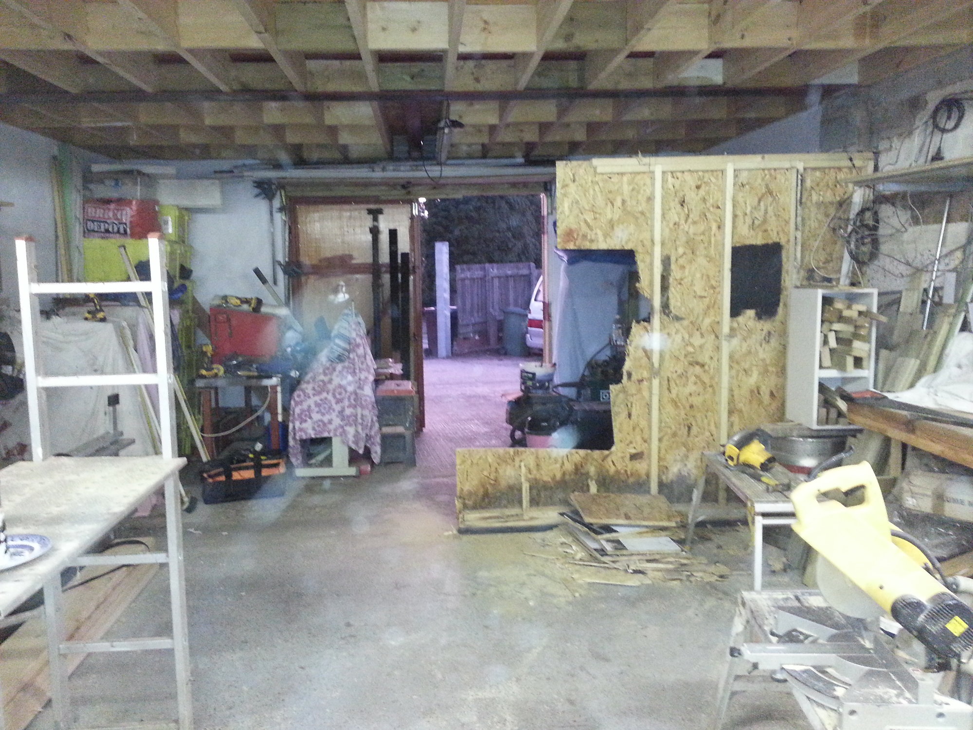

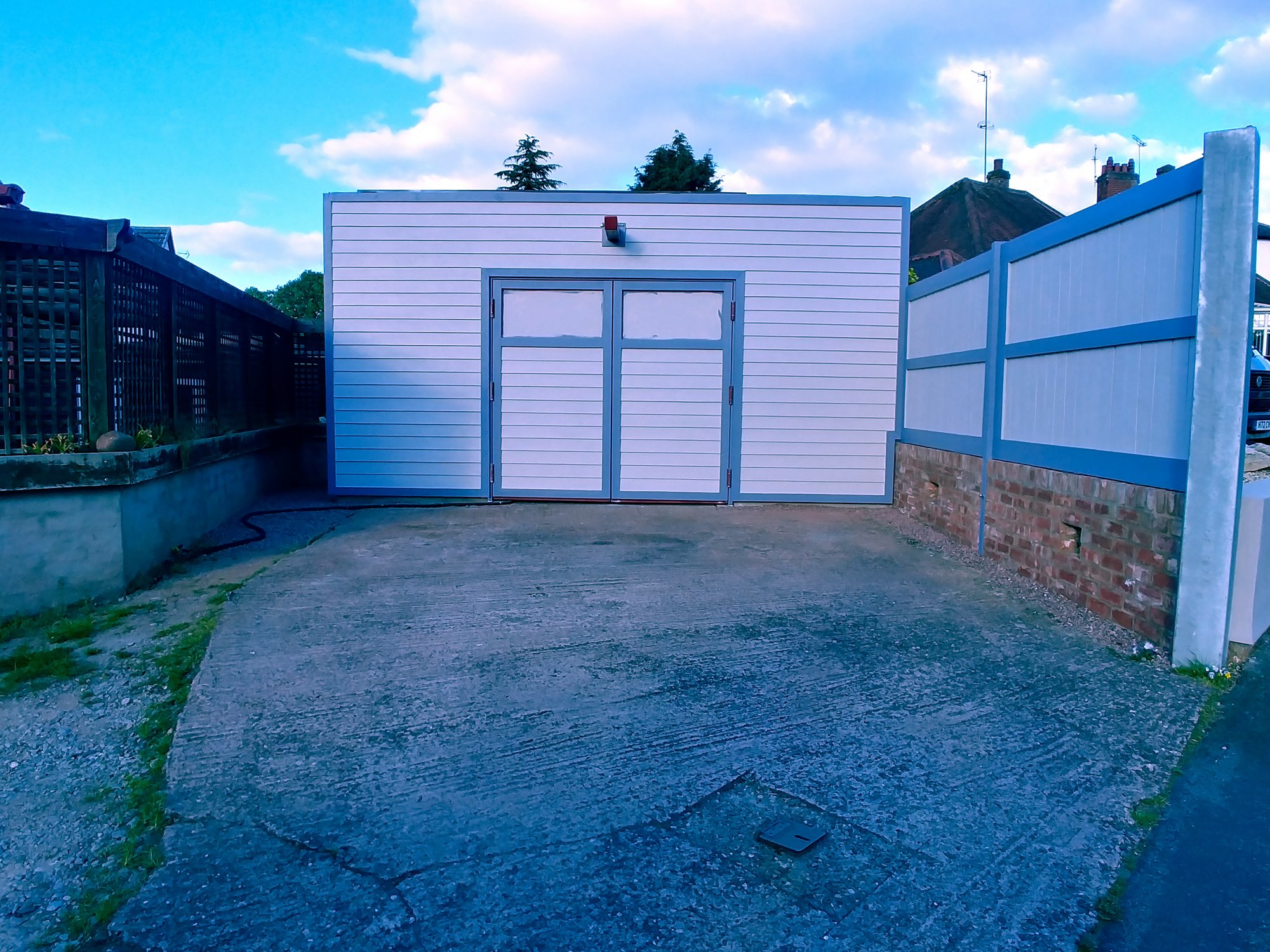

It is a great space i was lucky enough to find a house with space to expand, But now i have to get on with finishing the house so i have to share time between playing in the garage and serious DIY.Wish I had a garage that big! Looks a great working space
Yes the pad is so useful, I watched a guy jack his van up on block paving a few years ago and it made a nice mess, Eventually i will make a decent looking drive but they never seem practical.And with the concrete pad out front it's a really fab workshop space you've got.
