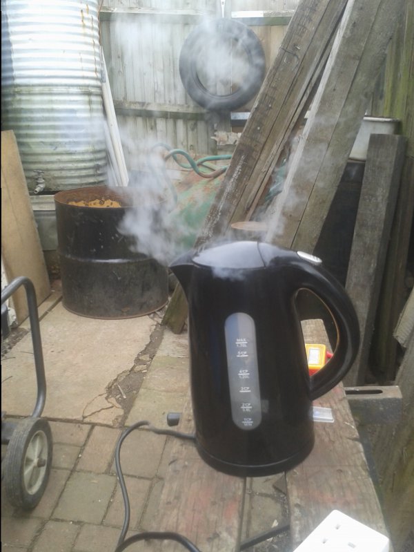

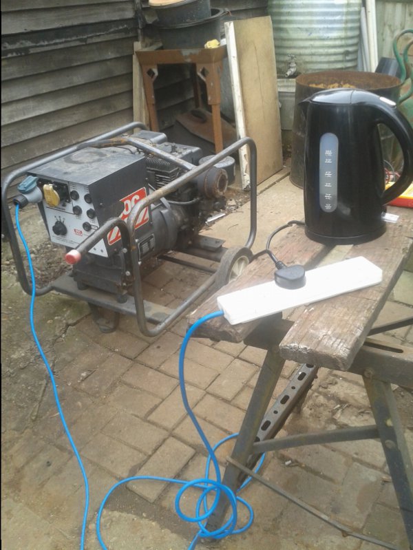

Further more,seem the 240 genny side works
Now thats the main test it boils the kettle
Also ran an grinder and a 1200w hoover both under load so happy there,haven't got any 110v tools but i'll borrow something from someone.
Main this is to sort out the welding side of things,think i'll go with adaptor plugs easy for me and saves hassle![]()
