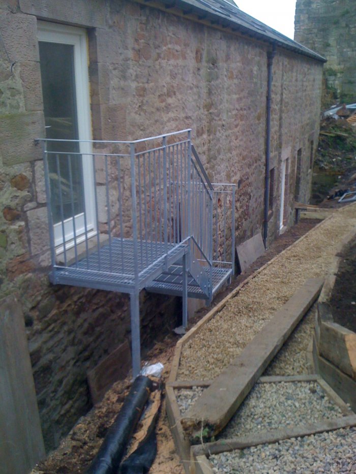

We were working in Berwick Upon Tweed , Glasgow was considered but only chose Newcastle as it was closer. I doubt we will again and I'll probably send the trailer to Glasgow.

Have the legs got much of a bearing on the wall?
