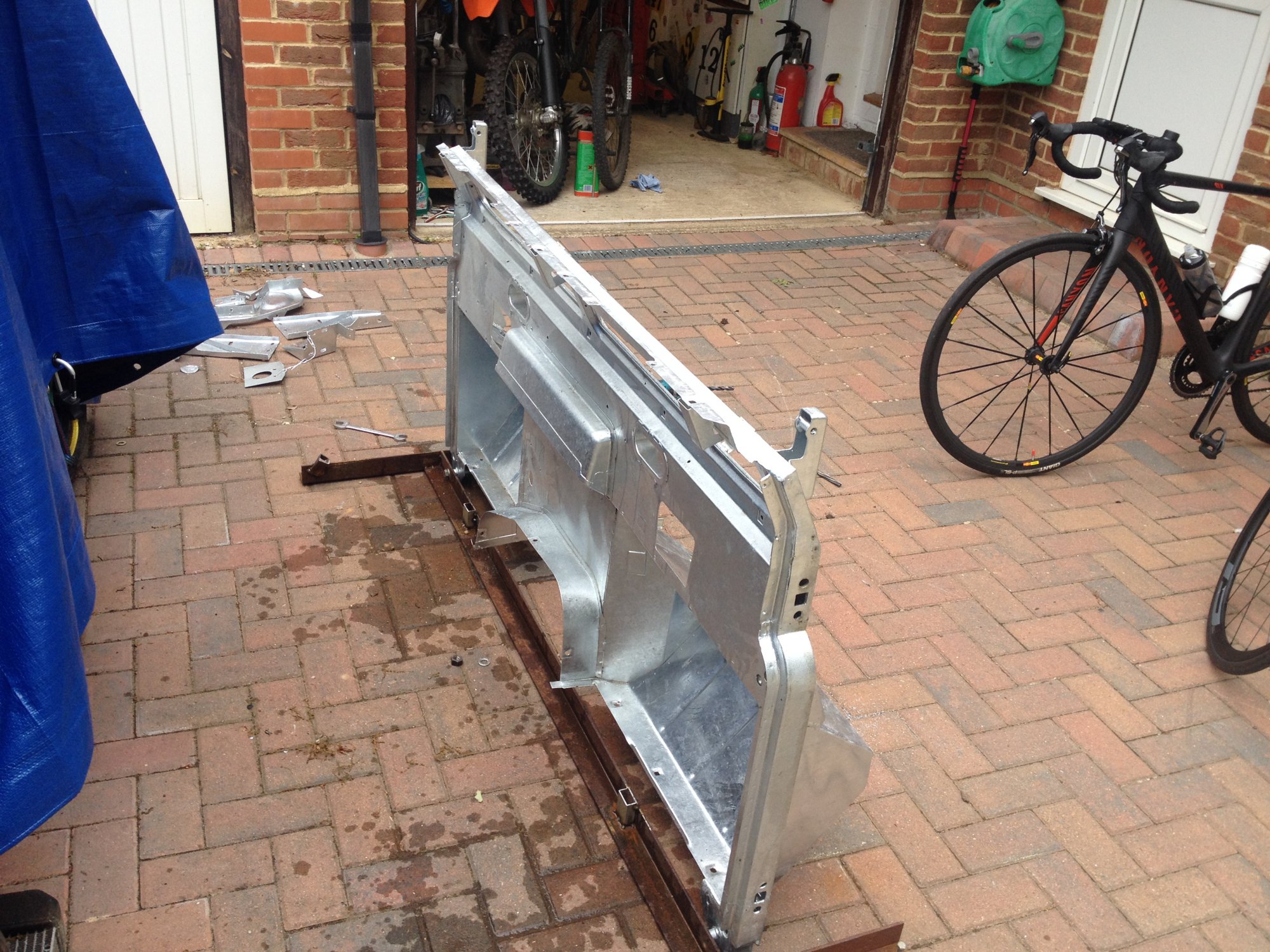

But can it not be electroplated rather than hot dipped?? Wouldnt have problems with distortion then
View attachment 82590 Had my Land Rover bulkhead hot dipped, you can see a few ripples but it bolted straight back onto the jig I made for welding it on, now its painted and installed you would be hard pressed to see any distortion.

I am considering having some galvanising done, but looking for some advice on how much distortion I am likely to encounter, before proceeding.
The bits I have are Land Rover door frames and sill/B post/C post assemblies. Both are made of pressed steel channels and box section. Both are fairly thin, I would guess 1.2mm for the door frames, 1.5 on the sill assemblies.
Any thoughts?

how did you seal the seams to stop water ingress ,allways wondered ?View attachment 82590 Had my Land Rover bulkhead hot dipped, you can see a few ripples but it bolted straight back onto the jig I made for welding it on, now its painted and installed you would be hard pressed to see any distortion.
