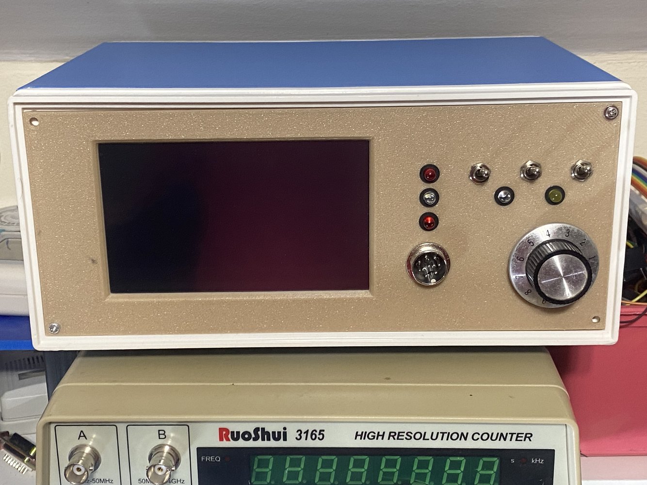

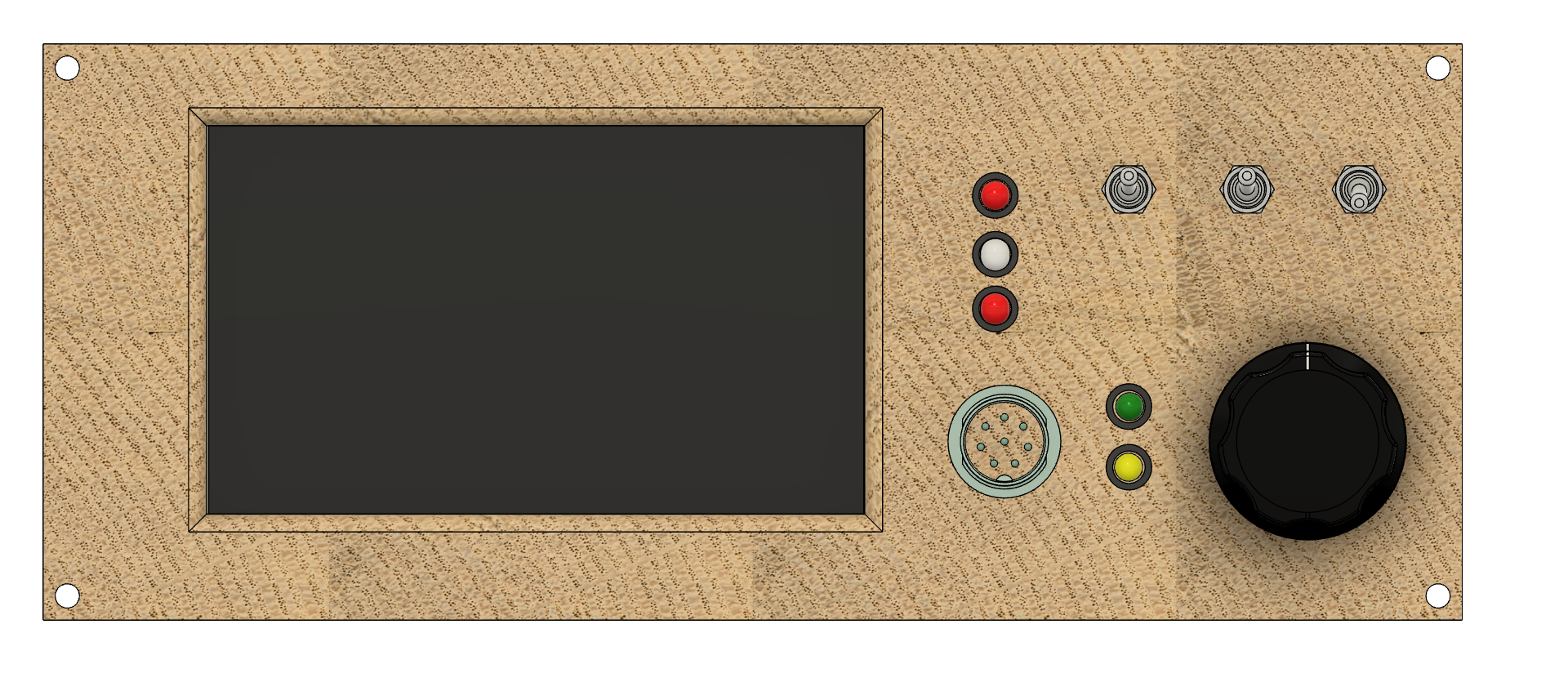

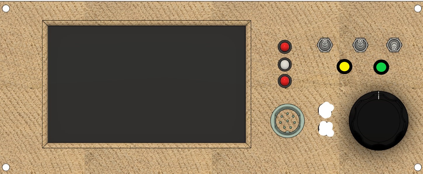

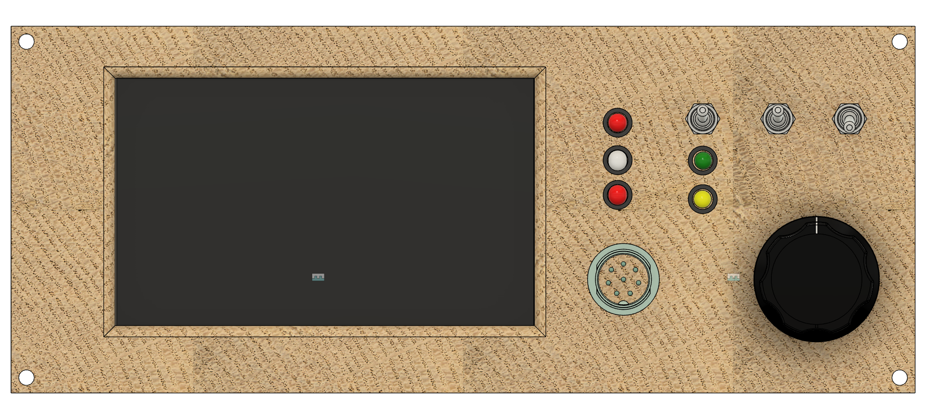

This for me out of the three last posted.
I did think green and yellow spaced between switches but paintshop doesn't look that great but may be better if done properly.
:How are you going to label it? Are you going to use embedded text?A mock up of it in the flesh. The panel was supposed to be wood effect PLA but I have seen better. I think it will be a blue one again.

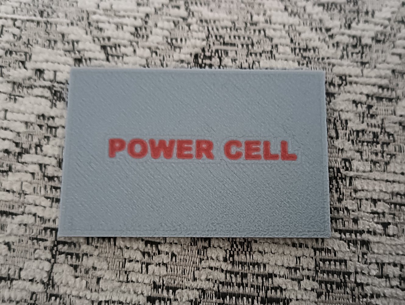

I quite often do coloured text with my mono printer, e.g. the labels you can see if you zoom in on this image:With a mono printer, I would have to emboss and fill the text with paint or something.
Other examples (some embossed, some debossed), all done on a single extruder printer:I quite often do coloured text with my mono printer, e.g. the labels you can see if you zoom in on this image:
They're done by inserting a change filament command after the penultimate layer. That stops the printer & lets you unload the filament & load a new colour for the final layer.
In Prusaslicer, you just press the + icon by the last layer & it sorts the rest out, but alternatively you could manually insert a colour change GCODE command (or just a pause if that's all your printer supports - then you could manually change filament during the pause).
