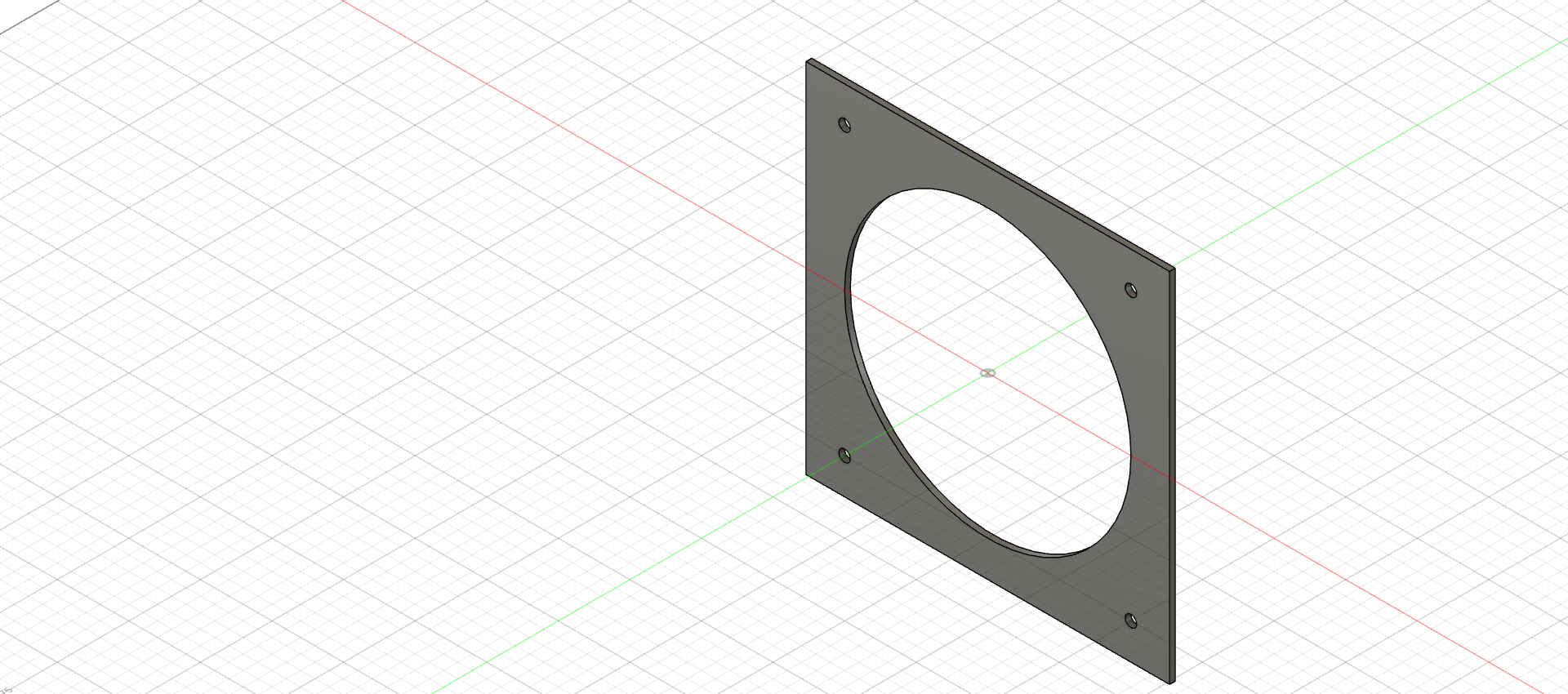

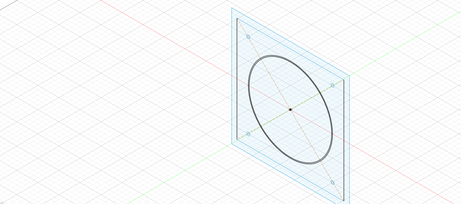

I am drawing a tumble dryer vent as an exercise. I have created the 2D sketch of it, but when I try to extrude, the selected part does that, but the rest of the sketch disappears!
yes, as above (post #2) the sketch goes invisible, and you can change the visibility.I am drawing a tumble dryer vent as an exercise. I have created the 2D sketch of it, but when I try to extrude, the selected part does that, but the rest of the sketch disappears!
Probably an attempt to declutter the workspace. The fact that I rarely find it an irritation means that most of the time it's probably the right thing to do (for me)yes, as above (post #2) the sketch goes invisible, and you can change the visibility.

Most CAD packages hide sketches off automatically when you've used them. For some, there's an option so you can leave them visible if that's what you want (I've no idea whether Fusion has this option).
Why do you still want the sketch to be visible? Everything in your sketch has made it into the solid body as far as I can see. If you want to do the next extrude/sketch/whatever relative to the features of your sketch, you should reference the body features instead. Updates to the first sketch will update the body, which will then update anything referenced to the body.
Your method is not very good.It does need to be made solid, but each part of it is extruded to a different thickness. When I extrude one part, all others become unselectable. I did manage to find the "switch" but it resets itself after each operation, which is very irritating.

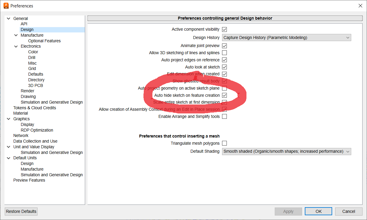

There is an option in preferences to change this behaviour: (Click on your user ID to get to preferences)I did manage to find the "switch" but it resets itself after each operation, which is very irritating.
