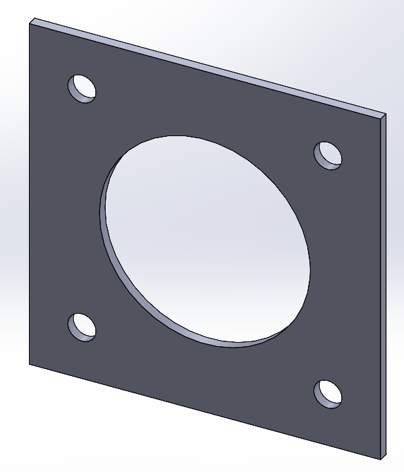

I will look at a different way of sketching, but I can't see how having multiple sketches is going to be easier to build the item. It may just be that I have got DSM too tightly ingrained and perhaps that is harder than starting from sctratch.
There are a few different ways you could make that part (assuming it is just one part and not multiple bodies)

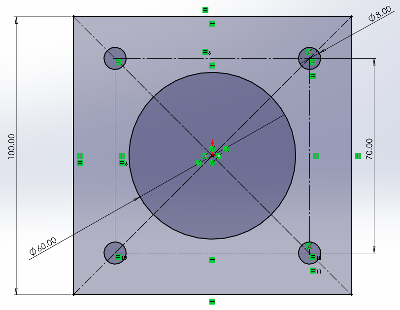

What you've done as a first sketch is a reasonable approach (but certainly not the only one). I thought I'd work through a couple of methods to show how I might do it. I won't use Fusion because I don't like it, but the method would be the same in principle.

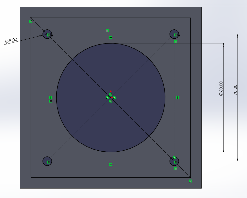

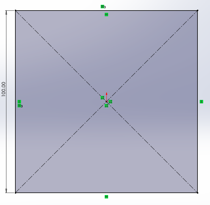

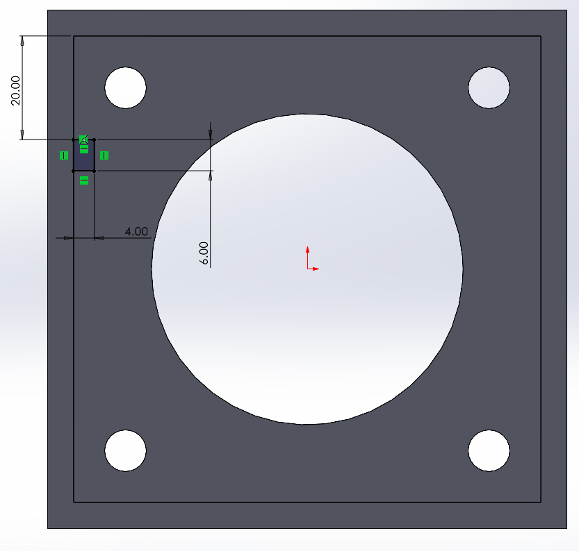

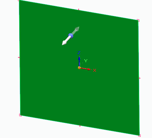

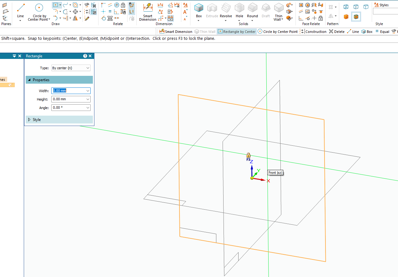

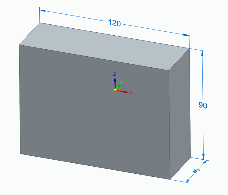

For the first method, we'll start by creating a sketch on one of the main planes:
You'll note that there are only four dimensions driving this: the overall box size of 100 mm (with the left side and top side constrained to be equal), the construction box size of 70 mm, the inner circle size and the top-right mounting circle size. Everything else is constrained to be equal to or coincident with something else.

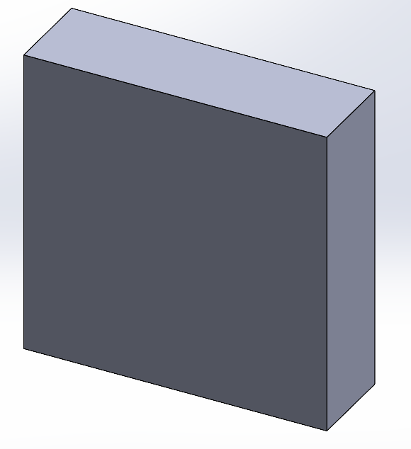

That gets extruded (I went with 3 mm thickness):

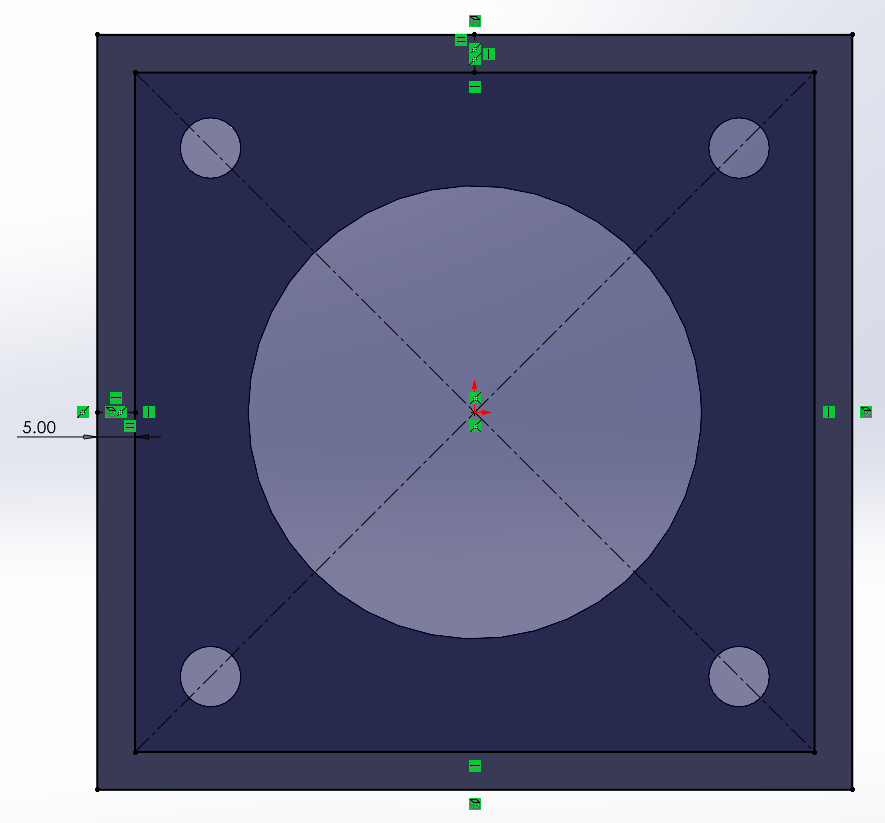

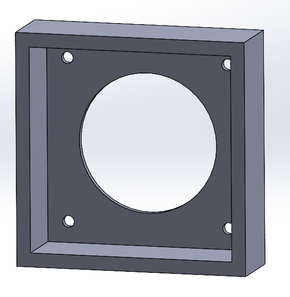

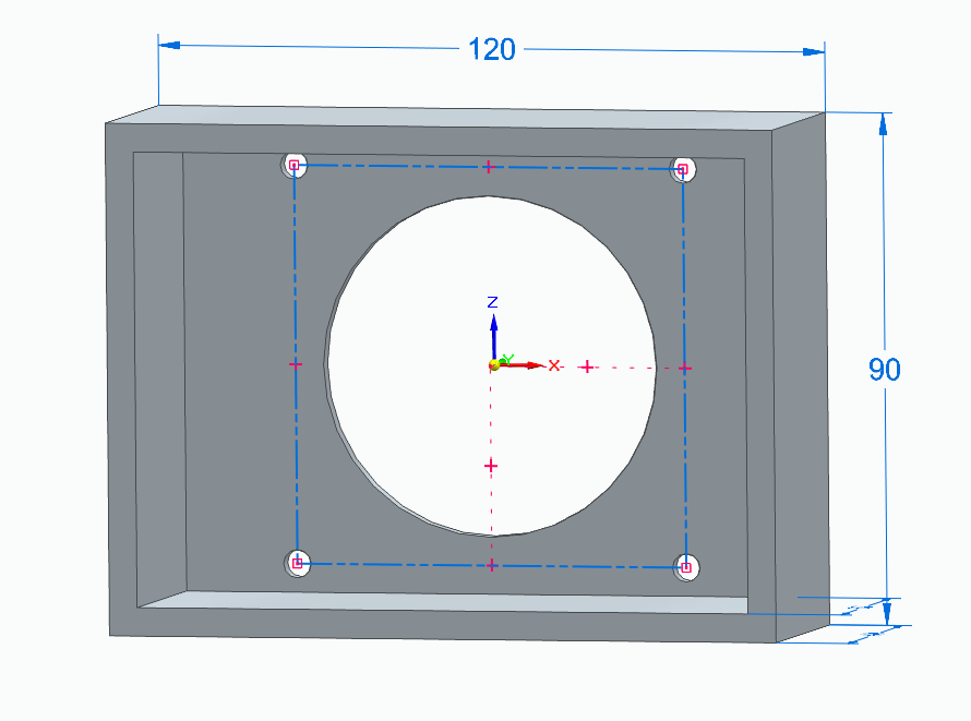

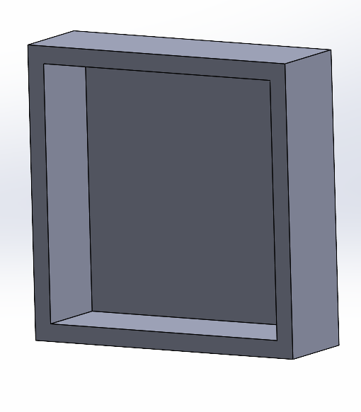

I then create a new sketch on the nearest face of the part:
This time, there's only one dimension. I created some construction lines going between the left side and the outside and between the top side and the outside and constrained them to be equal. That keeps the thickness the same, even if I go back to the earlier sketch and make it non-square. I didn't draw the outside box: I just pulled it (referred to as "Convert Entities" or "Use (Project/Convert)" etc depending on the CAD system) from the body.
I then extruded that (merging with the first body):
The same face as before was used for the next sketch, which needed three dimensions:
which was also extruded:
Note that I'm just picking random numbers for the dimensions as I don't know what you're aiming for.

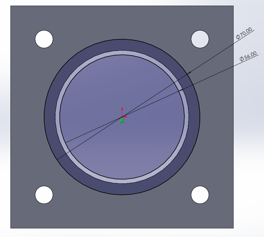

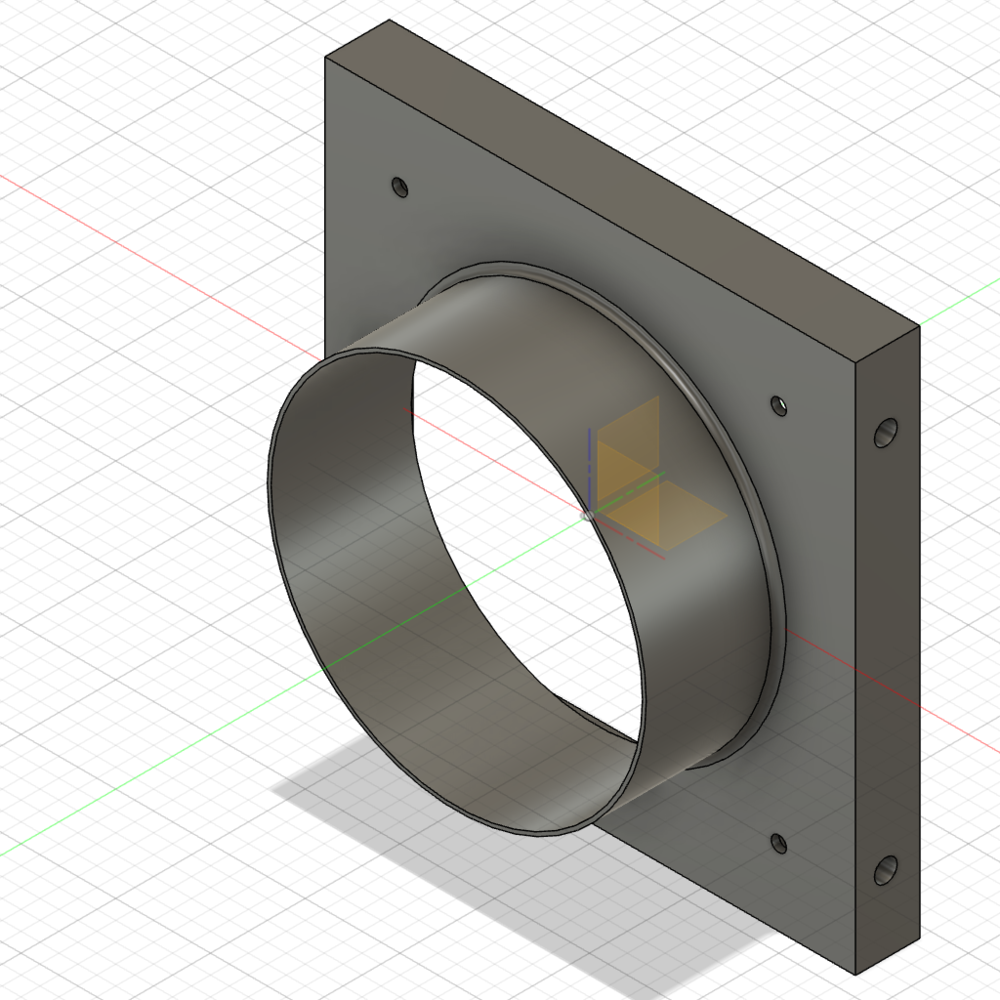

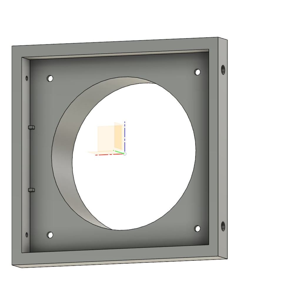

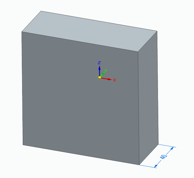

I then span the part round and created a sketch on the back face:

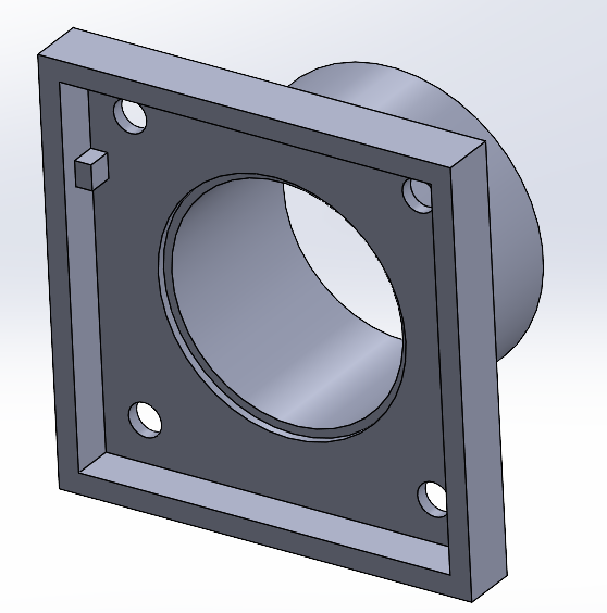

The circles are constrained to be concentric with the bore of the existing part, but I deliberately didn't use the inner diameter as your model makes it look like there's a reduced diameter and I'm trying to match that look.
That got extruded in both directions, 1 mm one way and 40 mm t'other.
Okay, it doesn't look much like yours, but that's what comes from making dimensions up as I go along
This is the method I probably would have used to make it: hope that helps.

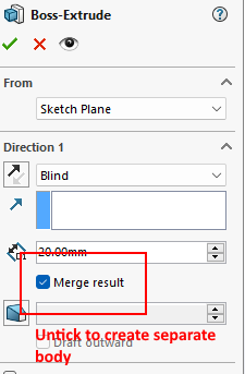

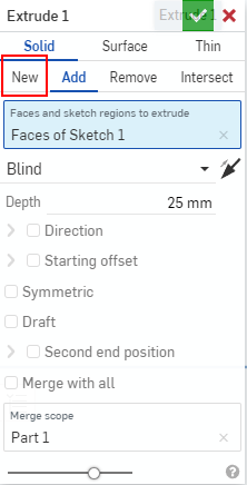

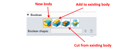

) to know what the setting is called, but there's usually an option not to merge when you do the extrude.
