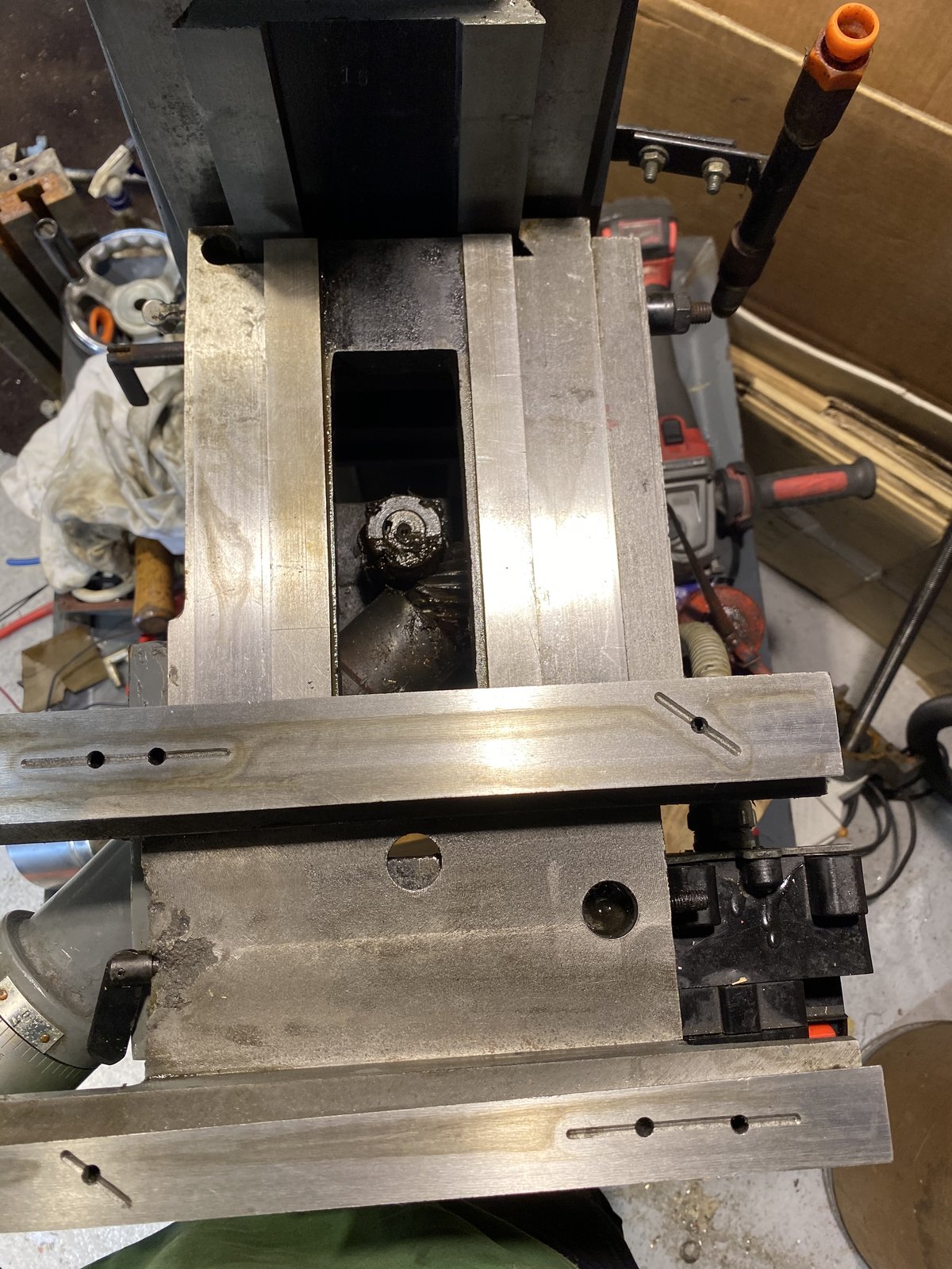

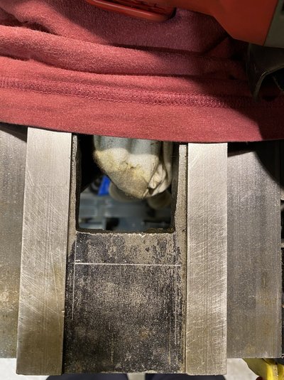

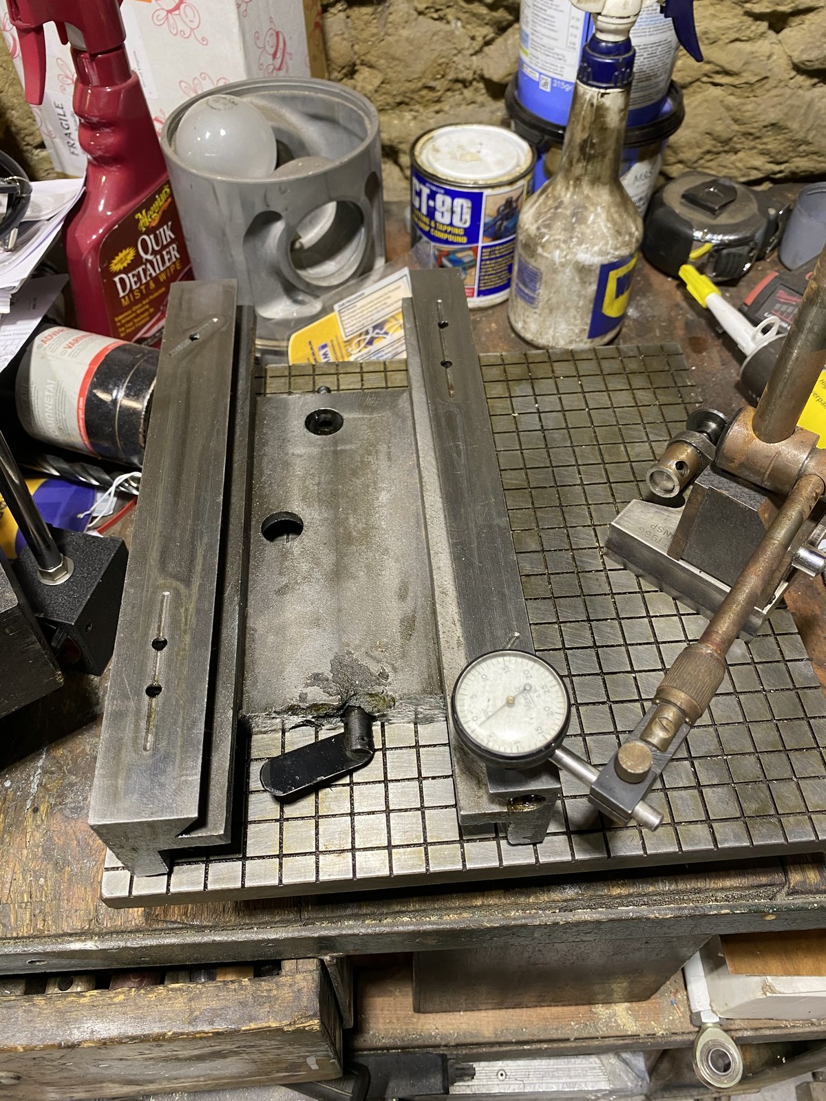

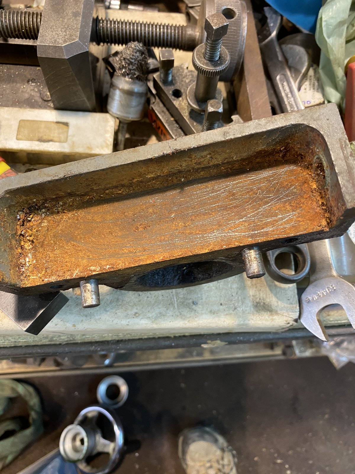

This is the state of the underside of the Y axis slide
Not sure if I should try to do anything about this when it’s this far apart. I’ve never done hand scraping before so wouldn’t want to learn on this really, not do I have the time to learn, get scrapers, do it etc
Do I not worry about it as I’m never going to be producing super accurate parts on it
Or do I get a machine shop to surface grind it and just get it parallel to the X axis face?
