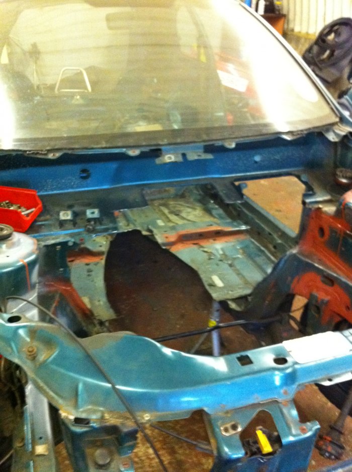

Tiny update, i made a start on modding the shell for when i make a roll over spit.
I made these and welded them into the front panel, have to remove the rear bumper now no i can tackle the back end. I know its only a small update but i was happy with the result.
Maybe because its the first thing i have done thats not been stripping off the car

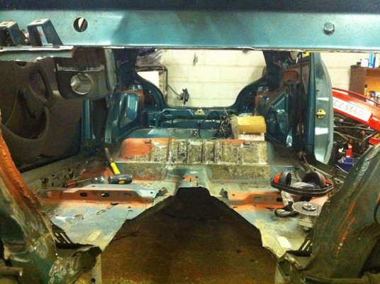

No problem Stuvy, im keeping everything in a folder and have finished measuring up all bits for the spit. I wish there was more progress but unfortunatly im a good big brother and have been doing more work on my little brothers RS...Again!

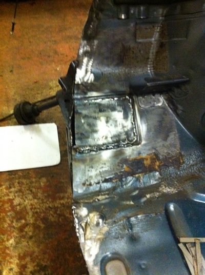

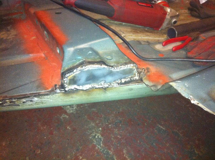

Had an hour on the car last night, thought i would make a start on patching up the centre brace.

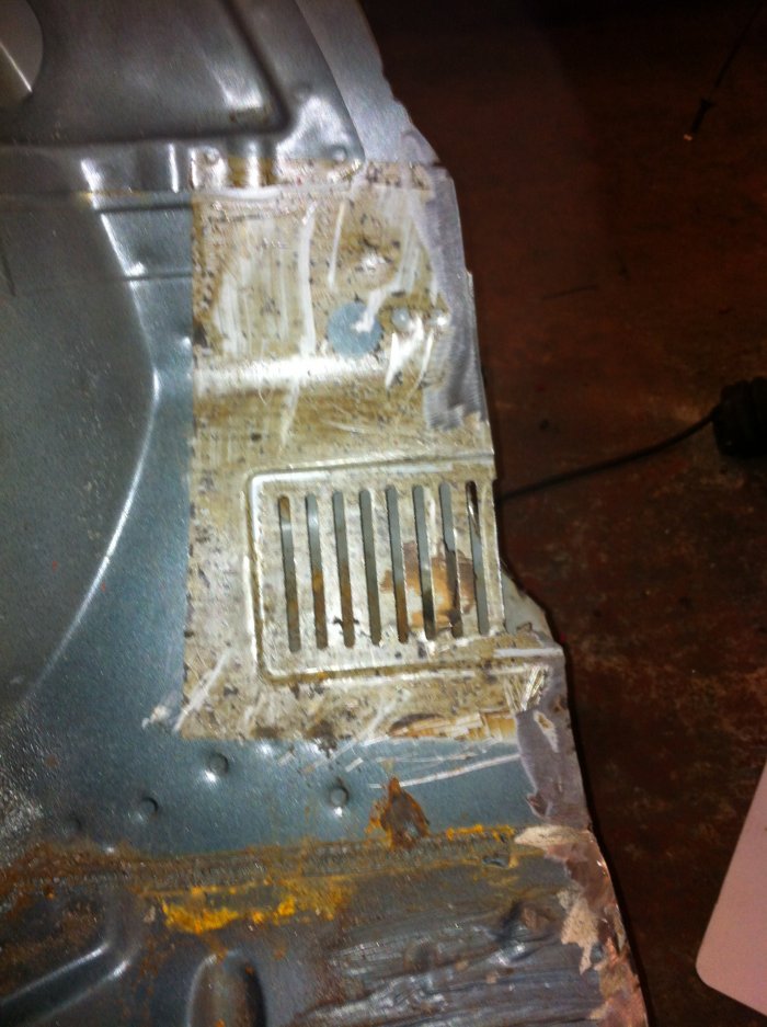

When the tunnel goes in these areas will be covered over so this is just to add to the strength. The plan is to get it finished to a high to a standard so it looks almost factory.
need some flap wheels as all i have are cutting discs.
