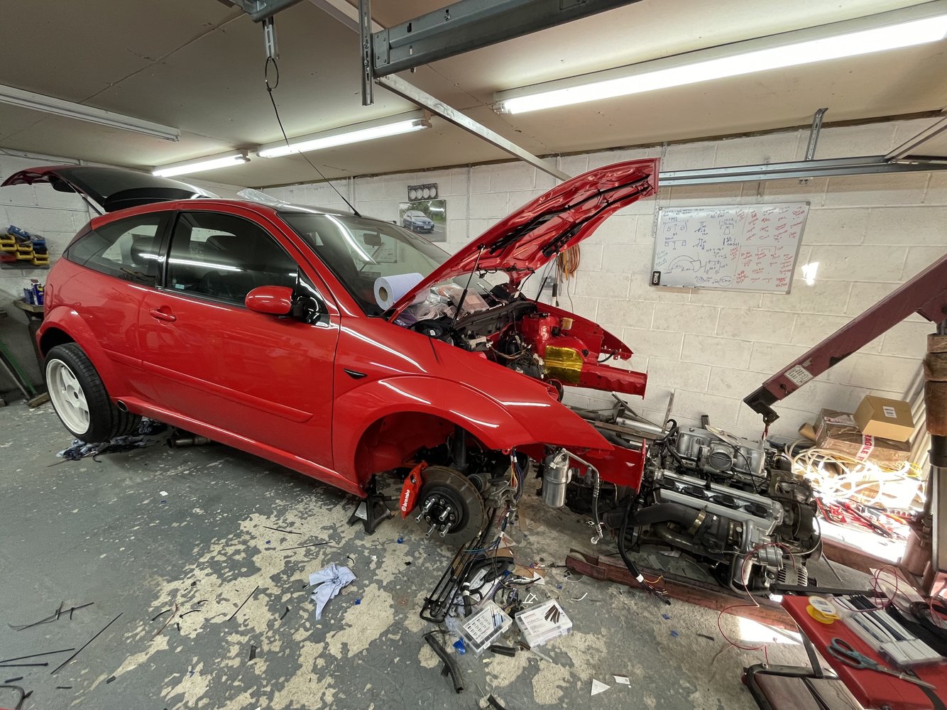

I was not thinking...you have turbo,d an NA motor then? Are you still running from the OEM ECU that still thinks its a none turbo so has no additional fueling/timing map built in. The dett sensor or knock sensor will be having the time of its life trying to cope with that lot then and be just giving up and throwing it into limp. As you say it needs an Emerald system or similar.
