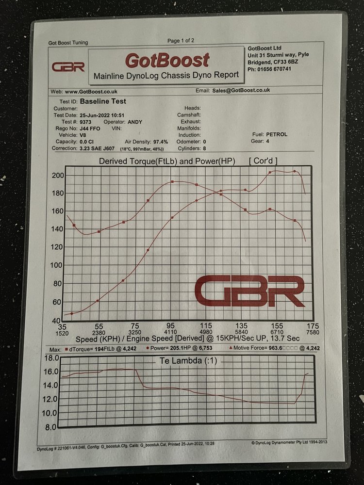

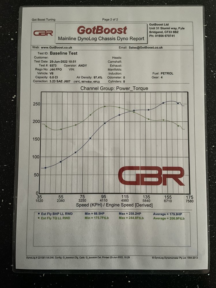

I think we have too much air, engine starts knocking, ecu dumps fuel and subsequently dumps timing causing huge power loss
did the dyno guy have a AFR reading during runs
