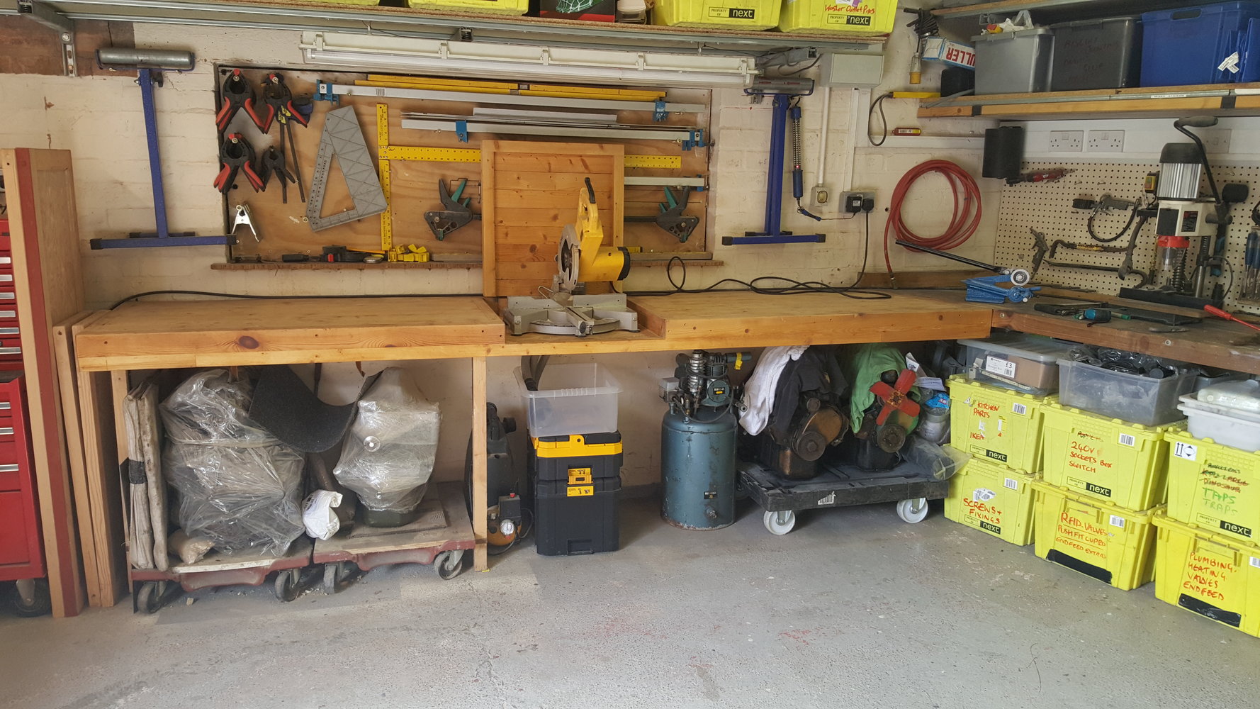

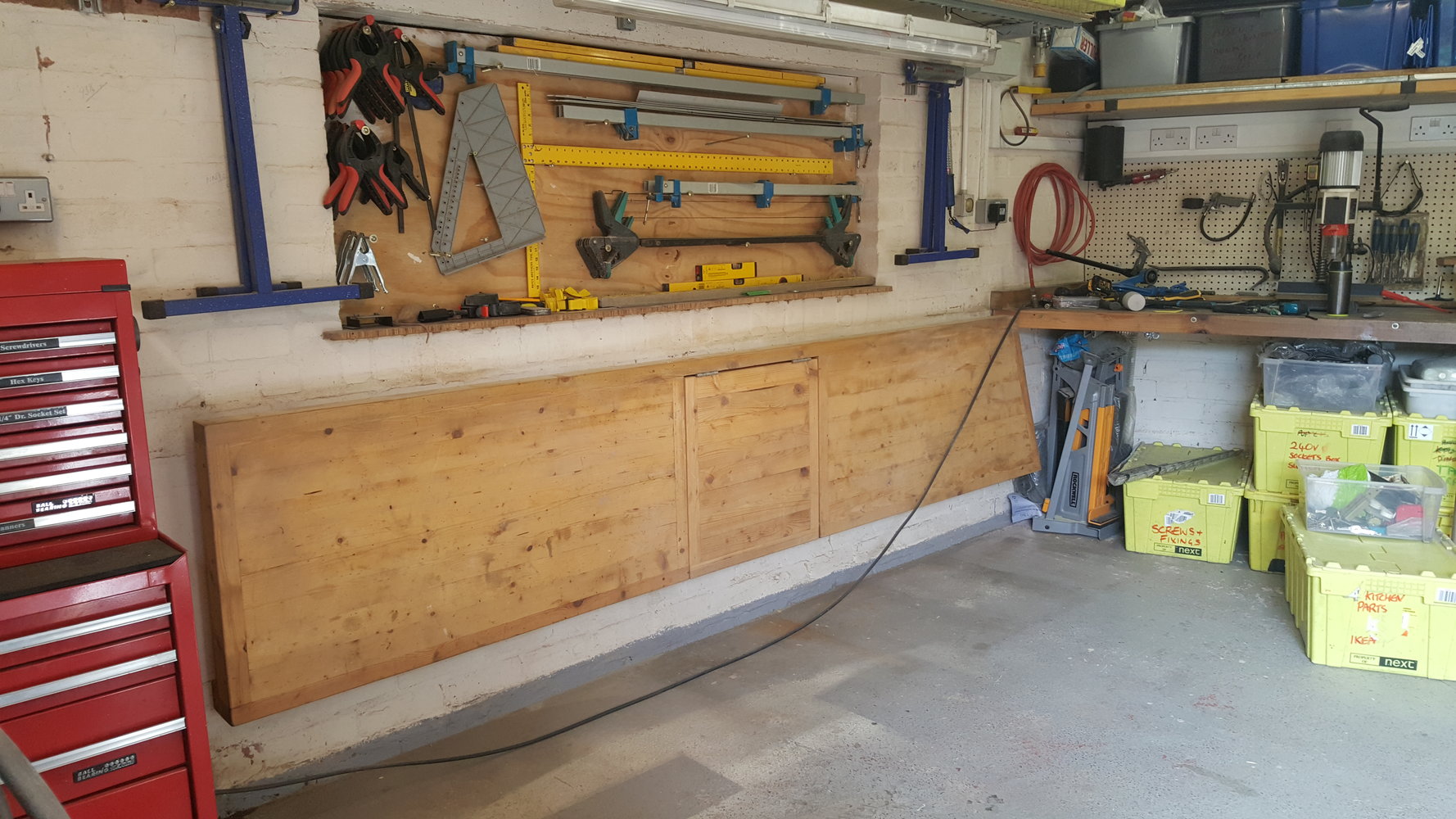

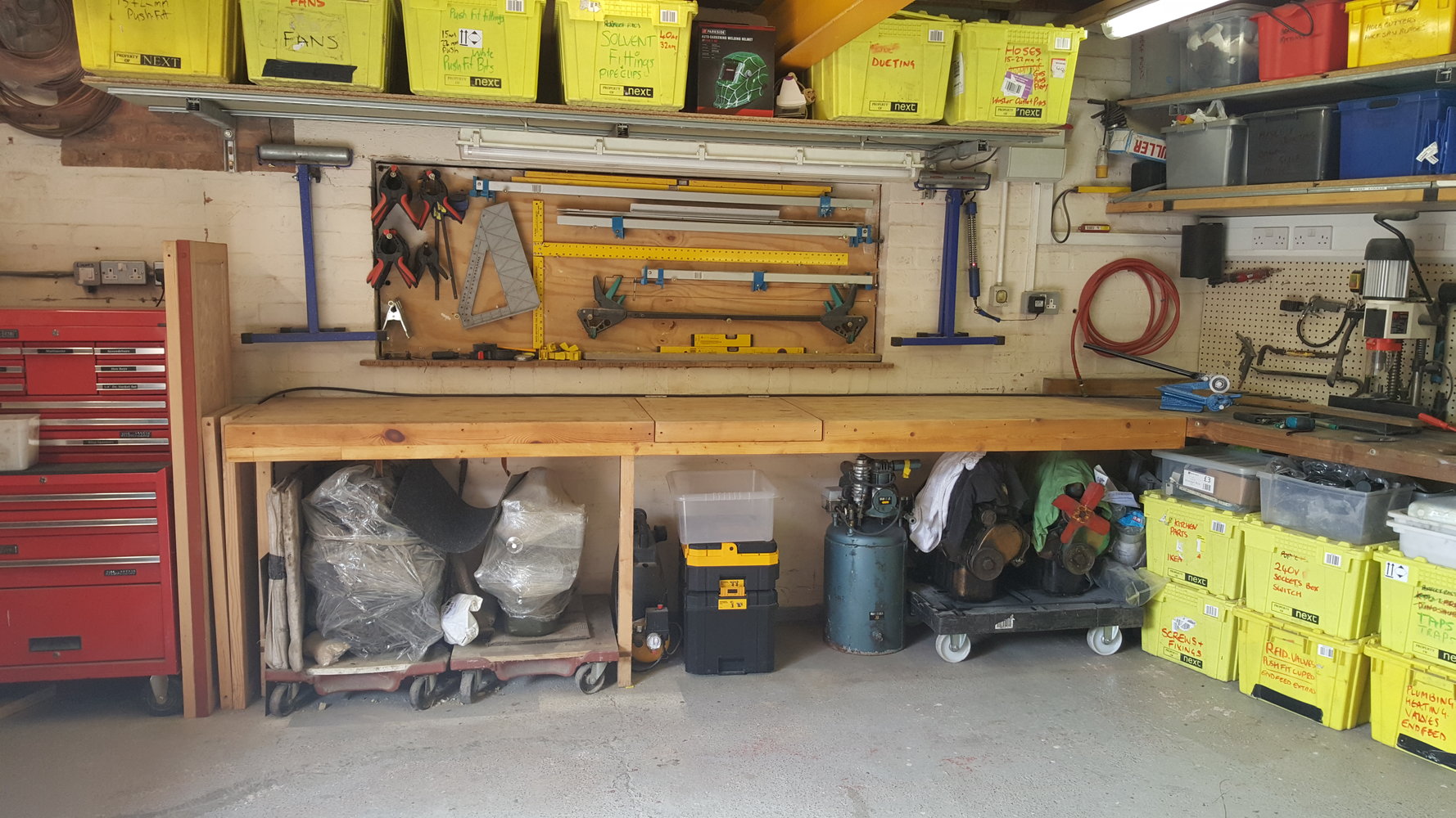

nice job i like that idea. this may be my job for the weekend been so busy this week. I have materials left over from the shed build so I will use them up even though they may be a bit overkill!I did this out of 3" x 2" square edge timber and bolted a length of 3 x 2 on the wall then a few heavy duty hinges to make it lift it up and down, the legs are just on gate hinges with some velcro glued on to allow them to stay in place when in storage mode, The cut out for the chop saw was made to keep the saw bed and surface at the same levels. Just to note it have never been that tidy since it was installed View attachment 323603View attachment 323604View attachment 323605
plan is to use 100x100 legs and frame the edges with the 100x100 also and have the legs set 100mm back from the frame so the frame stops the legs foling down past verticle. I did think about making some metal ones but I have loads of hinges here alreadyCan't you just make up some hinges with stops so that they only fold 90deg?
Then you could have it folded up when not in use but would be able to unhook it and drop it down to use. No faffing about pulling legs out.
