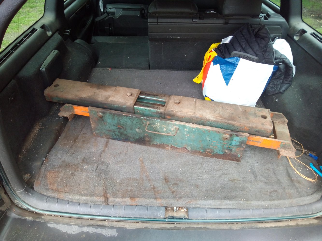

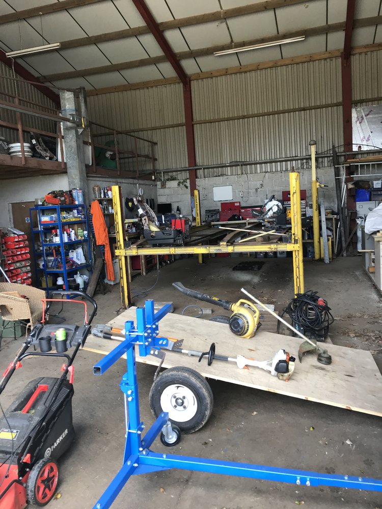

According to the law of sod it will be x+100mm where x is the length of the beam thingyCan anyone tell me the gap between the ramps on a Fog 3 ton 4 post lift?
Been offered a transverse jacking beam thingy.
Please.
Yep, it's extendable, max length 1m14.3, (45 inches).Most of the beams can be extended a certain amount I think. Mine doesnt have one, it has wheels free beams instead - great for the land rovers. Too proud of the ramps for modern cars.
The other thing to be aware of is the arms will be for a specific format. Some lift have uplifts on the sides of the platform, thats what mine has and it looks like the one you are buying has so the beam needs to hook over those edges. Some have flat platforms, some have a channel below the platform. All of these things affect the way the arms are built.Yep, it's extendable, max length 1m14.3, (45 inches).
Minimum, 75cms, (29.5 inches).

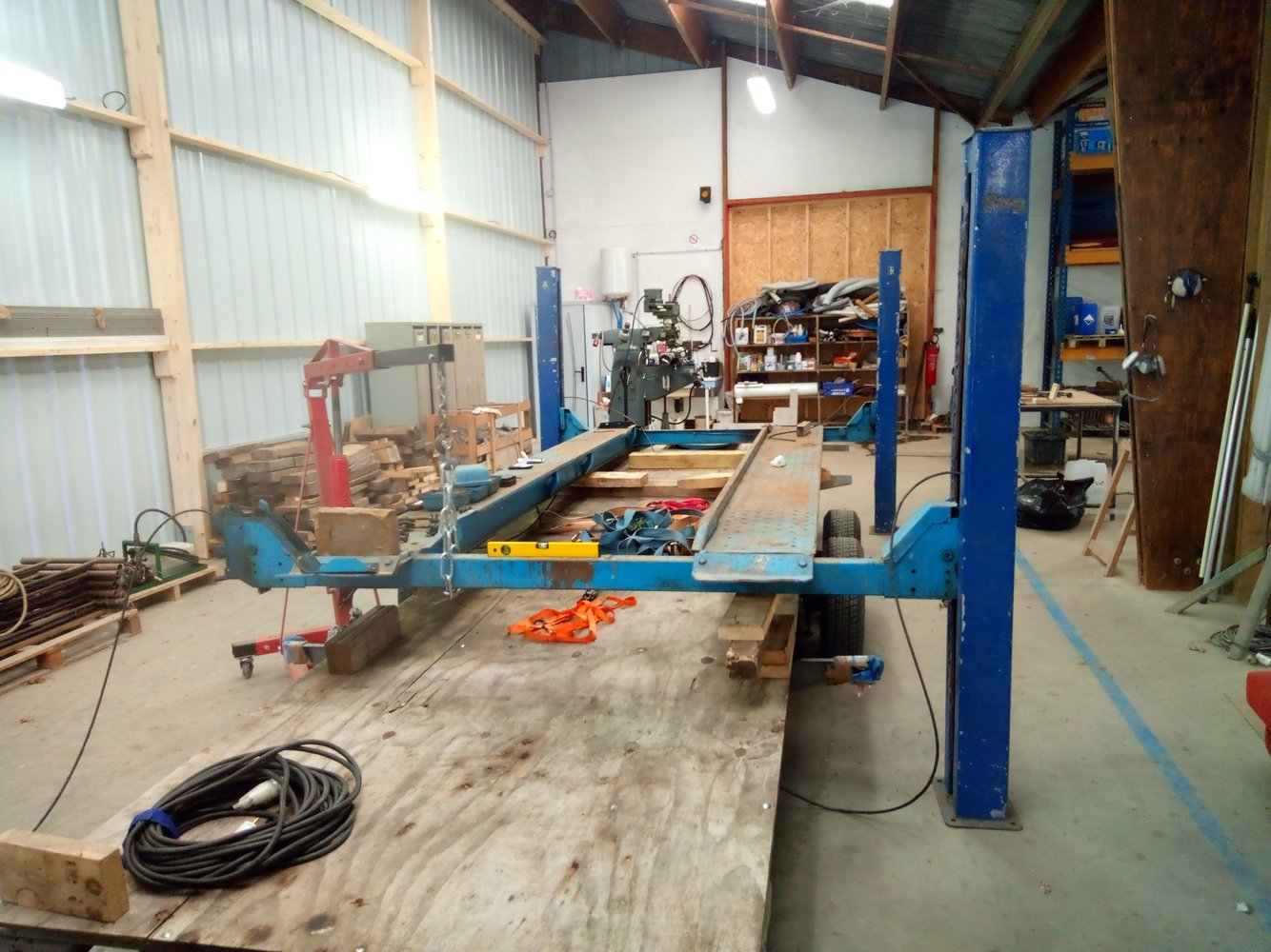

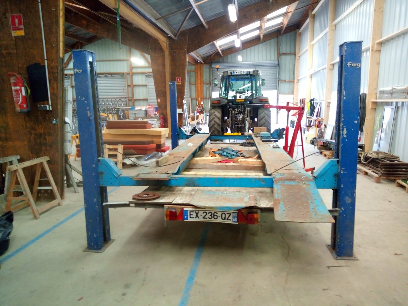

If it doesn't fit, I'll make it fit.
No, it doesnt, it's being assembled at work.I don't remember your workshop looking like that.
