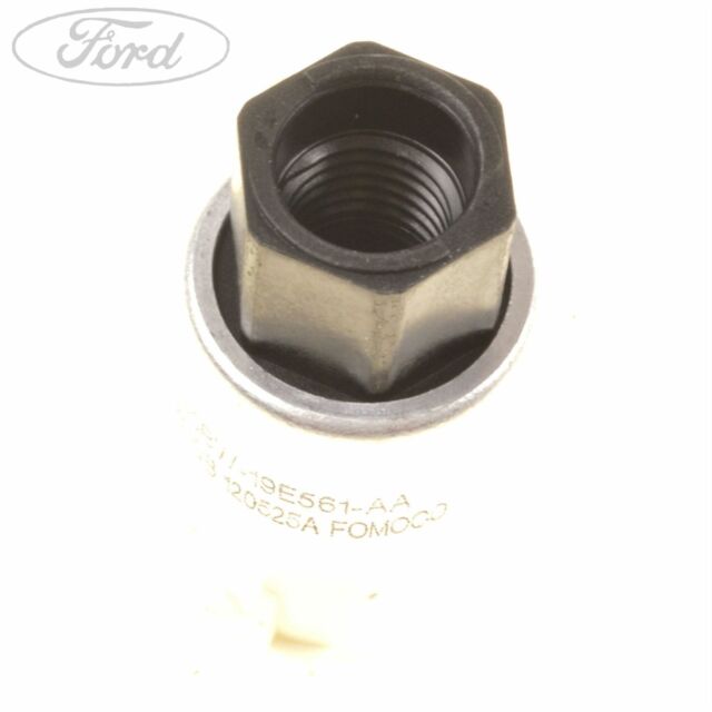

claim that the switch had a schrader valve and none would be lost , i was in the waiting room when they changed it ,nothing hissed out , wether that was a schrader valve or maybe the gas was already gone i dont knowI'm intrigued now, are they saying they changed the switch without having to recover the refrigerant? because that's how it reads... If so, they really shouldn't be working on HVAC systems as they're clearly not competent, and probably don't have the required FGas certification for refrigerant handling, let alone any diagnostic skills.
ordering a genuine part and o ring ,havent charged me yet and confirmed i wont be expected to pay for the other oneSo.. you were there - they found a problem their faulty part had caused - what are they going to do about it?
The only picture I can quickly find of the switch port is hereclaim that the switch had a schrader valve and none would be lost , i was in the waiting room when they changed it ,nothing hissed out , wether that was a schrader valve or maybe the gas was already gone i dont know

https://www.autodoc.co.uk/topran/15298461 can view it there if you click 360degThe only picture I can quickly find of the switch port is here

how that would open a Schrader valve, I don't know...

got the pipe off..yes it does have a valve , same tool as a tyre valveThe only picture I can quickly find of the switch port is here
