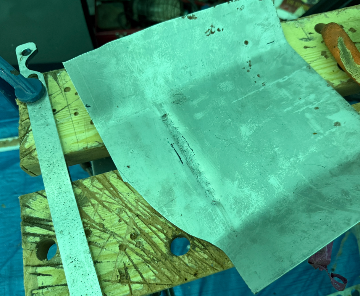

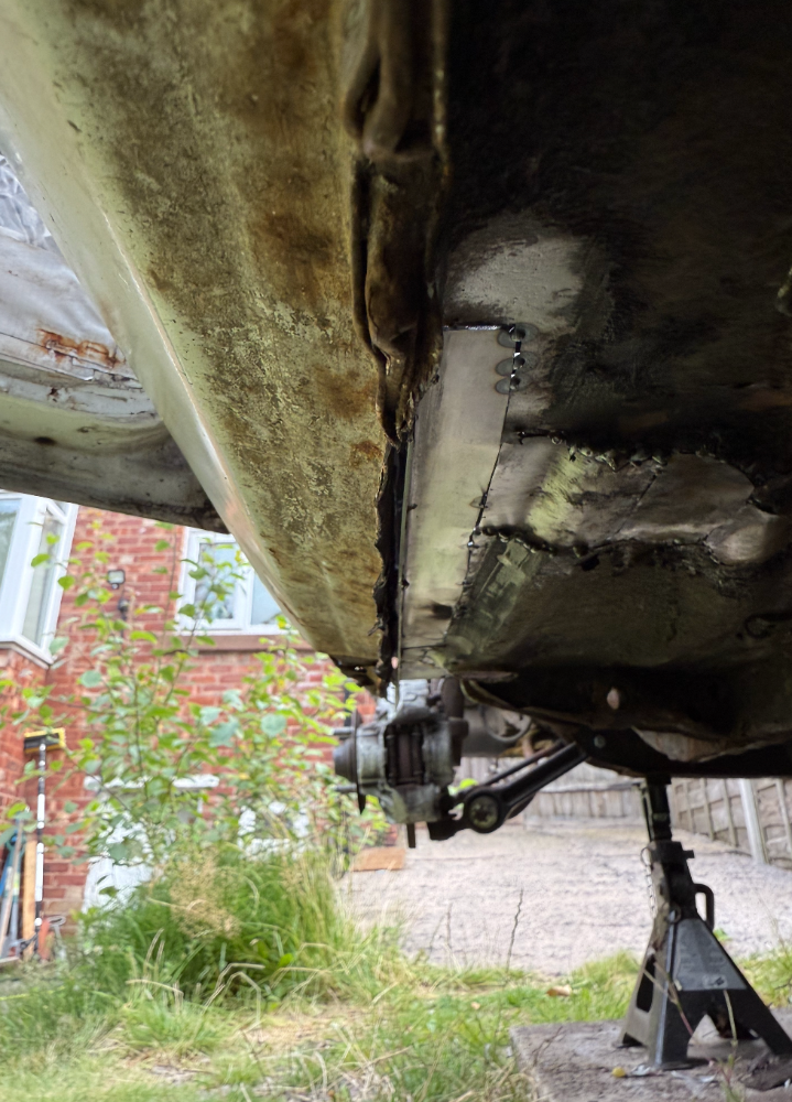

I was hoping to have a tacked in panel to show you today but with the intense heat there were a few hours I couldnt be outside in overhauls.

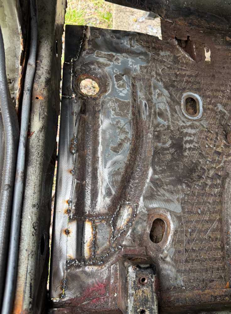

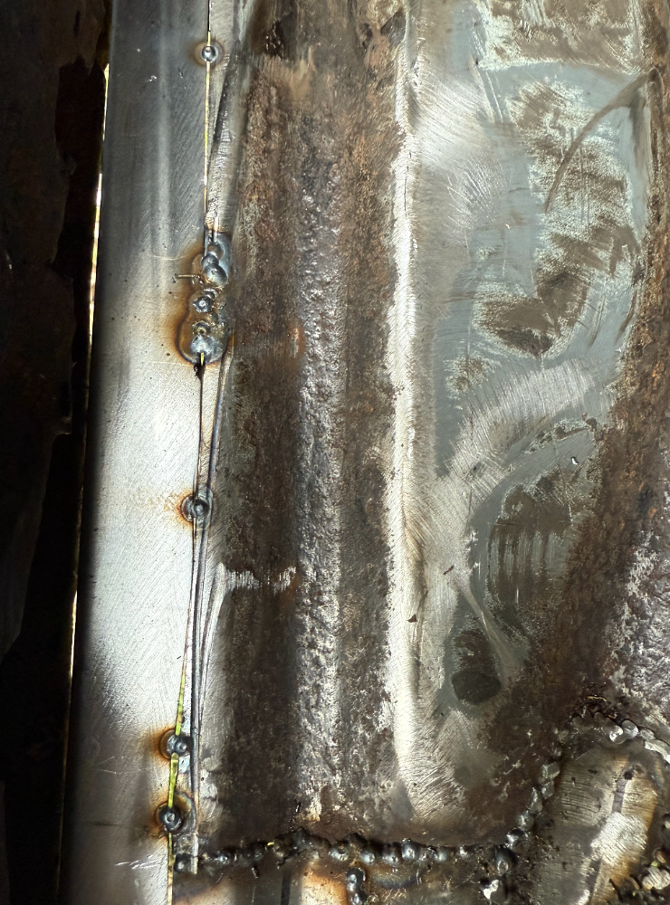

What I did try and do was work on the Toe Board. I started off by making a template of the entire area In case I needed to take more out of it that I first thought. I then cut out the first rotted away indentation then used it to mark then hammer a slightly shallower indentation that the origional. I'm not precious about this just thought I should add something.

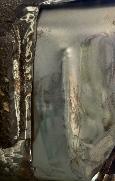

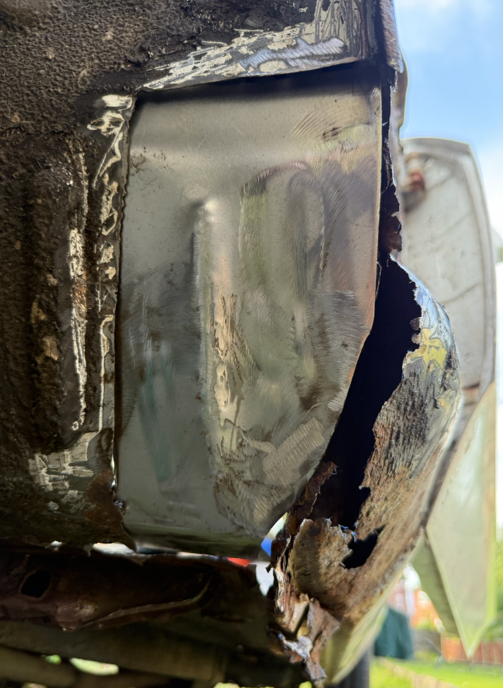

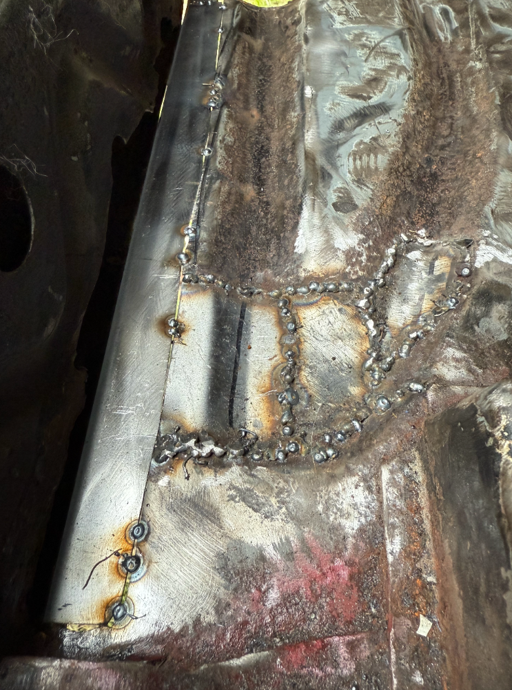

After this I trimmed down the Toe Baord on the car to remove the first indentation and leave me with a kind of L shape section. This has taken me a while but the main section fits with a slight gap (although not for these photos annoyingly) . Also yeah I now see the indentation looks crap compared to the others but it'll have carpet over it.

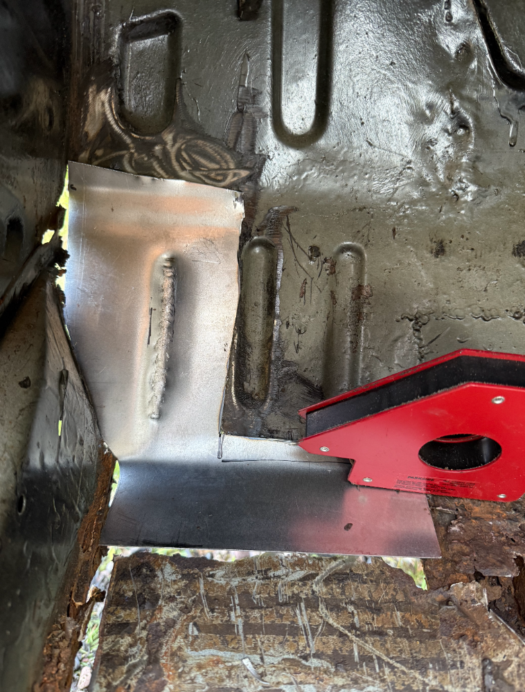

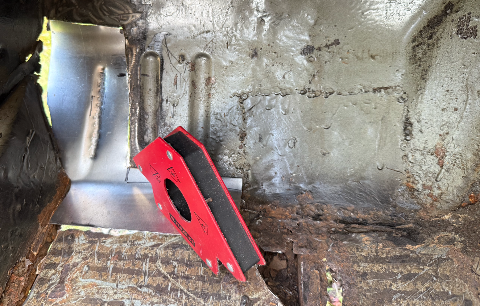

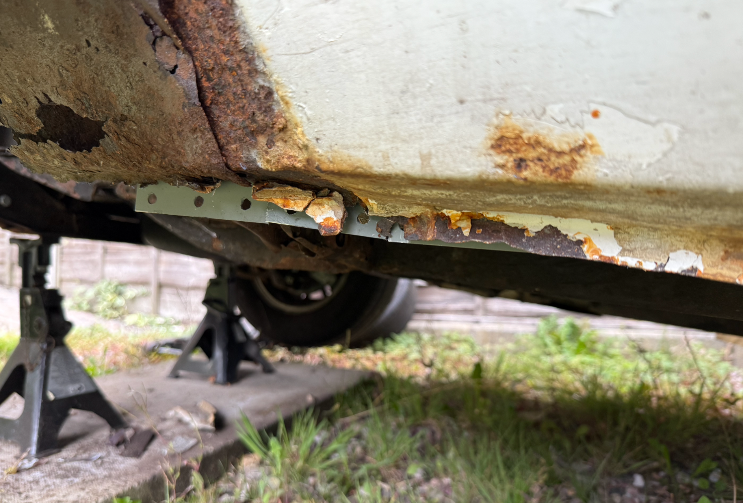

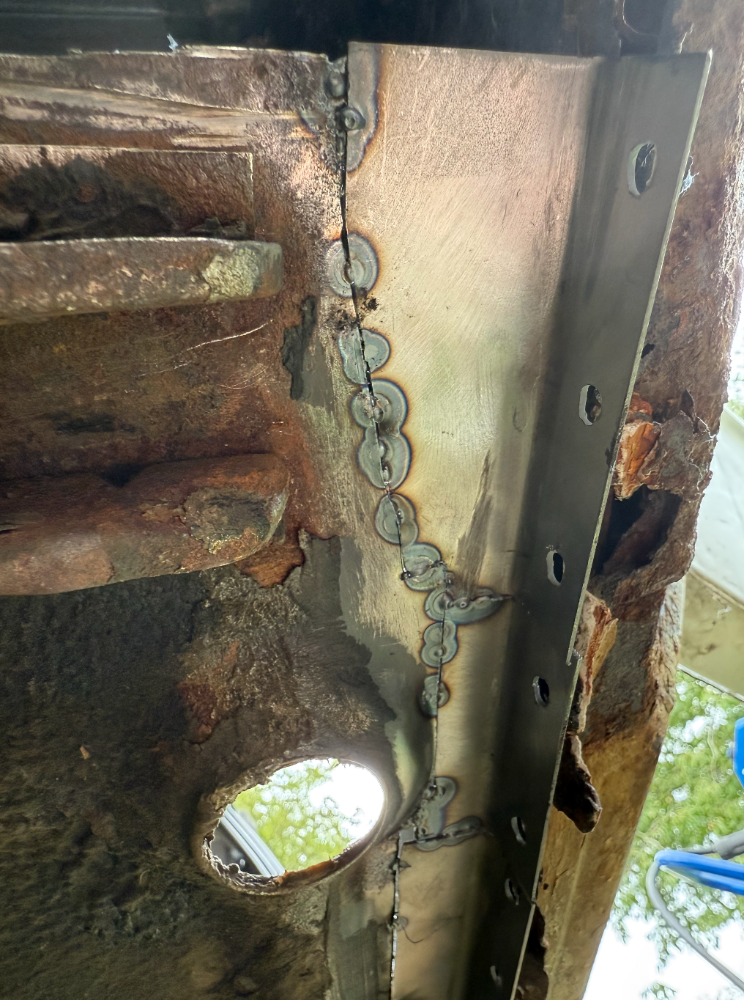

The part that has stopped me really is where to cut it off at the bottom. As you can see in the magnet photo I've drew a line and cut above it in case I wanted to take out more.

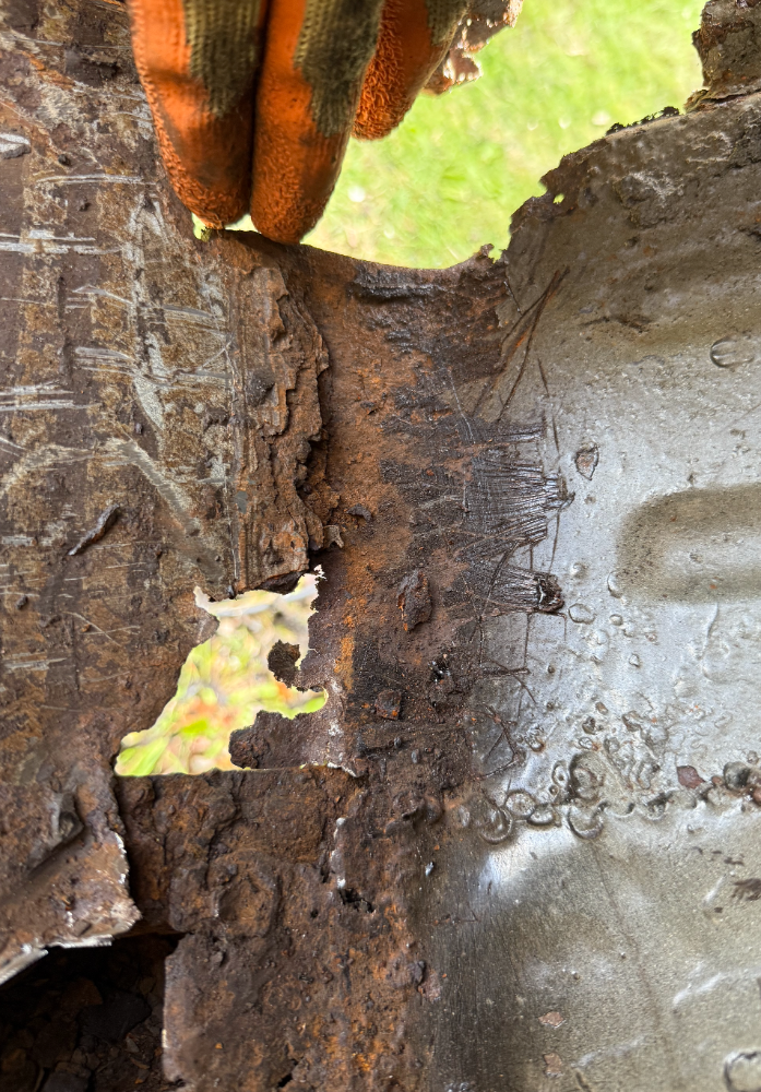

This section Is pretty grotty and I dont know if I should even cut what I've made down further then cut more of the floor out and join in a bigger sheet? The floor seemed to overlap the Toe board so I was hoping to replicate that like in Wim's post on the Capri Power forum. Any advice as always welcome. Hoping to get something stuck in tomorrow.

. It looks as if you haven't removed the remains of the old piece from the sill/A-pillar, which might be the cause.
Once I know the Sills fit I'll tack it in fully.
