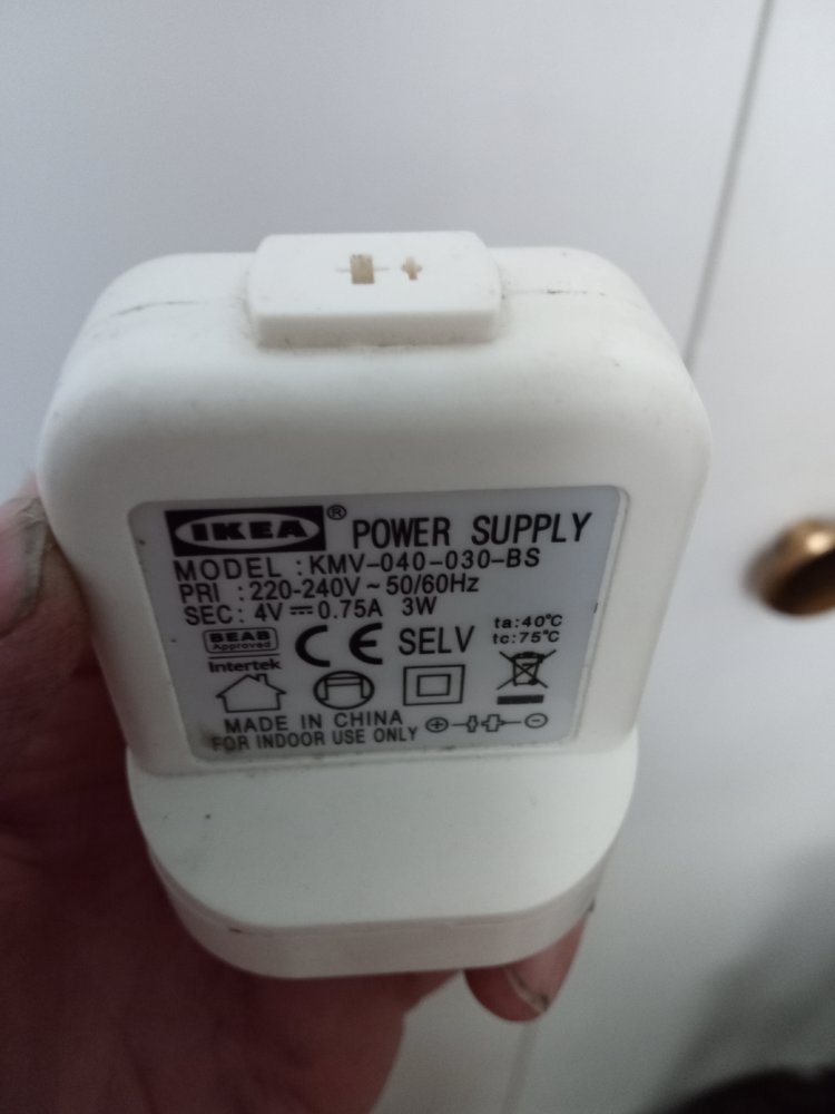

Thanks Skot, a job for Monday nightDo you have a multimeter with a diode setting? Just put it across the connector and it should read open in one direction and a forward voltage (0.6v normally) in the other. When it's reading forward voltage then the +ve lead on your meter is +ve from the power supply.
(if I didn't have a multimeter I'd just try it with a 3v supply - two batteries in series - if it's the wrong polarity it's extremely unlikely to blow the LEDs)

The small pin seems to be the positive on this one.....

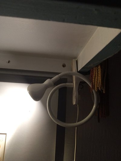

that is very much exactly the power supply I’ve lost. It’s for an IKEA led lamp of a flexible gooseneck thing
How much?![]()
KWONG MING 4v POWER SUPPLY TRANSFORMER AC ADAPTOR KMV-040-030-BS-1 2-PIN fitting | eBay
KWONG MING ELECTRONICS. 4v / 0.75A / 3W. UK PLUG POWER ADAPTER. 2-PIN CONNECTION, FOR INDOOR USE ONLY! WAS OFF A IKEA LIGHT, USED WITH FAIRY LIGHTS & LED LIGHT DISPLAYS. REF: KMV-040-030-BS-1.www.ebay.co.uk

That is exactly the light. If its spare im happy to part with some beer tokens in exchangeOne of these perchance?? They're at least 10yr old and used a lot but that plug is actually spare if you'd like it?!?! I understand your samosas are quite delicious
