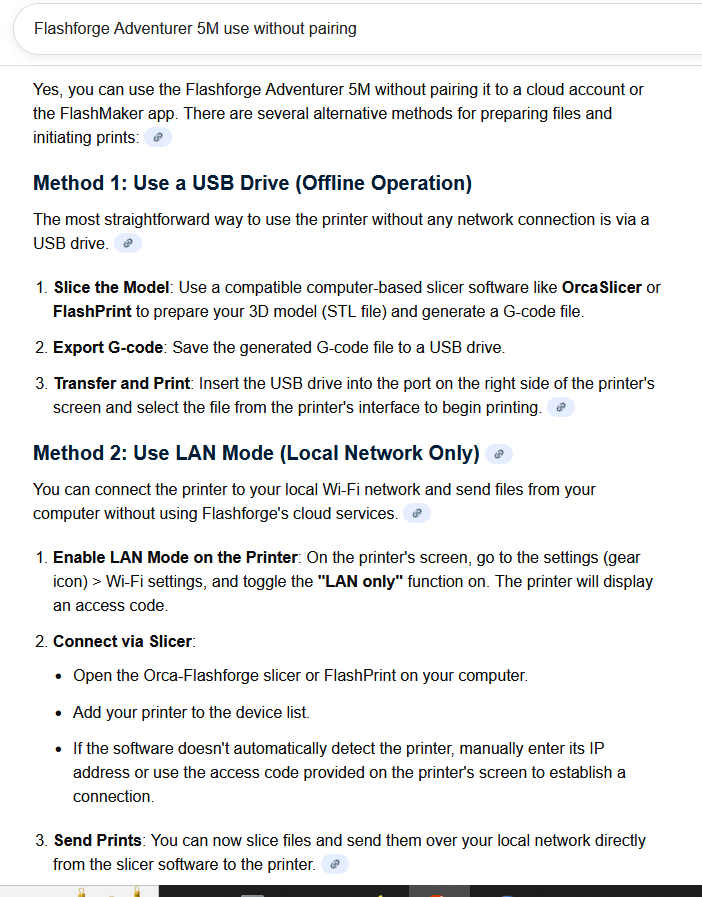

Connected one of these to my WiFi.
But, to print from the slicer you need to install an app to a phone and 'pair' the printer with a qr code.
Is there a way around that?
Or if not, can anyone confirm, if I go to the hassle of installing the app, can I then send files from a laptop, over wifi, and save them onto the internal memory of the printer for printing later.
Ie, slice and send a few items at a time rather than slice, start it printing, have to repeat later?
