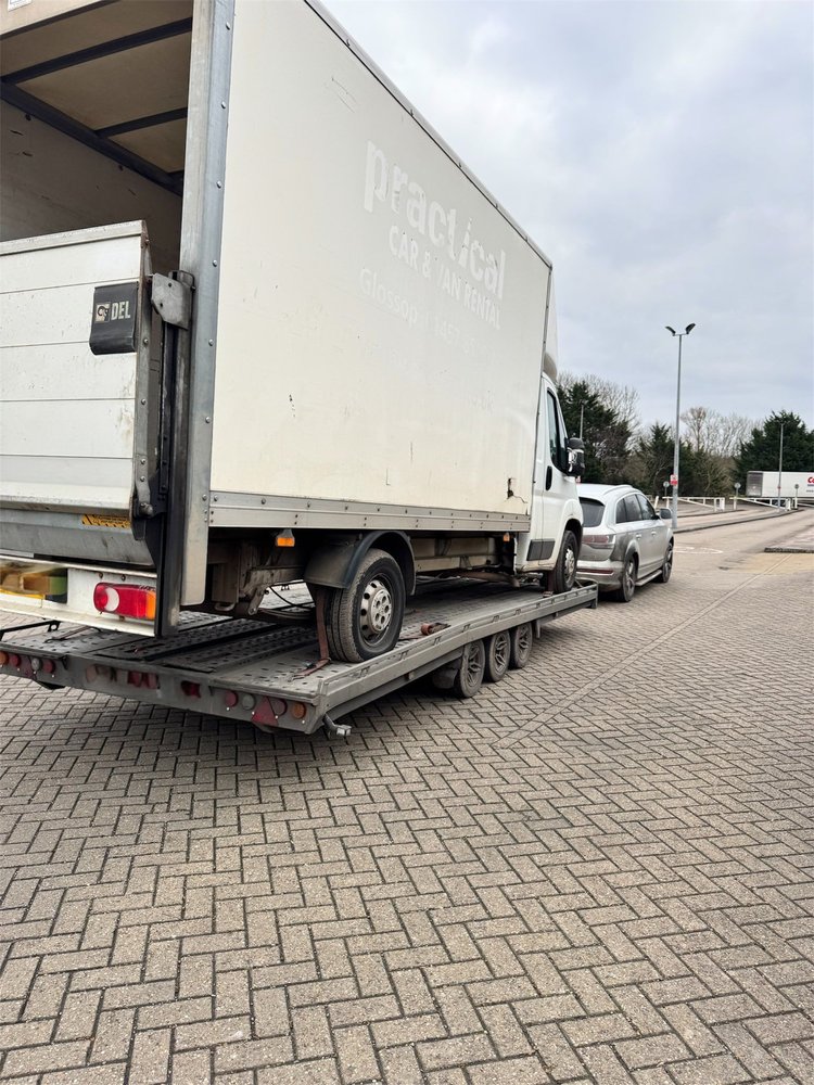

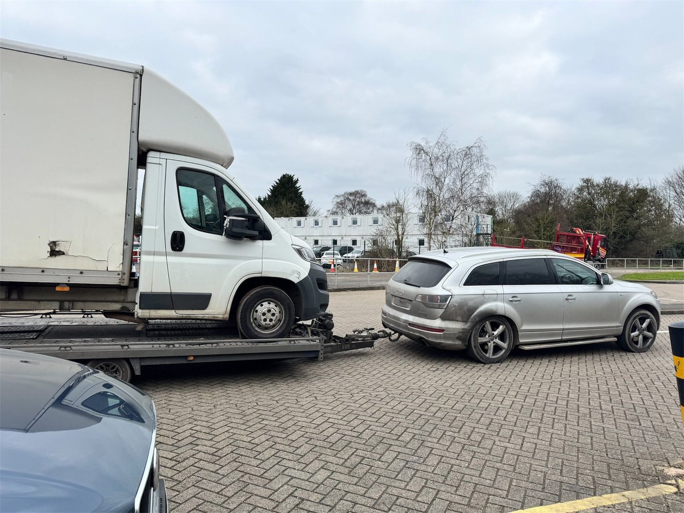

Straps over the wheels look slack.I wonder what his insurers would have to say about this if it was involved in an RTC!
Pulled over on the M1, apparently the car was already subject to a prohibition notice for having no tacho.
3.5 ton with a max nose weight of 140kgsNot Saying its right, but if that's a Q7, cant they tow 3000 or 3500kgs?
That's how most cars/vans get strapped in transport here, even on car transporter trucks.Straps over the wheels look slack.
I use transport chain on hard points, axles, tow hitch, front a-arms, etc.
Most manufacturers now stipulate it, and DVSA require four straps per vehicle if the last (or only) one on the back of a truckThat's how most cars/vans get strapped in transport here, even on car transporter trucks.
Its the proper way to secure a vehicle. If you strap to any other part apart from the axles the straps will loosen as the suspension bounces.That's how most cars/vans get strapped in transport here, even on car transporter trucks.

I know but there are another couple ways to secure by the wheels.Its the proper way to secure a vehicle. If you strap to any other part apart from the axles the straps will loosen as the suspension bounces.
