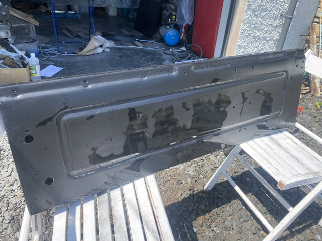

I’m using this https://www.ebay.co.uk/itm/33038285...qJxcZC1QQu&var=&widget_ver=artemis&media=COPY
It my abilities that limit the shine I suspect!

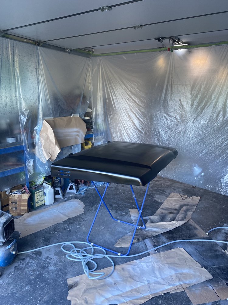

Let it dry, flat with 800 dry, clean and recoat with 50:50 mix. Watch for the 'wet edge', if you don't see one you are moving too fast, your pressure is too high or you are too far from the panel. When you see the wet edge, your next pass will be 50% over that wet edge and so on.
it might be better at this stage to have runs, rather than the dry spray that you have, so put a bit more on. When you get good at it, you can put a weak final coat on which will give you a nice shine from the gun.
