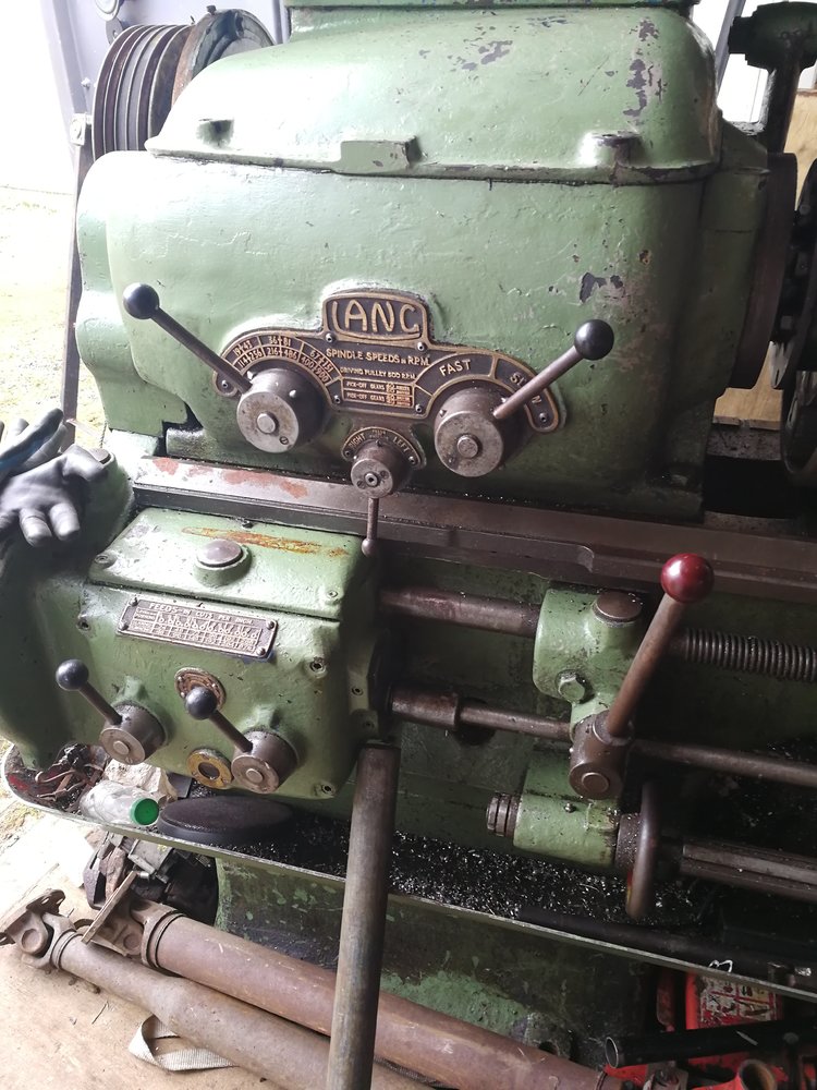

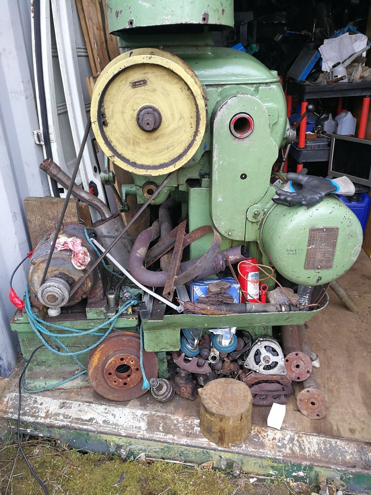

Lathe was bought on a whim and i've done nothing with it until now. It is all learningand nowhere near attempting to power it yet.

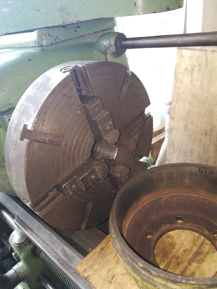

Using the 3 jaw allowed me to confirm the similar results i obtained whilst spinning drum on vehicle axle. Don't think there was any great movement at the inner bore surface whilst doing this, hence suspecting ovality. Mounting in lathe was initially a means to confirm previous findings.
Now want to play with the big toy![]()

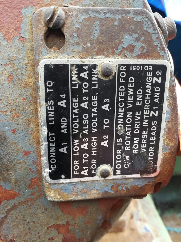

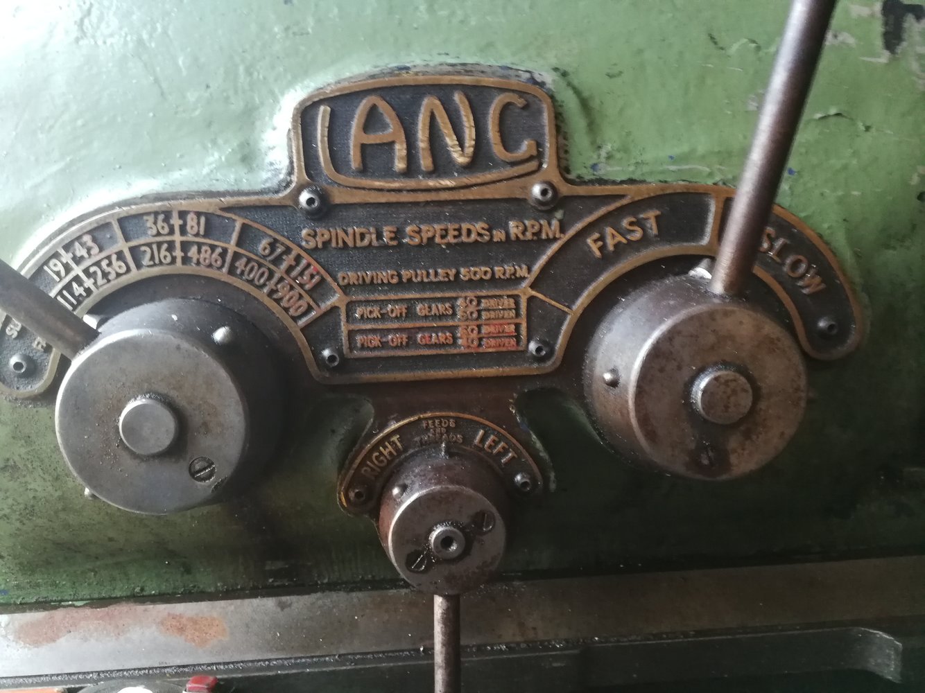

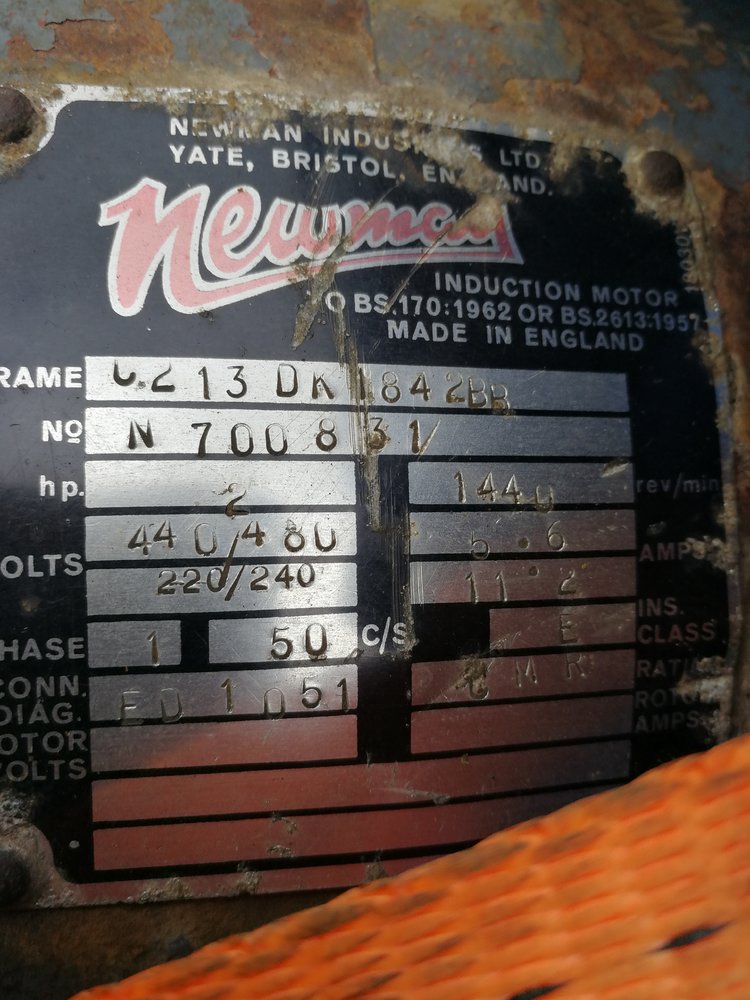

I thought the junior had a 2 speed motor. You might want to check that as it will affect how you power it, unless you have 3 phase.
