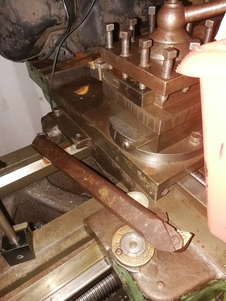

Having said that the boring bar can be used as a short stubby one to eliminate deflection. You will however need a new tip. That one looks shafted.

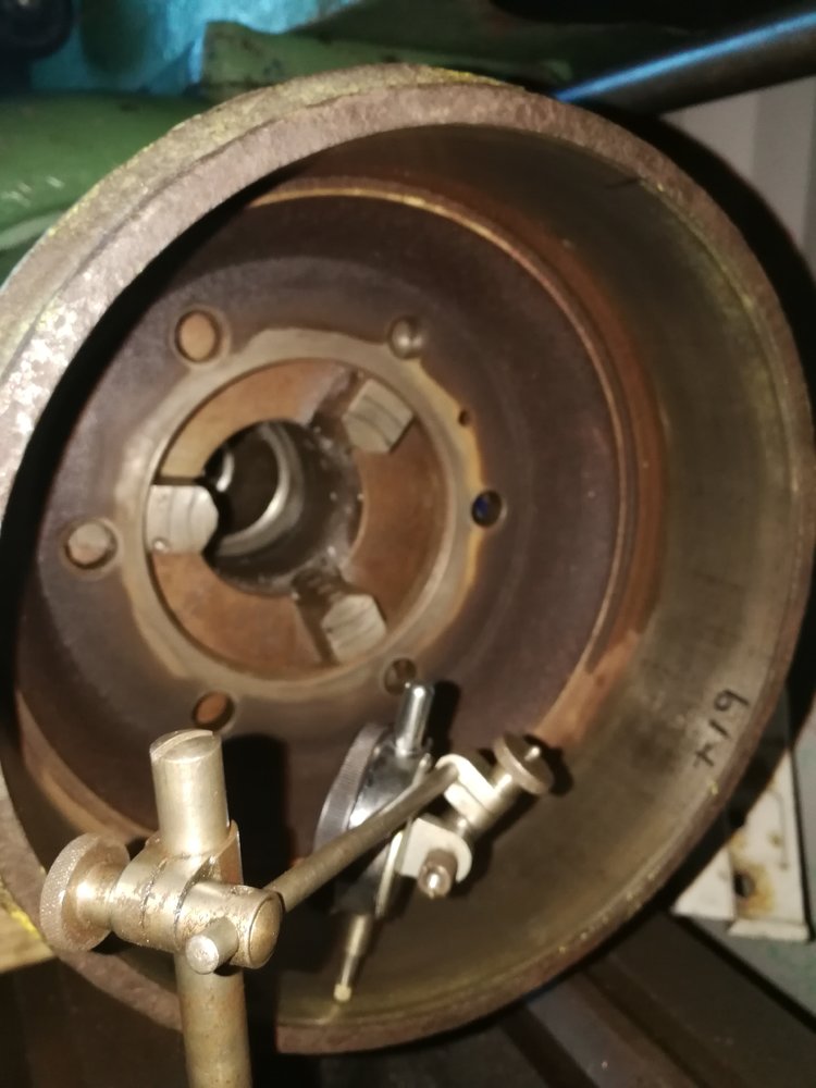

The hardest part will be lining it up in the chuck. I use a 4 jaw and it's hard.
Make a roller tool to press against the front to align the drum. That will get it as good as it gets.
Still have to reattach the motor, only done checking with the DTIgood luck with that one, show us the results when finishedits only in a 3 jaw as well there a few thou out before you start
No idea on the tool tips, boring bar been living in the tray since i got lathe. I take it they are 3 pointed?That tool tip-in your pictures is well shot. Are the other two point the same?
Smaller nose radius on the insert is another way of saying this ^^^A smaller, finishing insert will usually have lower cutting forces, therefore less noise and chatter on big ringing items like this.
Round and concentric to the bearings it runs on.Smaller nose radius on the insert is another way of saying this ^^^
Much less force trying to push tool away, and less vibration.
Larger radius gives smoother cut, but tends to make the part ring.

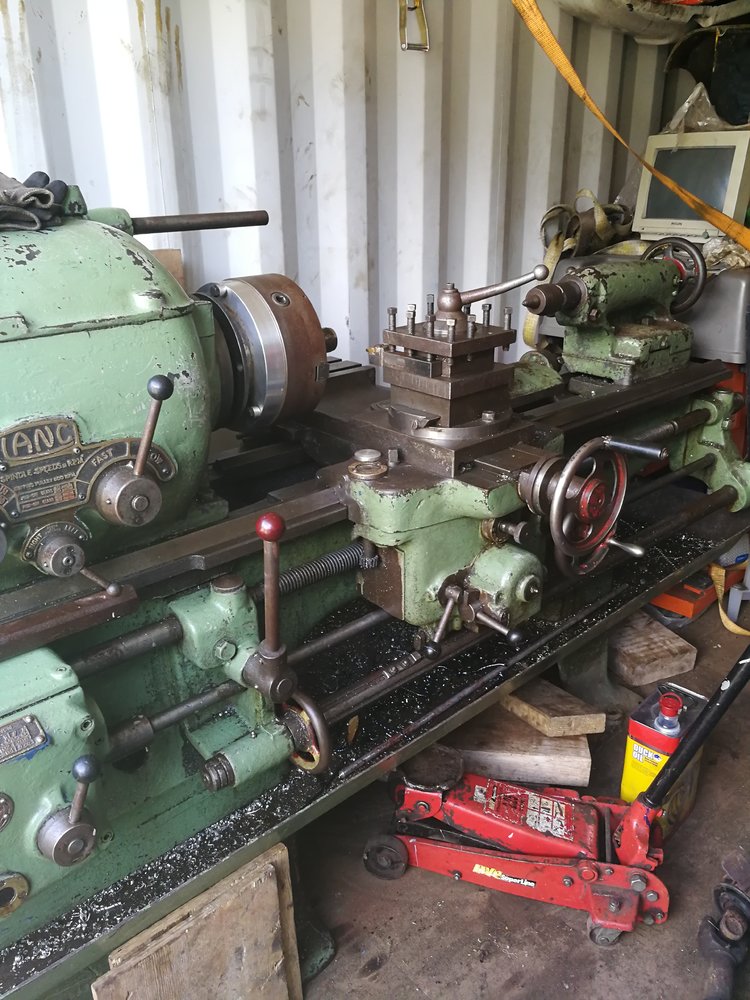

How did you measure to determine 10 thou?Assuming i can get the lathe to work, looking for some advice on what i need and what i need to do.....

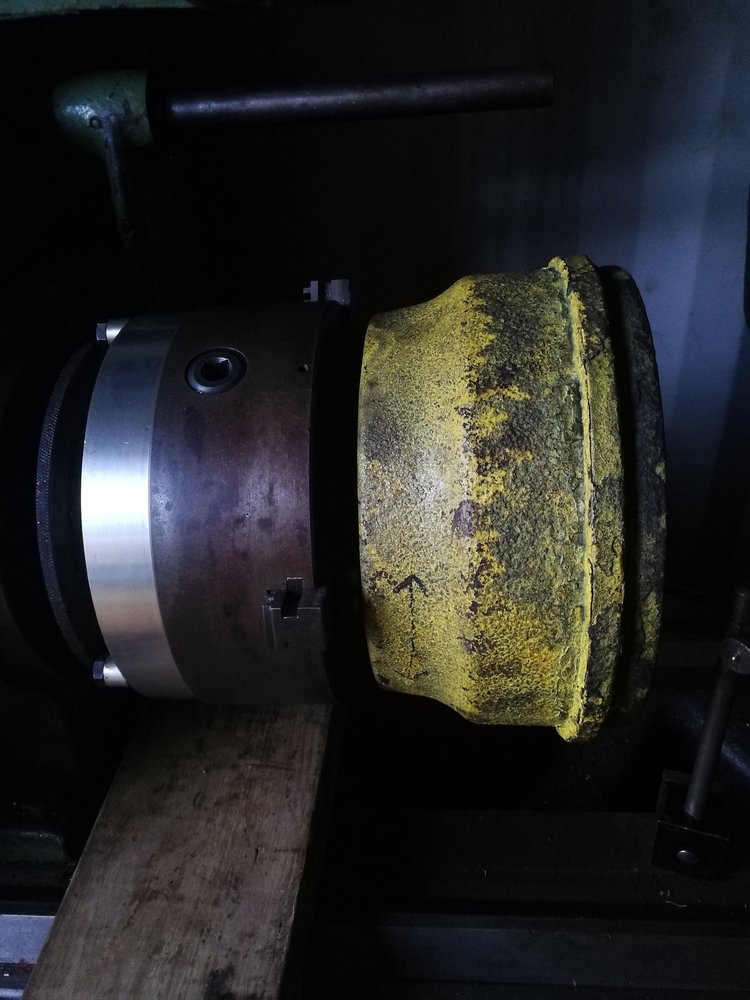

I'm wanting to skim an oval brake drum, about 10thou difference between highest and lowest point.
Some pics below of current state of play and the bits i have.....
TIA

Was the difference between highest and lowest points after initial setup in chuck. They were visually roughly opposite.Round and concentric to the bearings it runs on.
Lathe is a Lang Junior....if it was me I would use a face plate and turn up a piece to fit in the bore of the face plate and a very close fit into the center of the hub mounting on the drum should be dead square then. The closer you are to the spindle bearings doing this the better but TBH unless the lathe is super rigid any sort of hard spot in the cast of the drum it will bounce and not dig in
This sums it up pretty well. Clock a flat surface before you start, bet its out a bit.How easy is it to source a new drum?
By all means have a go if there's an option to easily buy another, but there's a fair chance you'll make it worse than better at your experience level. If it's a one off or rare, I'd find someone that has the facilities and experience to do it first time.
When you say it's oval, are the two low points in your measurement opposite each other or are you measuring run out in your setup on the lathe? It would be ideal in your setup if you could access both the centre bore and the friction face but the jaws are in the way currently (assuming it registers on the centre bore). This would be where a face plate or dummy hub would help.
To answer your question though, you need to get the inner hub face running true, then once the hub face is true, adjust the radial runout to get the drum running true to the spindle based on a feature that aligns it on the vehicle (centre bore probably), then check the face again and then check the bore, iterating until both are true at the same time. You want a short, stiff boring bar and a method to damp the vibration to prevent chatter. An innertube or long spring wrapped round the drum or a plastic hammer sat on the face you're turning all help, as will a face plate as it better constrains the part. Finally, if you're getting chatter, go slow - really slow. You won't get as good a finish, but you need it round. For everything else, there's emery tape.
