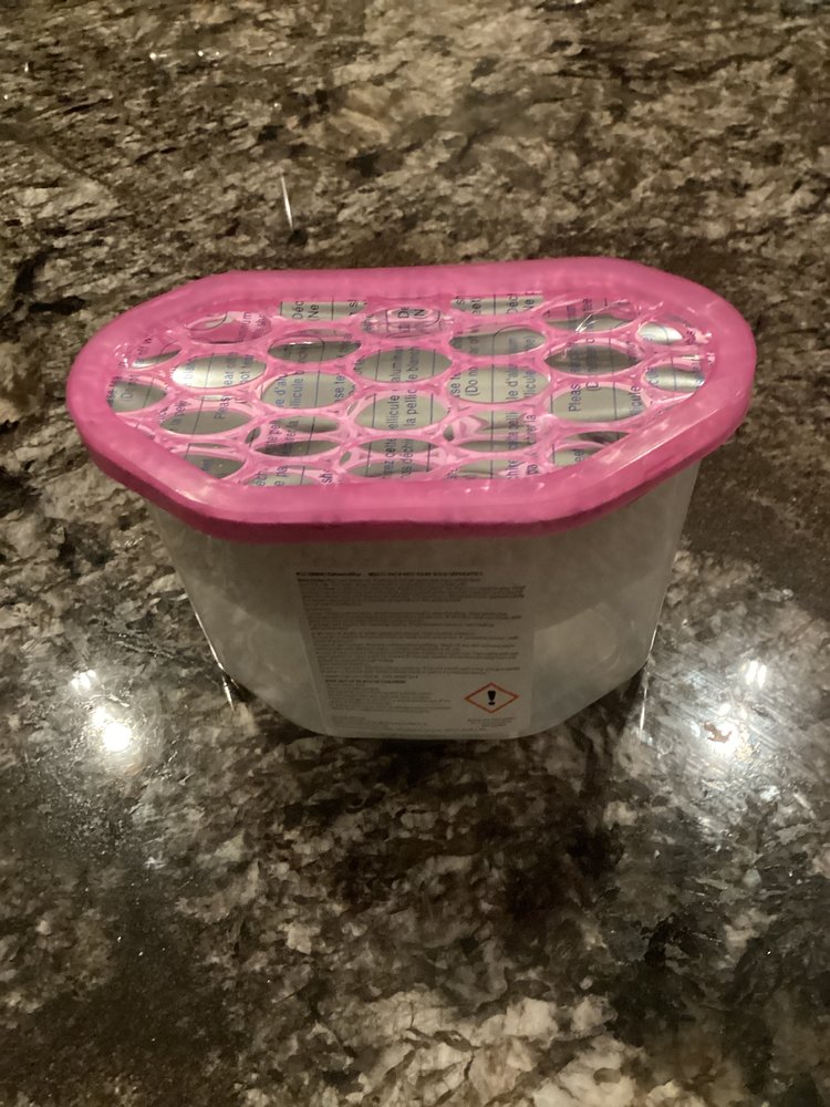

I was paranoid over winter and took my inverter blackline mig into the house incase condensation ******** it up. My workshop is a shipping container so there is a good chance of condensation in it.the oxford I use has lived in a damp barn for a couple of years ,,, when Ive finished i put a squirt of acf on the wire till next time and off it goes ,,,, I dont know if an inverter machine would hack those conditions ,, nope no digital display , but then it wont go wrong either ,,, if your not using it all day every day low tech is grand , it takes a few seconds to tweak a machine your eyes and ears will tell you whats working.
During last winter I wasn’t using mine much, I put a plastic tarp over the welding trolley with a couple of these beside the welder, everything was good and no rust on the wire spool, surprising just how much water these take from the air, they’re only 99p so why not for peace of mind.I was paranoid over winter and took my inverter blackline mig into the house incase condensation ******** it up. My workshop is a shipping container so there is a good chance of condensation in it.
