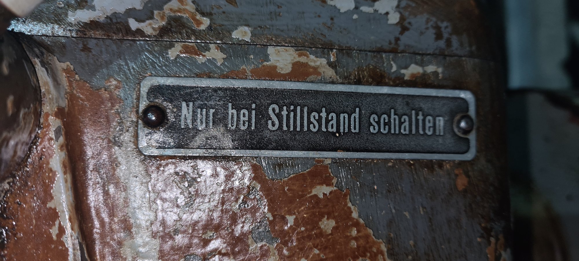

I can't read German, but I can use Google translateso I assume by the gear change chart that there is another influence on the speed other that the gear position i.e. a two speed motor.
What does the plaque to the right of the gear arms say?
There's lots of good info. on pulley size but no-one has yet spoken about the belt(s) that will join the two pulleys.
Does anyone wish to speculate on what belt section might have been current at the time the machine was made? It is no good him buying an A-section motor pulley if the machine has a Z-section pulley on it.
intriebsschiebe 600 oder 1200 u/min
internal slide 600 or 1200 rpm

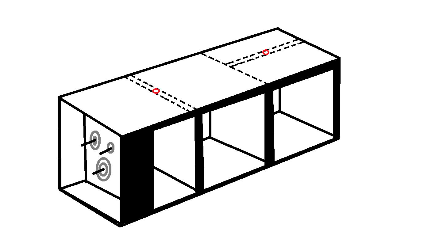

Thought to conider...well here is one of my amazing 3D CAD drawing again.
the cabinet i want to build for the lathe.
4mm steel in 50cmx50cm sheets. the dotted double lines is 50mm x 25mm x6mm channel for the lathe mounting points.
all to to be seam welded. just have to be carefull as dont want to warp it.
not to sure where to put the adjustable feet yet though.
These cheapo or ill make some as i have lengths of 40mm x 5mm round tube. got the bolts M12, just need rubber pads.
or threaded castors even. never thought of that, i have castors on all my other gears aswell ha ha, threaded means they will be same as the adjustable feet for adjustment.Thought to conider...
Pop it on a metal fish tank style 50 x 50 angle iron frame then add heavy duty lockable hard nylon castors in place of feet ..that way you can have it as a moveable piece of gear with storage space underneath . Any leveling up if needed can be done using shims under the lathe or the castors
