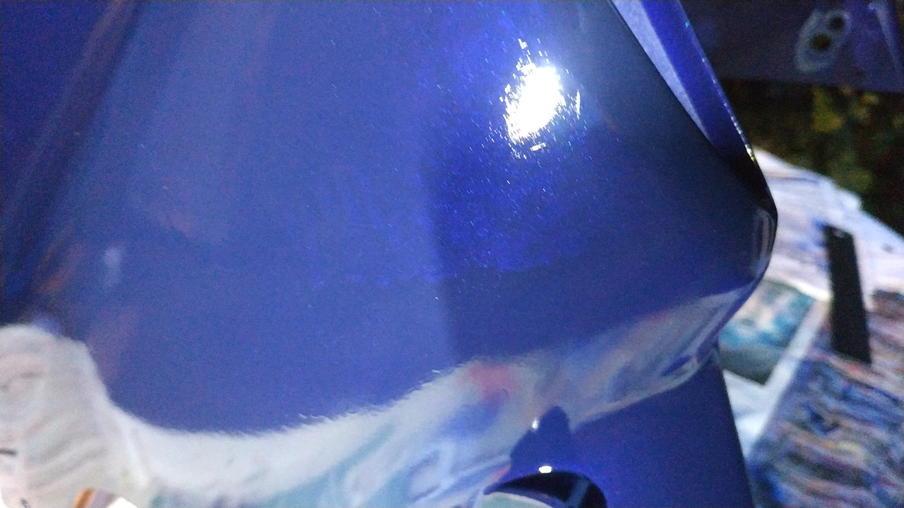

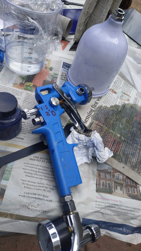

thats more the gun than you none of those patterns look consistent if you can afford it and dependent how much spraying you will be doing for the future get something like a devilbiss flg 5 or similar also your clearcoat dont know what your using but approx 2 to 1 clear and activator and upto 10% thinners
And the pot thread snapped off.

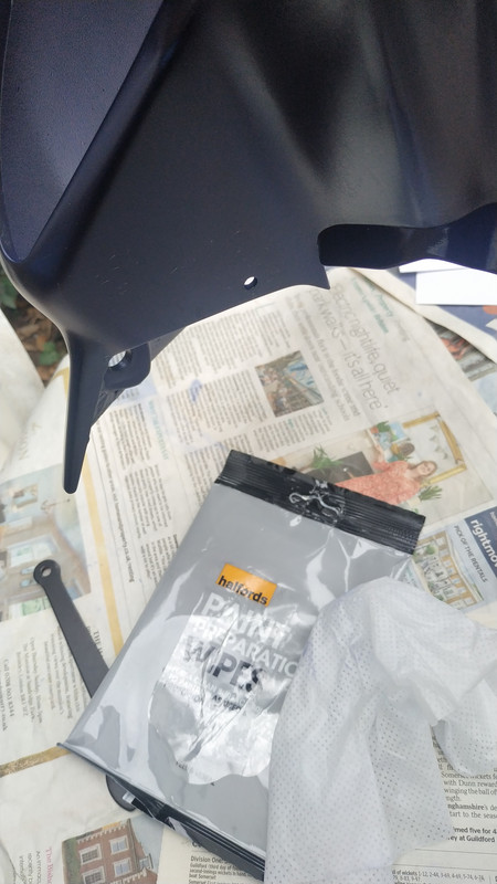

I was wiping these fibers when I knocked the gun. Going in the bin, what should I buy? Cant avoid dust so I need some kind of wipe.

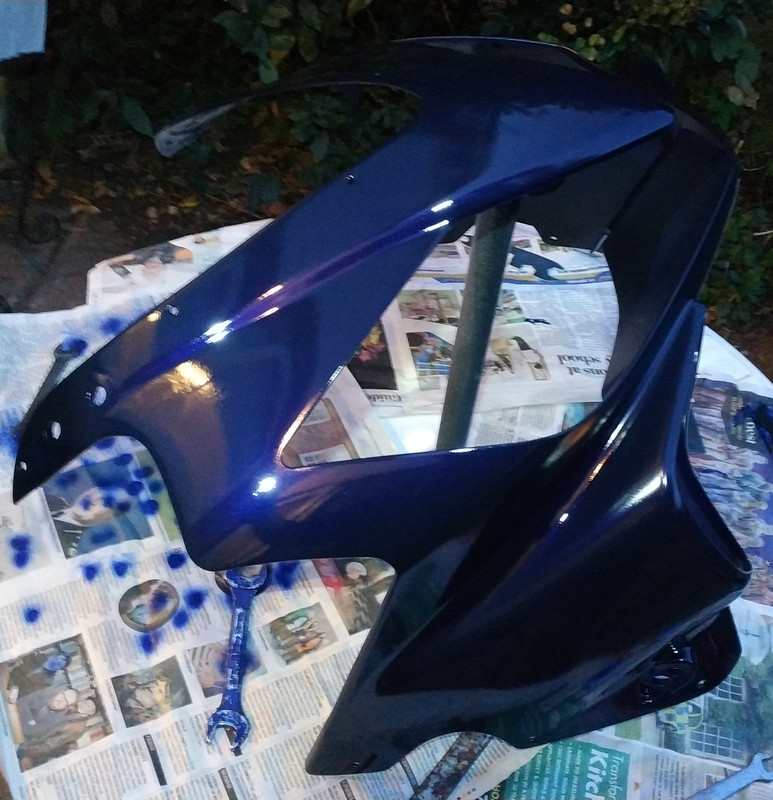

gave two more coats and got some runs.
