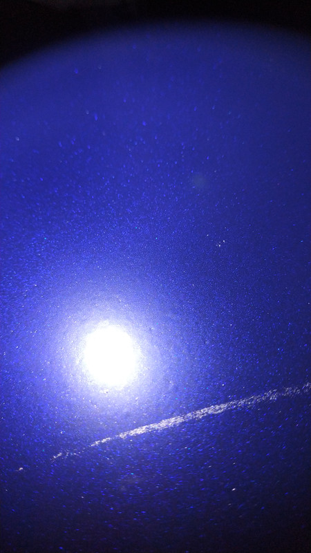

Something is not as you think then, does the finish still have a Shine ?Ok I am probably not doing 2k this year, but it would make sense to buy just one 5l bottle than several small bottles. There is one ebay shop nearby Ive asked if I can collect from.
This is old paint from halfords, no TDS just what they told me, and they said cellulose thinners, which is what Ive used so far.
I used that stuff once, the metallic flakes didn't go on very evenThere was at one time a cellulose single coat met. It wasn't good though.

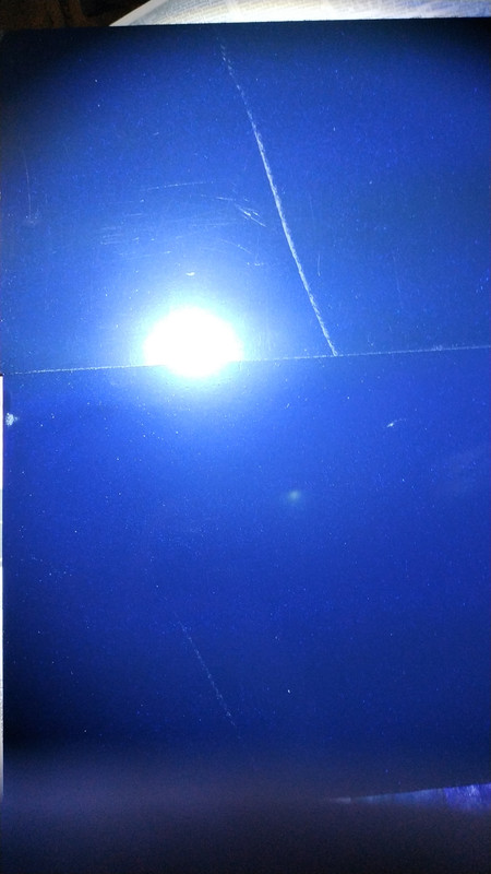

How would you change gun settings for a drop coat? Youtube suggests turning the pressure up and a bit more distance, moving quicker.

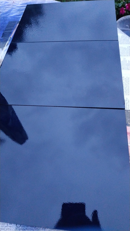

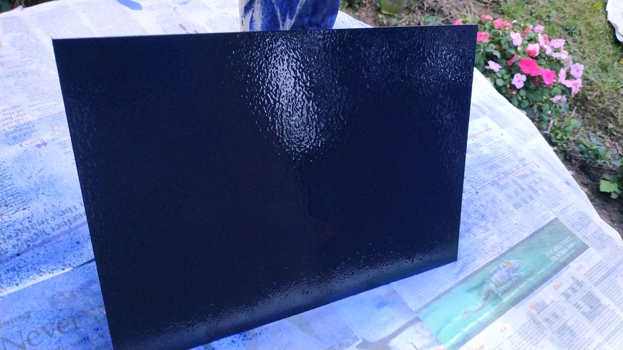

Is that dry ? If it is it's not base coat![]()
Much better.
For the drop coat I would turn the pressure down. Otherwise I agree with the suggestion of more distance and moving quickly.
