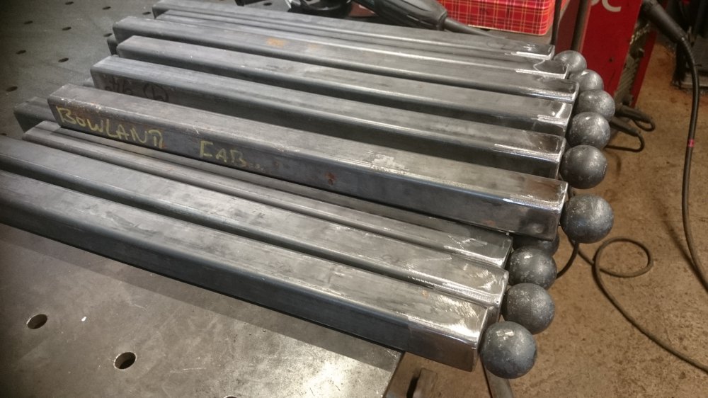

How I worked out the spacing was to mark the centre of the gate and then have the scrolls all equal length and meet in the centre. Then marked 50mm either side of centre for the verticals railings and then 100mm from then on outwards so the spacing between all the railings is 100mm except for the railing at each end of the gate which turned out approx. 40mm from the end of the gate.
