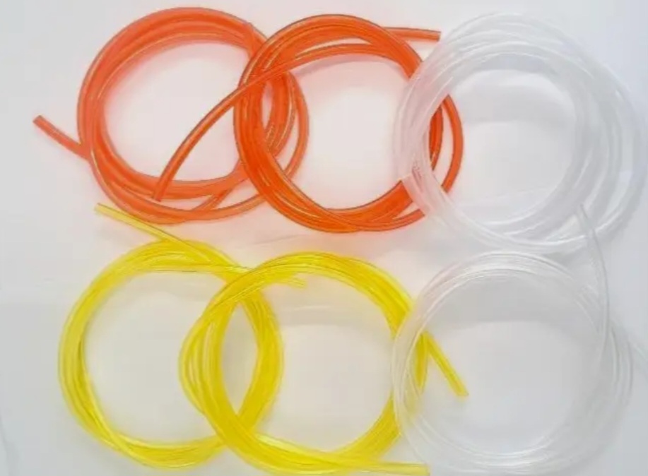

Anyone repairing their small 2 stroke garden equipment will have to replace fuel hoses now and again. Usually it's this type of hose:
The above aftermarket hose types which will be the top search results when buying replacement hose is terrible quality. It will harden up only a few months after install and just isn't good enough quality.
