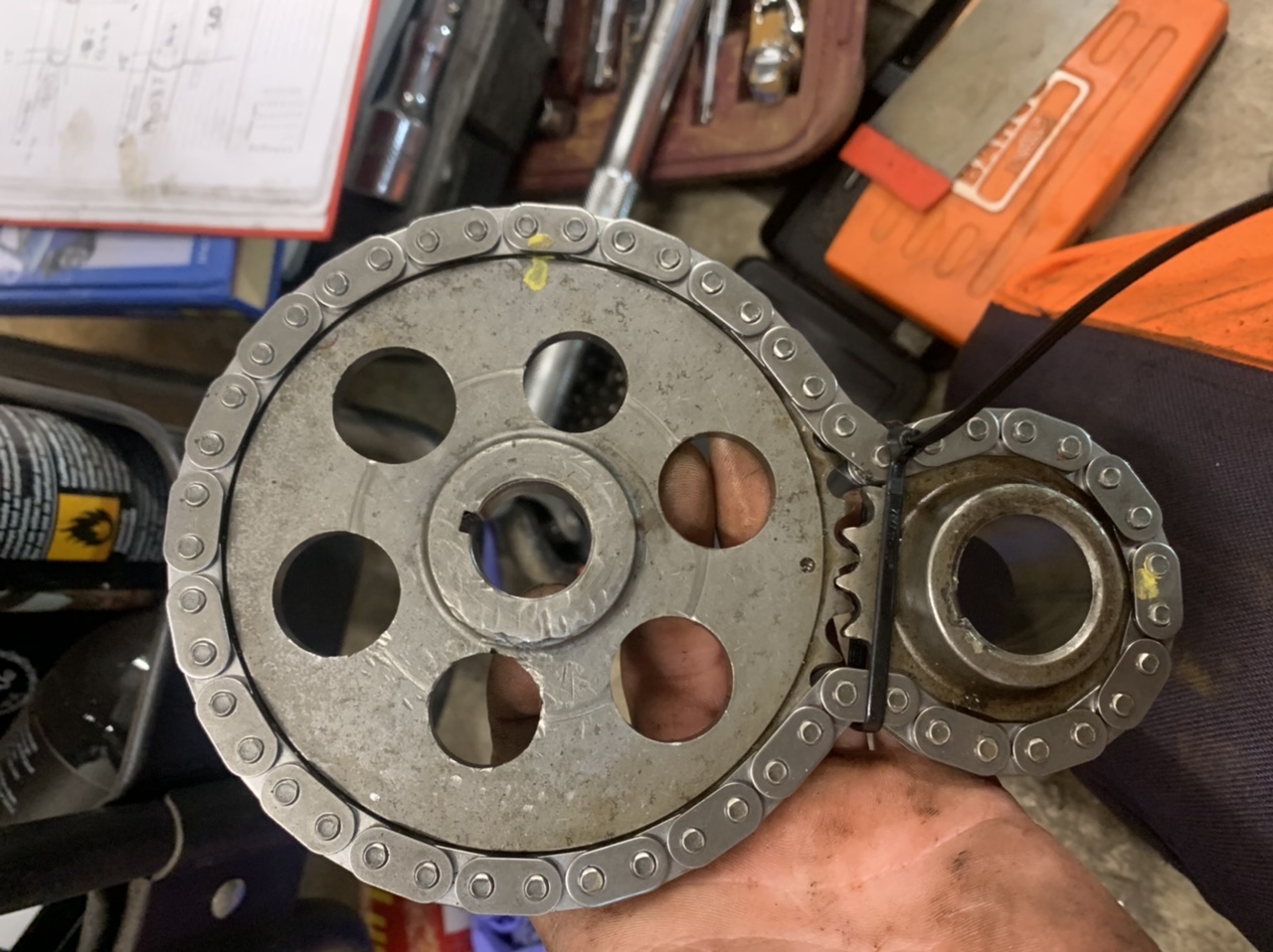

    Spoken to Keith Calver regarding duplex timing gears and he advised that his IWIS simplex big pin timing chain is a straight swap for the standard SPi chain and I can retain my tensioner and gears and is suitable up to full race spec so I’ve ordered one from him at £32+ the dreaded and it should be winging its way to me as we speak. He reckons most duplex stuff out there these days is cheap and of poor quality.

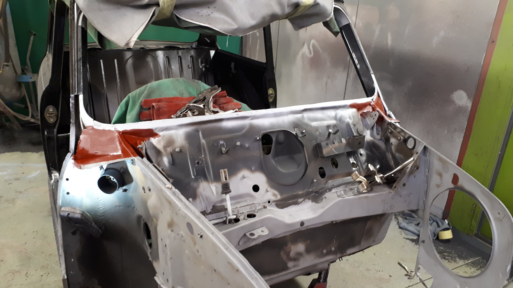

  12. Exuptoy
    Exuptoy Member
    Messages:
    2,524
    Location:
    Maesteg, South Wales

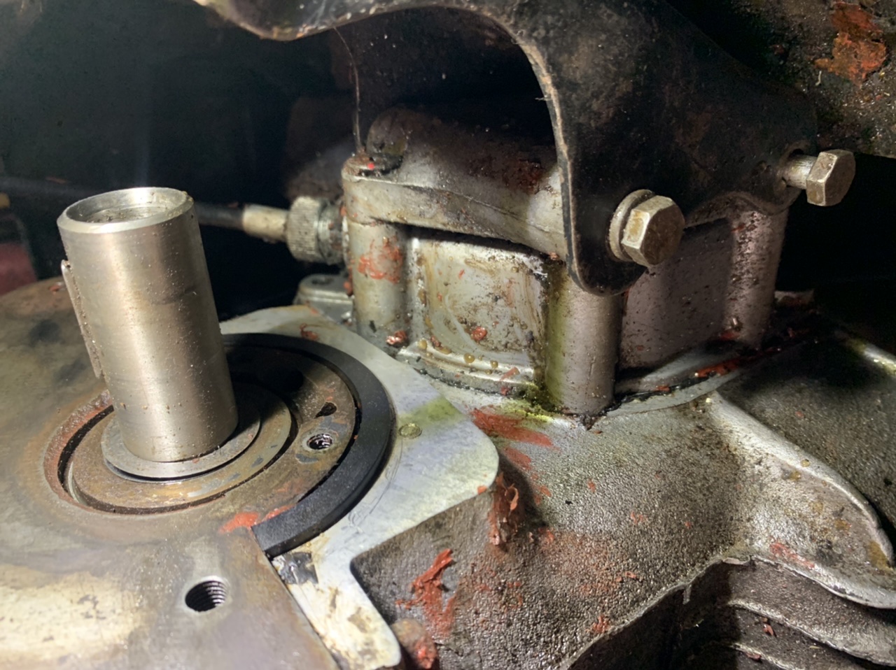

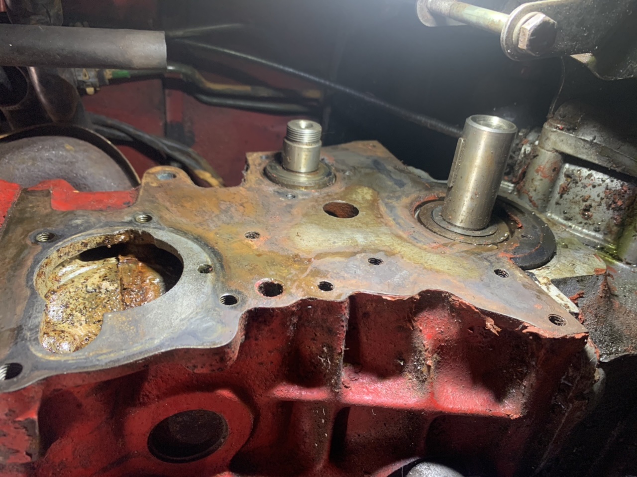

    Thought I’d fit my new engine parts today, removed the water pump, removed the timing chain, cleaned the front plate ready for my new chain, started to reassemble and noticed some buffoon had placed too long a bolt in the top of the timing cover which has jacked out the plate bending it then damaged the thread!!! All back off then ordered a new front timing plate from mini spares.
    My new Calver heavier duty big pin IWIS chain.
    676E684F-FBED-4970-AFFA-F2CD5BCE3AA9.jpeg D8C03AAC-19ED-4B3B-9143-E0C1298ED2F4.jpeg

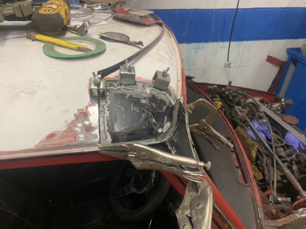

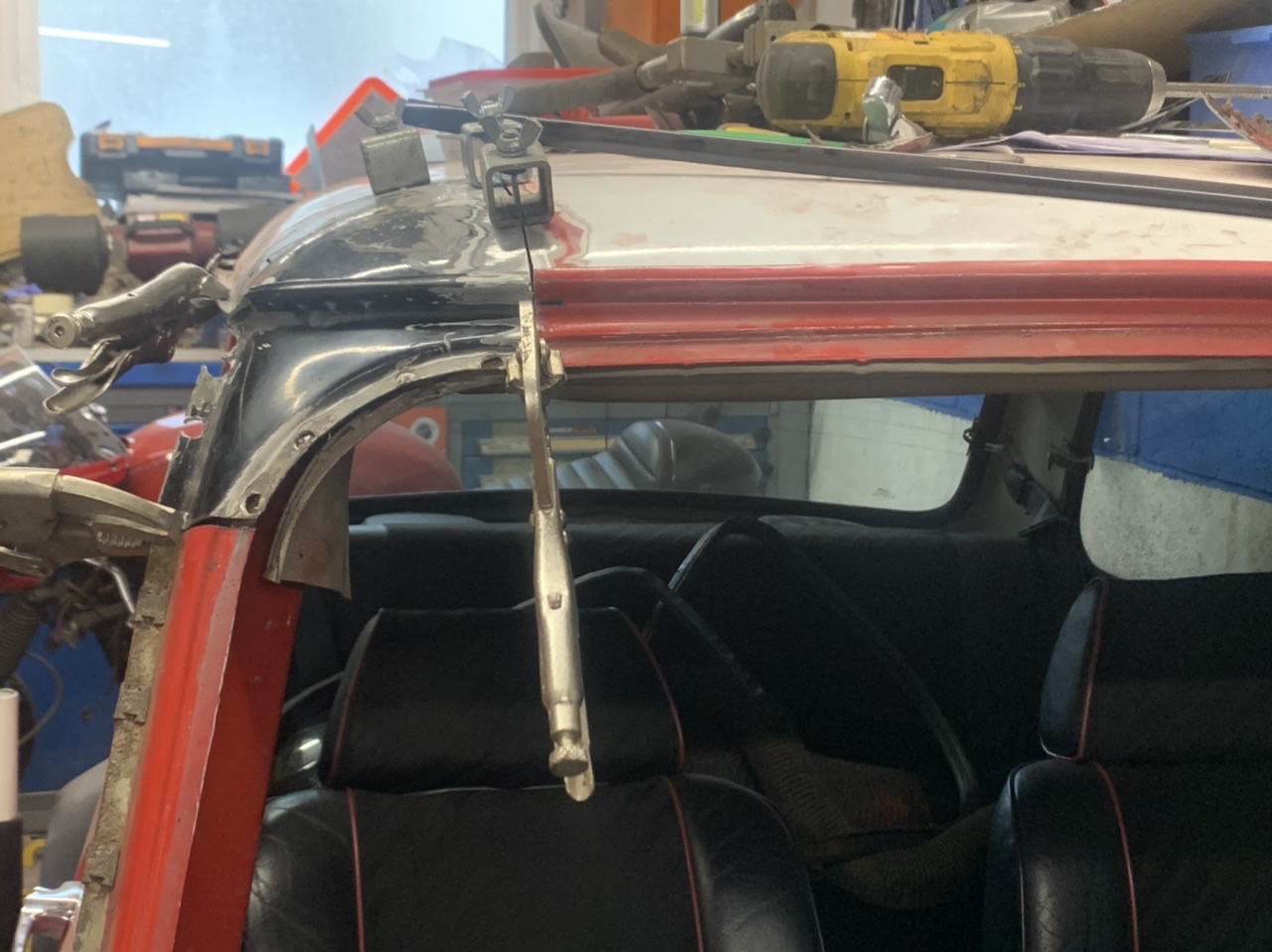

    Slightly dejected I decided to pick apart my front corner then trimmed the rot out of the roof.
    Just need to collect gas in the morning and I can glue it in.
    Quite happy with the outcome.
    E09091D2-33A1-45CD-A12A-930A3460575B.jpeg AA2E9D1B-4B1F-42C1-A1BC-3BD8C7627CB8.jpeg

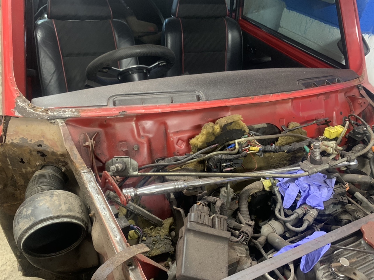

    Also cut out the scuttle which is in remarkable shape, just the ends to tidy up when I fit it.

    Your going to need to take the top dash pad out so you can grind off the rest of the scuttle and weld on the new one. Under that seam you will have a little rust.
    Your inner wings look a bit ropey too, if that was one I was restoring it would be getting new ones of those too.

    This is what needs to be removed when replacing the scuttle
    Nick DV and Exuptoy like this.
  16. Exuptoy
    Exuptoy Member
    Messages:
    2,524
    Location:
    Yeah, cheers fella, I know what needs removing. I just cut back to the edge to see what it was like under the scuttle. Top rail will be out shortly. This was never meant to be a restoration but a rolling resto to keep it somewhat mobile. .........it’s growing arms and legs :D
    I’ll be cleaning up the inners to see if they’re salvageable, if I can get away with repairs I might just do that. If not they’ll be coming out.
    I really need the interior out including the red carpets, half leather and back instead of out. We’ll see. I don’t want to go any further with the removal of the scuttle until I have the new one here to measure.
