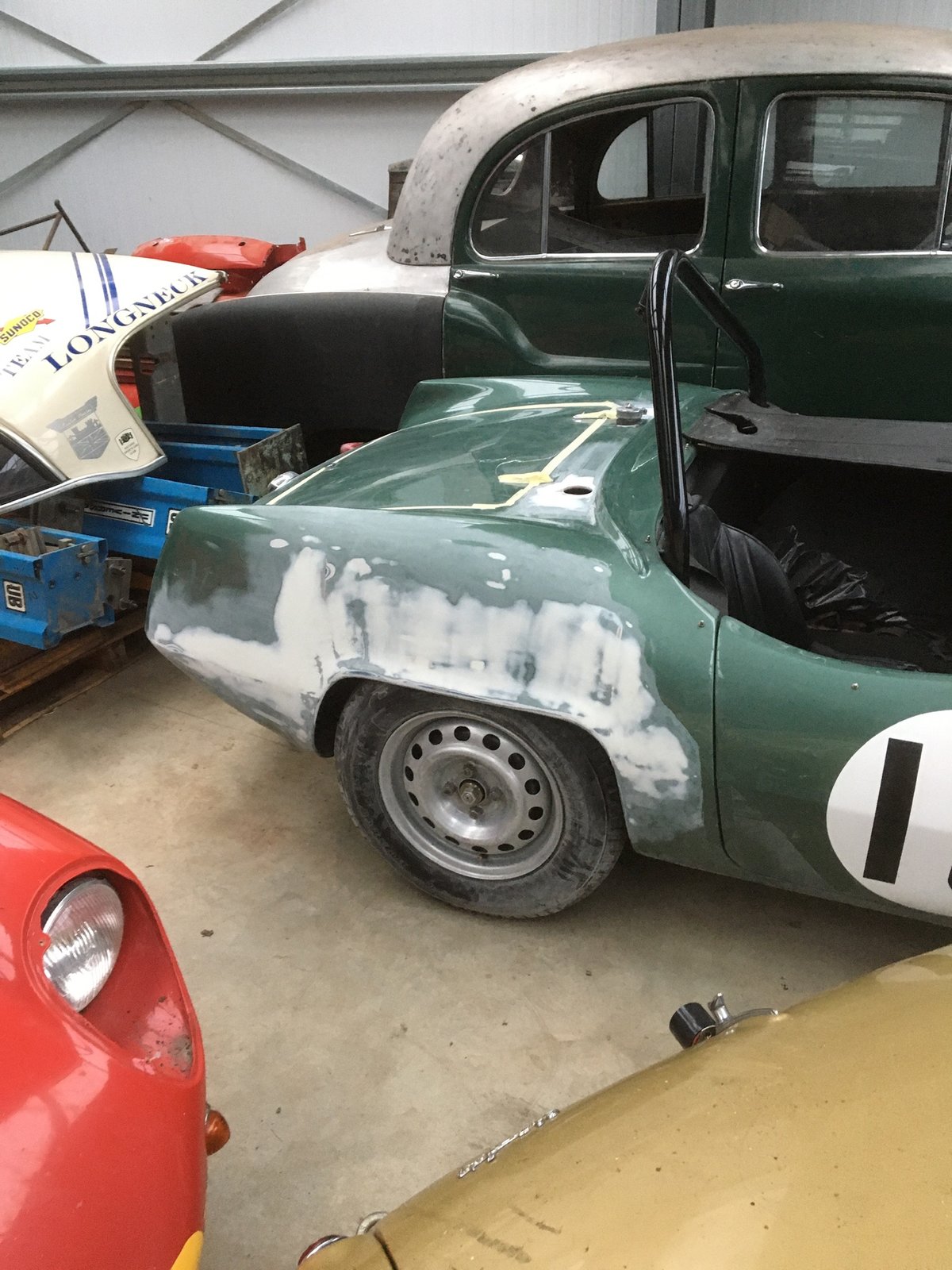

Yes you can take a mould from the original. You need a release agent of some sort. Various methods exist, you could paint it then thoroughly wax
I used kitchen cling film when I was modifying a nose cone, it works well enough and isn't fiddly or complicated.
