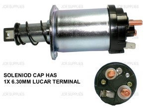

does sound like a bad starter, lead or possibly ignition switchThis could just be a bad starter signal lead where it connects to the starter, had one similar the other day on a jcb the current is VERY high on initial connection until the starter is engaged because the signal wire actually turns the starter initially and can be drawing 60 70 amps initially then the hold in current is a lot less, by using jumper leads you allow more current but mainly voltage to flow through to the bad connection forcing the leads push fit lucar connector to spark and forcing it to make the trip. The way to check is to get someone to operate the key to start whilst you jiggle the connector.

What's a lucar? I'm still catching up with electronics and cars!Just remembered had a freelander doing exactly the same mates daughters car he put a starter, battery exta earth etc and all it was was the lucar.
