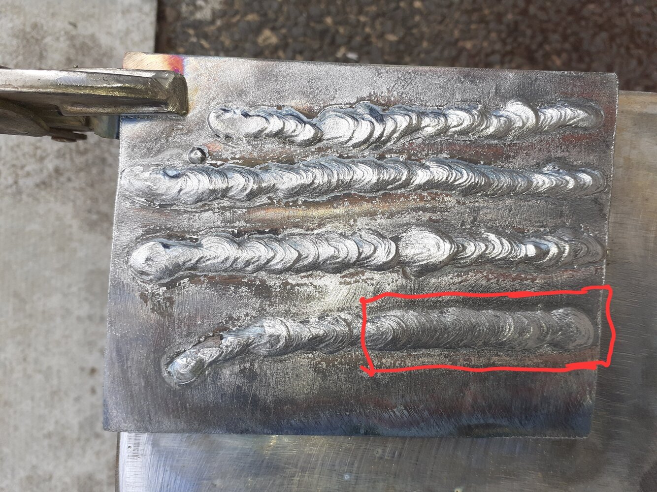

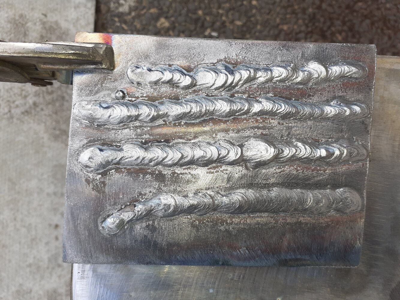

No whipping, just need to work on the hand steadiness.No need for pix of gloves.

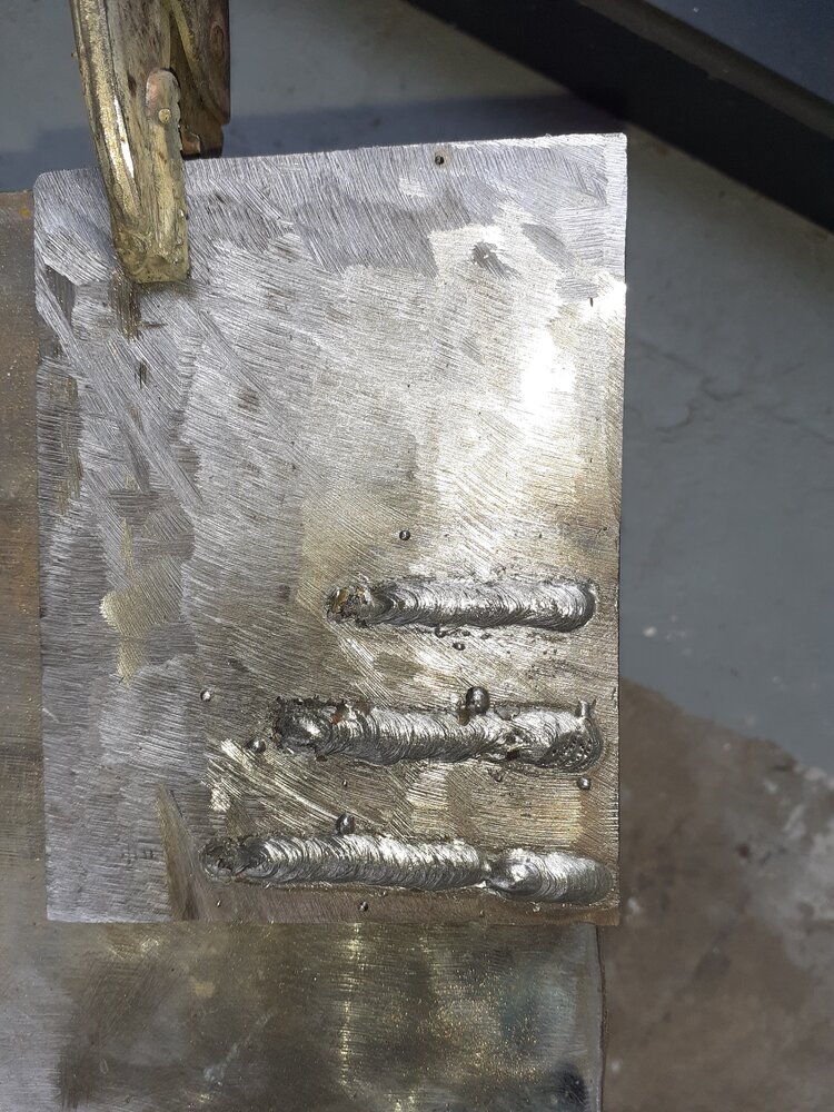

Back to the new pix, steeper angle, almost straight on, maybe 5-10 degrees total tilt.
Are you whipping ?
Inconsistent puddle looks like a whip motion.
Lay the rod in there, let it do it's work, and watch the leading edge of the rod, allow a small
amount of puddle ahead, just a slight amount.
