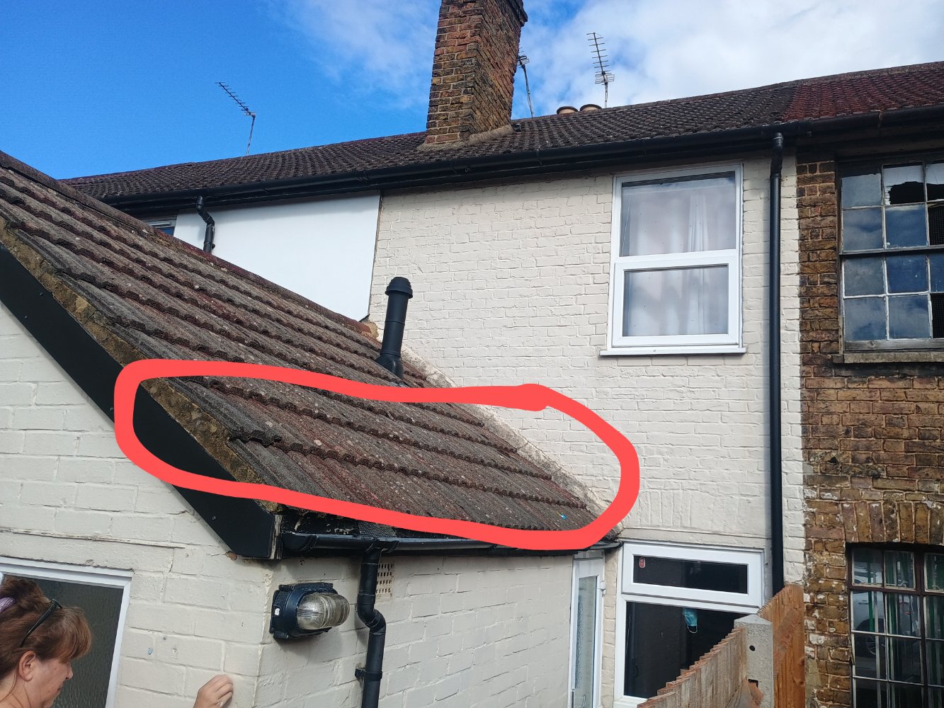

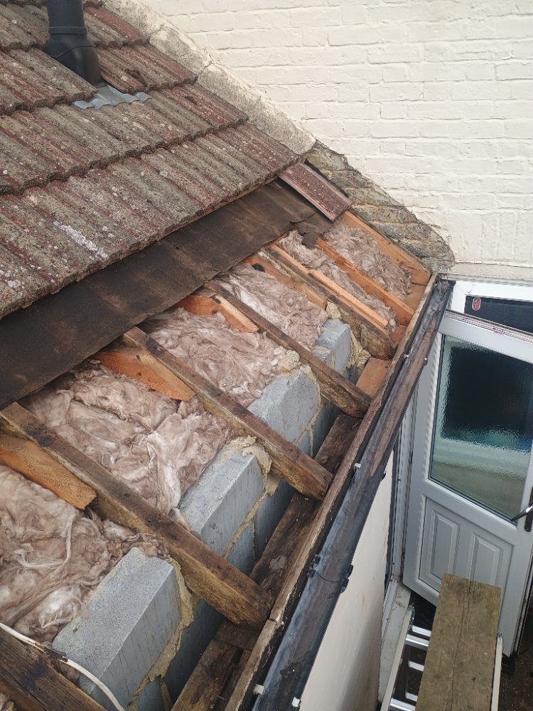

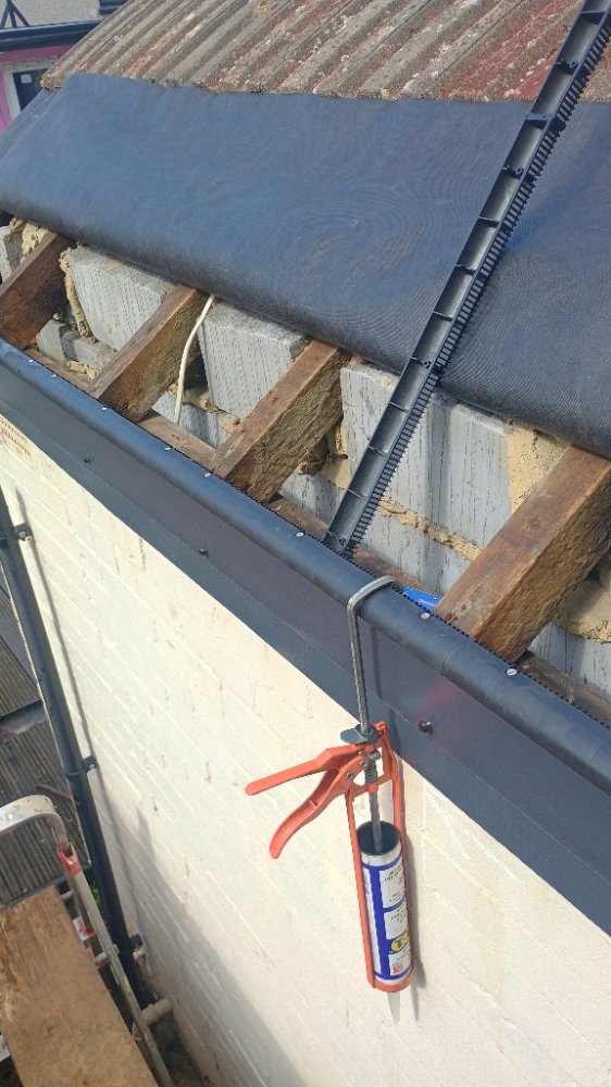

I need to revisit this and get it done. Thinking to lift a line of tiles and remove the old insulation with a garden rake. I just can't get in from the other end where the extension meets the house:
Then reinsulate the loft space to 270mm. I'll also insulate the angled roof bit.
