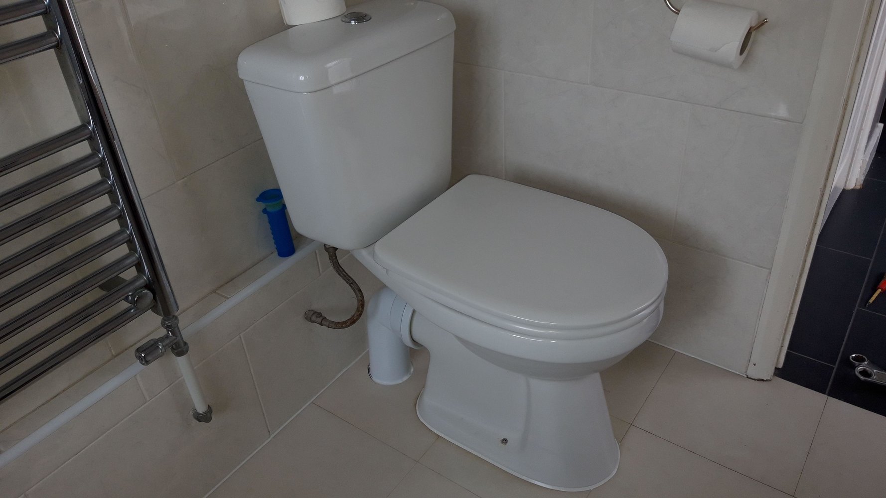

Looking to fit an "extractor fan" to a small bathroom extension. Bathroom window directly above the garden box:
Access into the roof space above the bathroom is likely doable:
Looking from the hatch to the end wall above the garden box:. There's a smattering of old fluffly insulation between the ceiling joists:
Trying to get some internal pictures. Thinking mabe a SELV extract directly above the bath but have to check heights to the ceiling ref Zones.
Mulling a single room MVHR unit with flexi duct out the end wall.
I can fit an isolator above the bathroom door entrance on that grey bit of wall behind the chandelier:
just needs to be rcd protected so no need for low voltage
