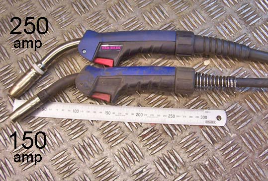

I’ve got a 16amp socket on the wall so wouldn’t have to bother with the 13amp plug but I think I’m going to make my own rather than buying one as someone previously said you don’t want it all coiled up, do you have any idea would my welder (parweld 171c) still be ok using 0.8wire with a 4m torchI would make a lead with a 16 amp trailing (commando) socket on one end and a quality 13 amp plug on the other, then fit 16 amp plugs to the welders, they are much more robust and safer for something that is going to spend most of its time kicking around on the floor.
