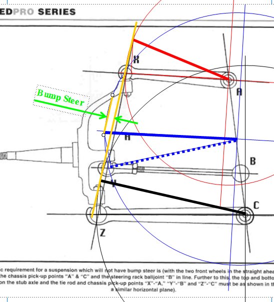

PS escort have very little ackerman due to the rack being in front of the tca's and the clearance from the tre's to the disc's is limited.
Because he will end up with massive bumpsteerwhy don't you just modify the chassis and move the suspension mounts to make the wheel base wider and have some threaded extensions made to make the track rods longer then you only have the anti roll bar to sort and wont have any problems in the future if you need new track control arms having to modify them
why if he is moving everything out the same amountBecause he will end up with massive bumpsteer
