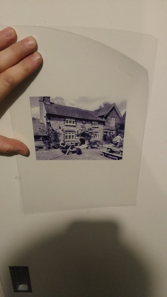

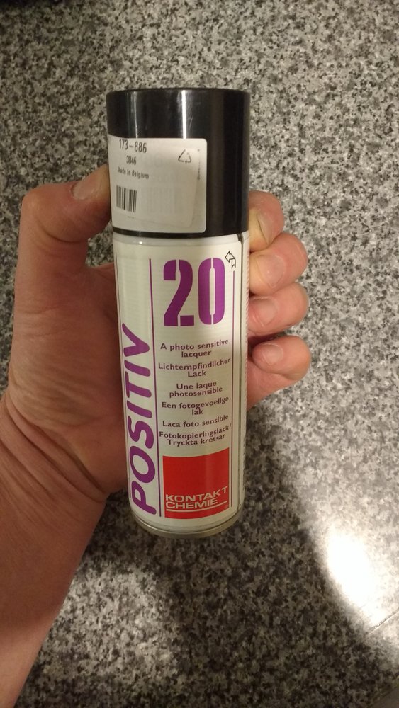

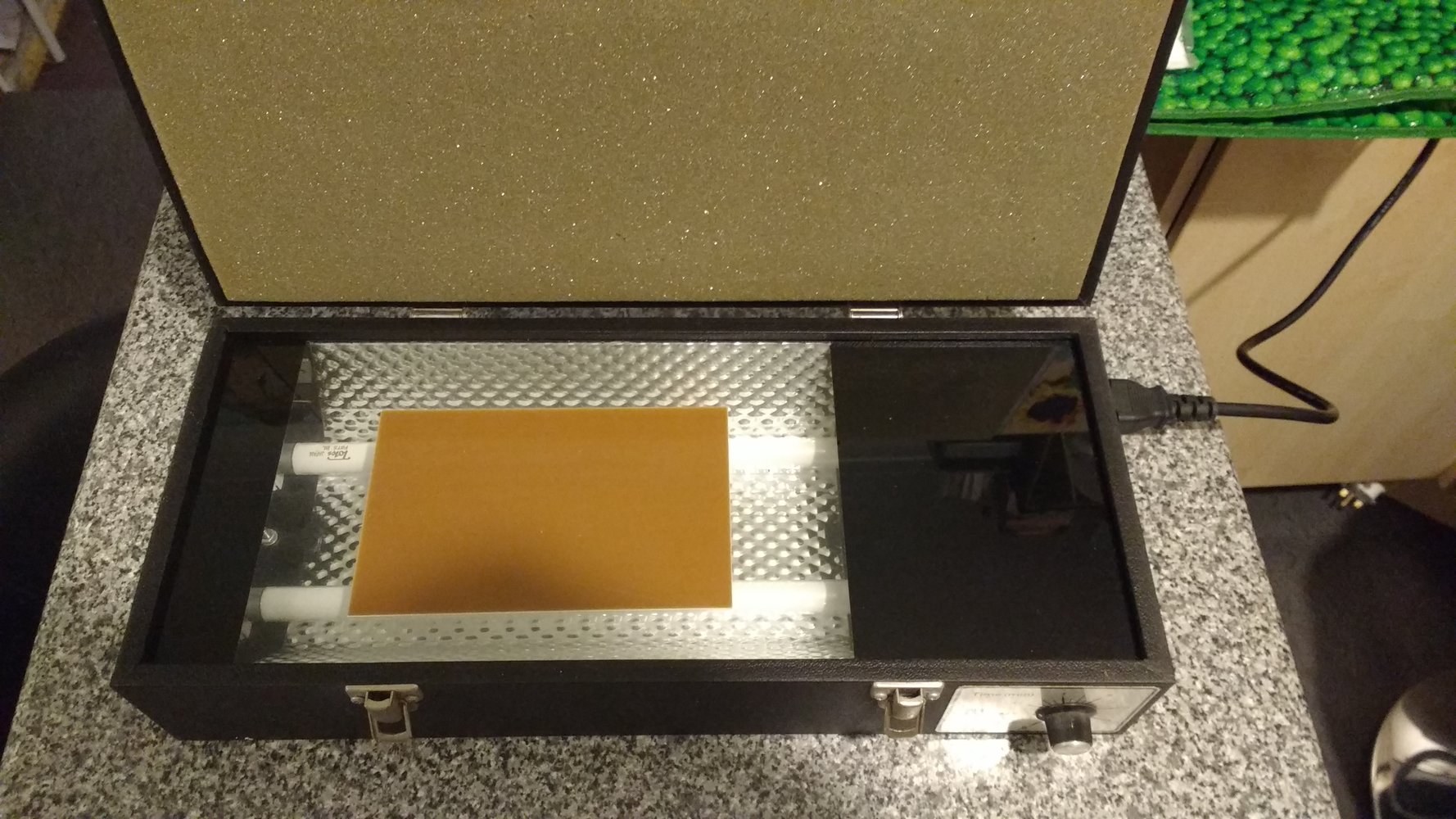

Used to do it for PCBs a lot, as a kid. Started drawing on plain copper with a Dalo pen, all freehand. Permanent markers were good too and cheaper. Moved onto rub down transfers. Tried the one you printed onto a sheet that you ironed onto plain copper PCB.
Then I got a UV light box. From memory I'd print onto clear sheet, expose in the light box, place in developer then etch.
I've got SWMBO off looking for the light box she "moved" recently. Just for a play I was going to overlay one of the pub prints onto some photo resist board I have here and see what result I get.

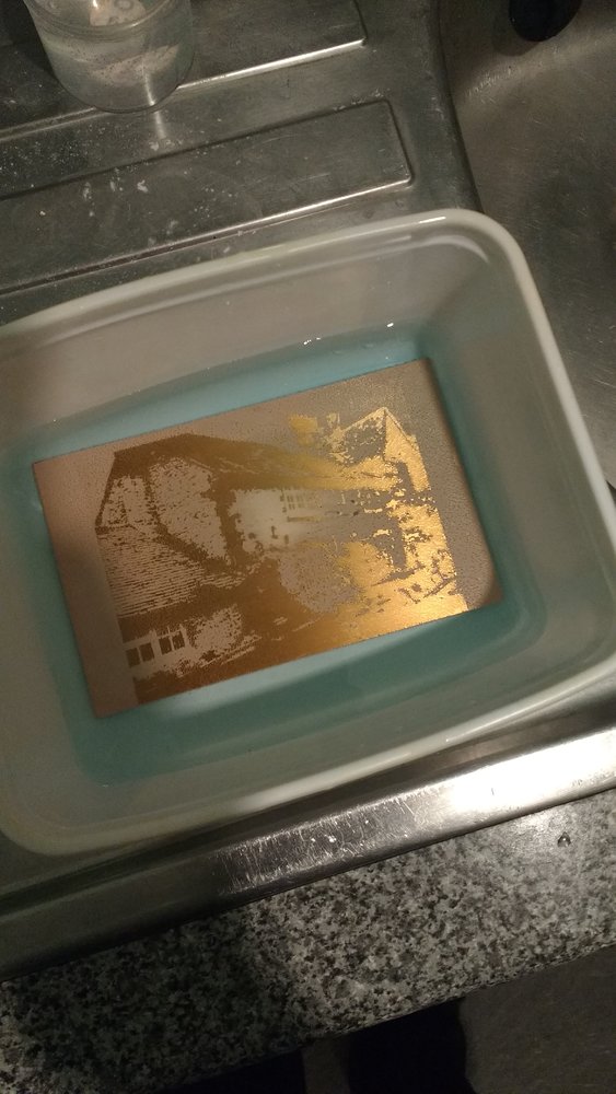

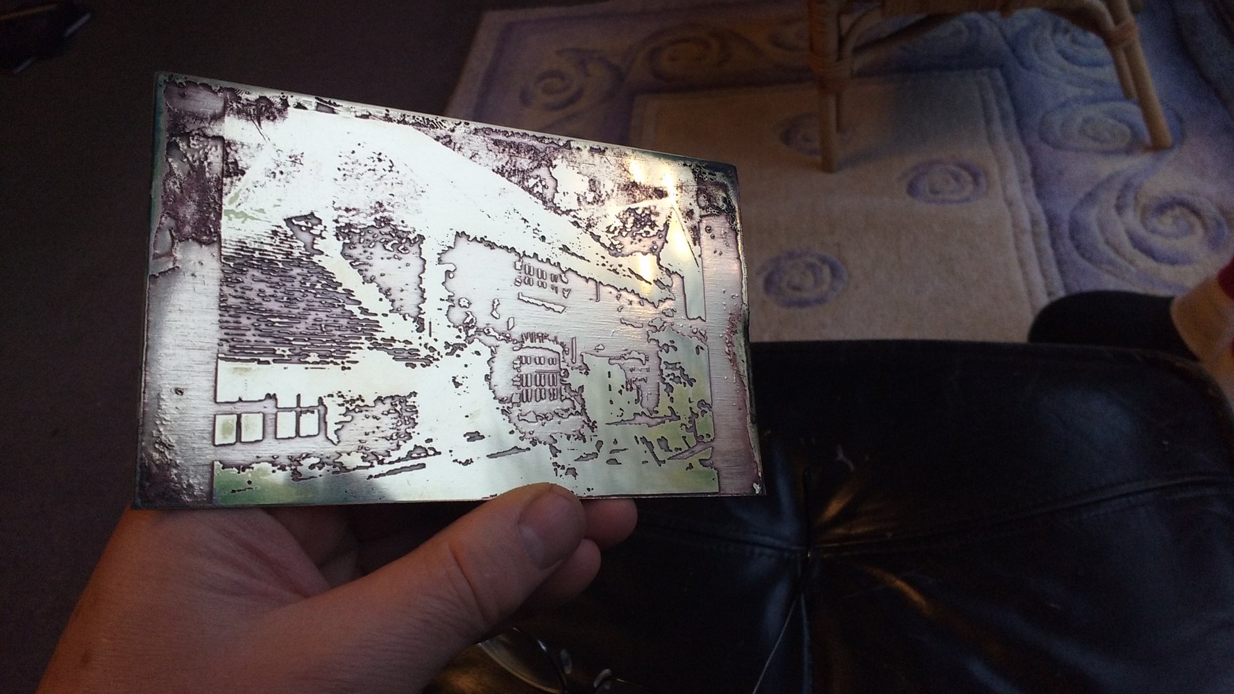

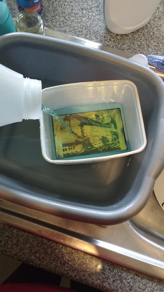

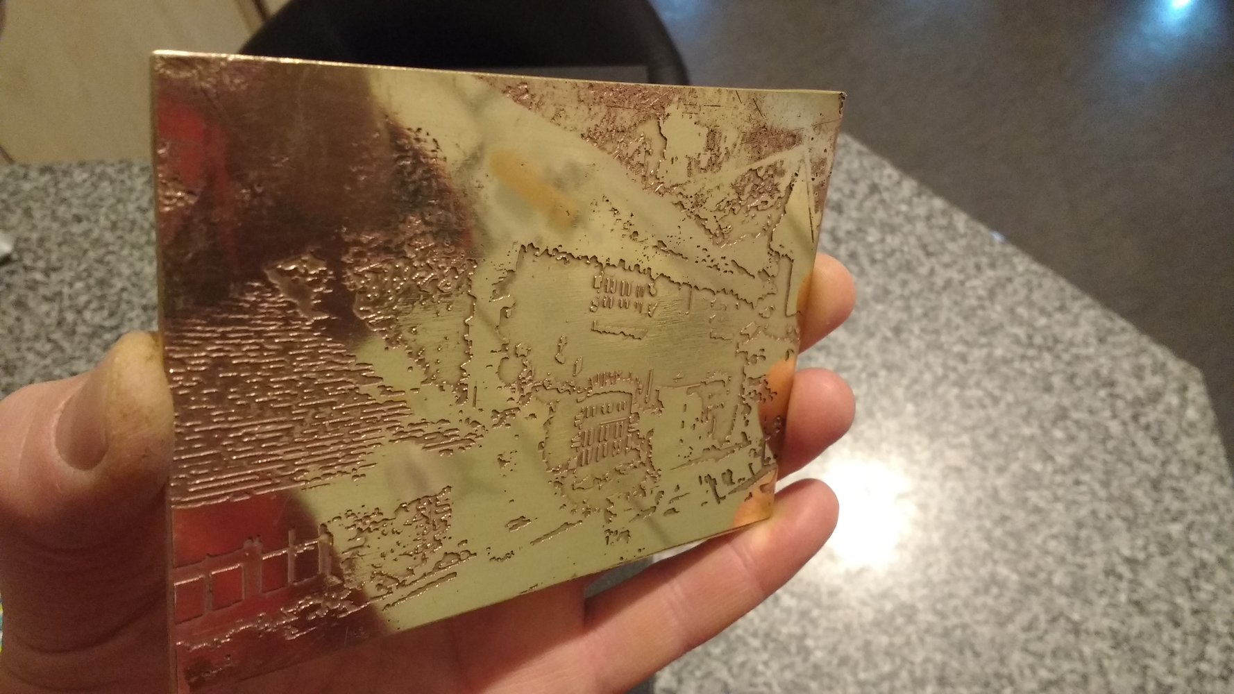

What I'm interested in is how you do it on solid copper sheet. How do you protect the back side of the copper sheet whilst it's in the etch tank?
Cheers
