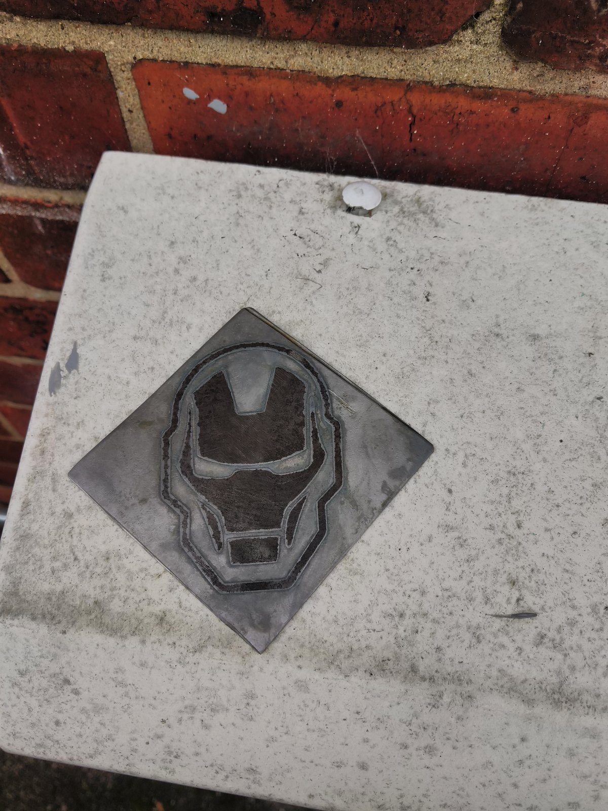

Todays project.

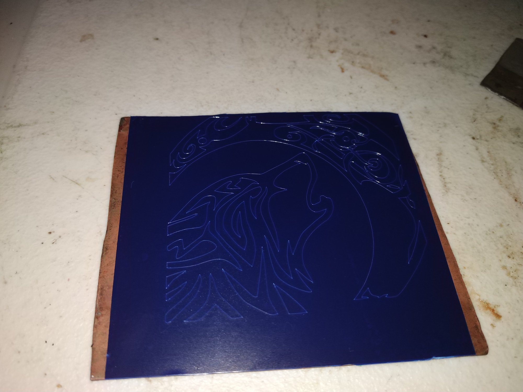

A piece of zintec.

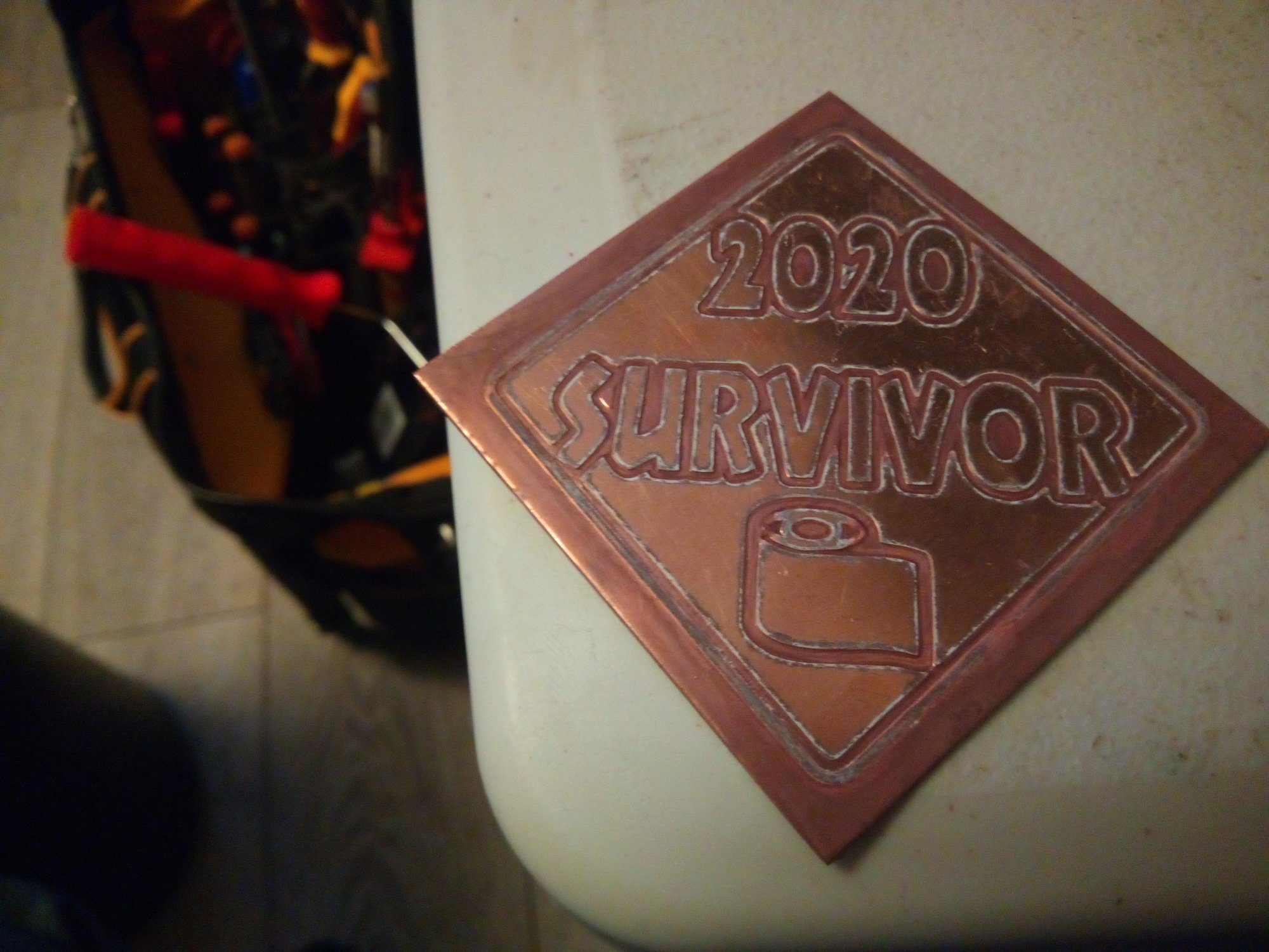

Rough copper plated by dipping in HCL + Copper sulphate.

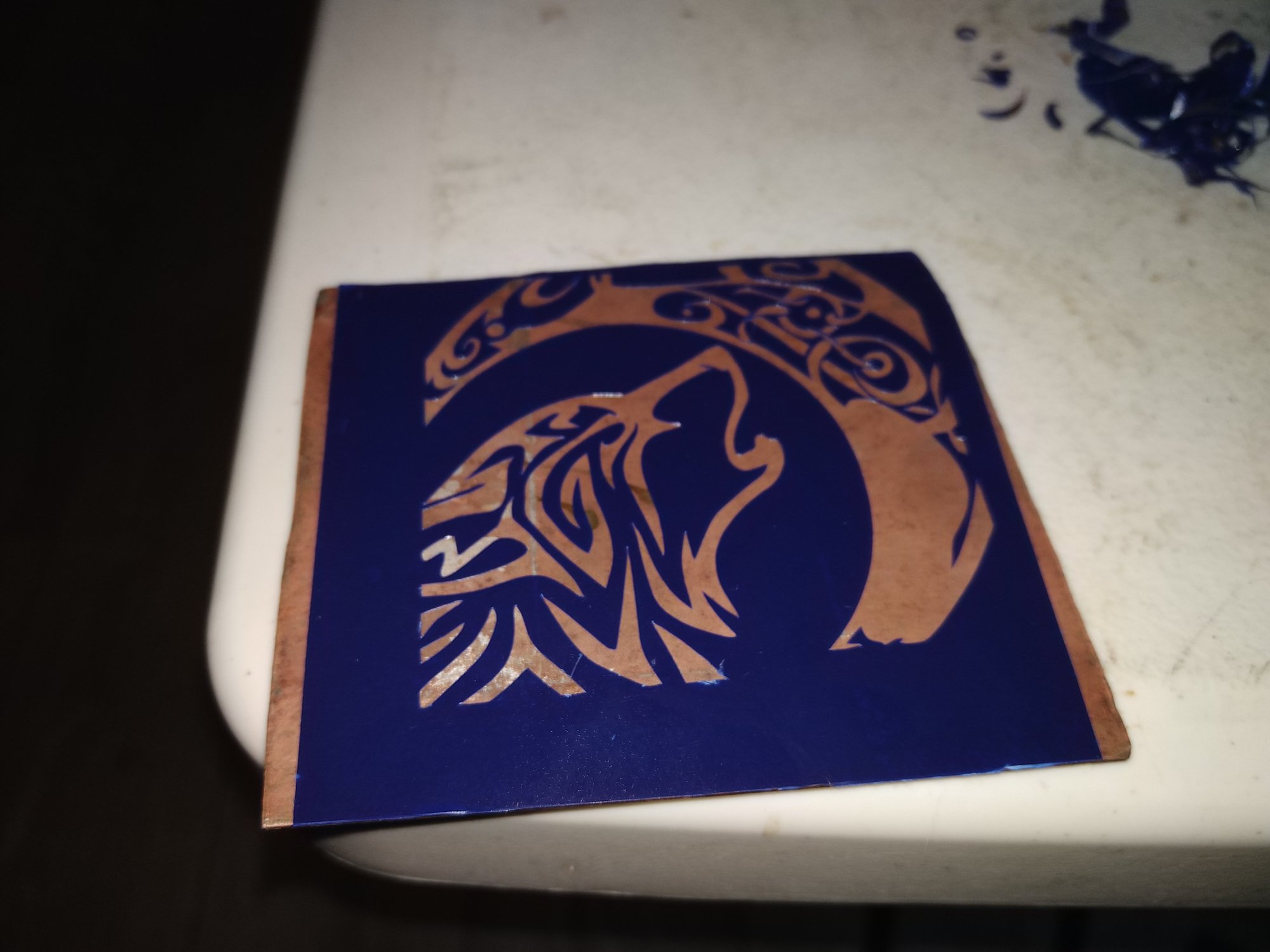

Vinyl stencil applied.
(Silhouette cameo cutter + cheapest t'bay vinyl)

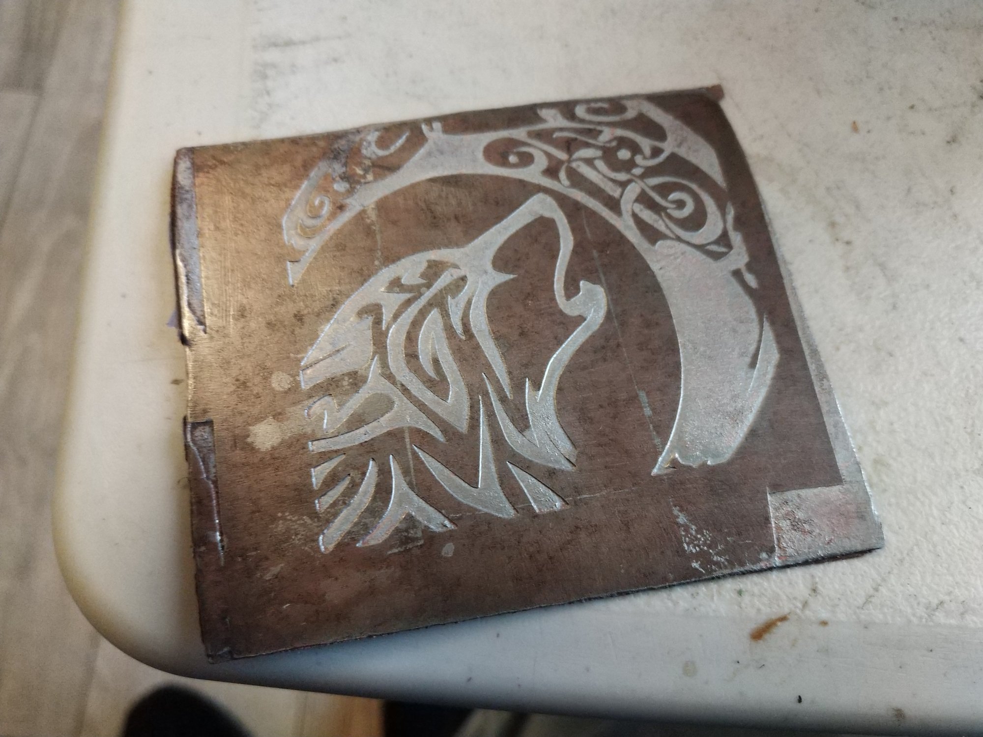

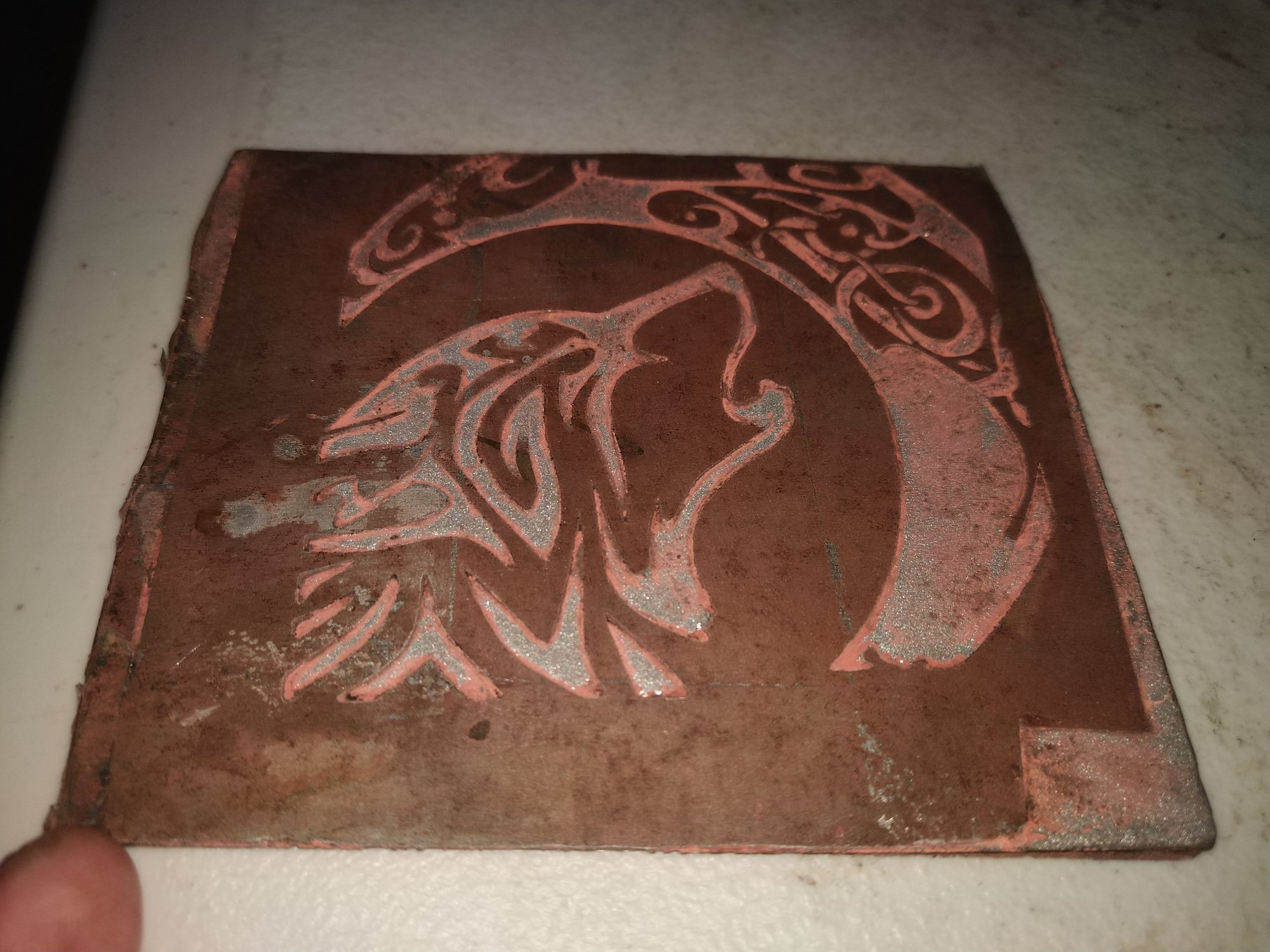

Weeded.
Etched by reversing the electrodes in my electrolysis rust remover tank.
(10 mins with a 13.8v /2A CB power supply)
I need to sort out my plating tanks.

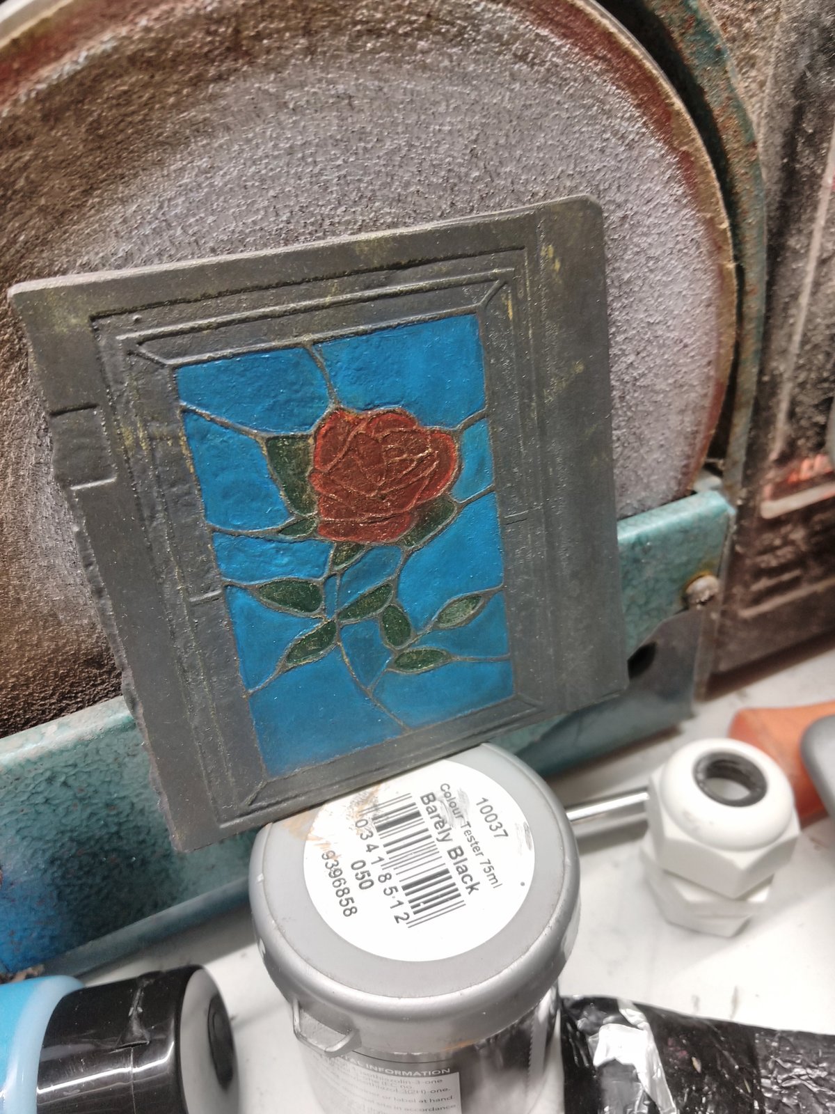

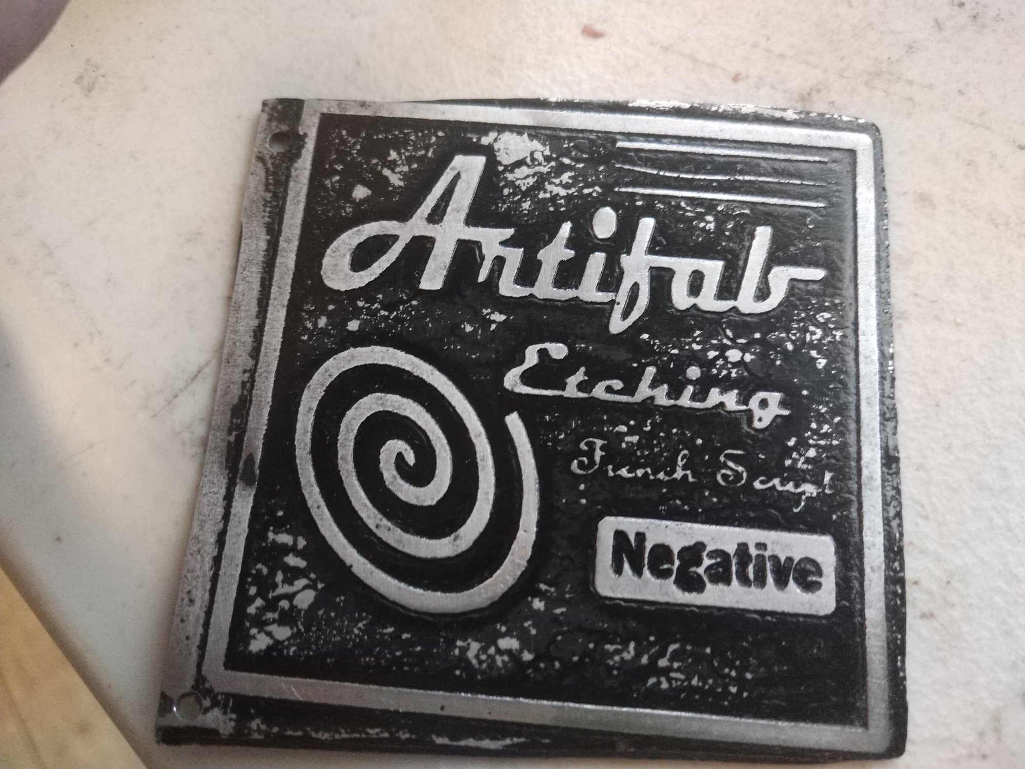

The idea is to copper plate the entire thing, then etch off the copper and 0.2mm ish of steel and nickel plate the etched parts to get a multi-tone effect.
