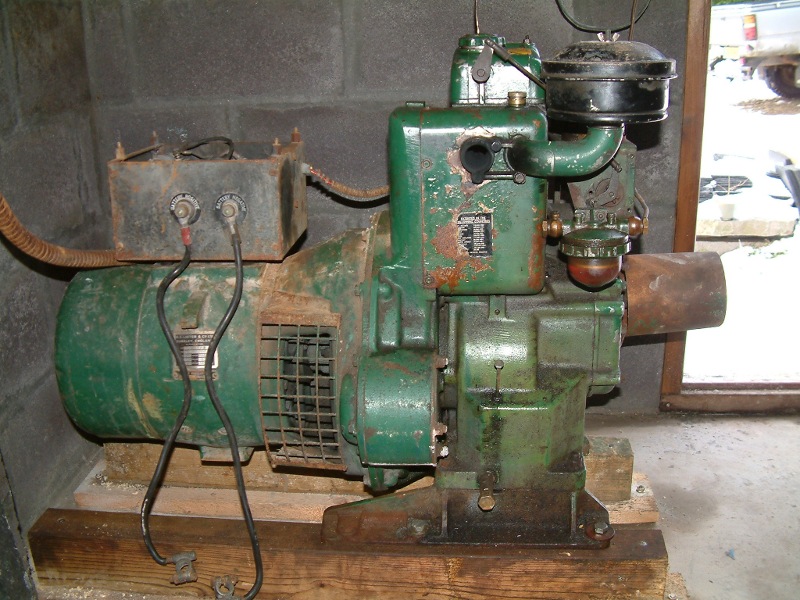

strange that, all of the pumps that i've seen are rubber mounted in /on their frames which are usually massive box section in a H pattern the box then forms the chassis and fuel tank , because pumps need to be qiet also, they don't have auto start but do have auto stop controls on them. None seem to vibrate enough to damage anything.The couple of replies since I started typing... talk about flexable mountings. Don't do it. They need to be well bolted down to hefty bases. Vibration will destroy the control units. As in. the solenoids that control the decompressor and the fuel control. Been there....

) more modern units might have a bit more dynamic design to avoid vibrations at their operating RPM. And usually multicylinder, which makes it easier. Stopping a single leaping around has got to be difficult.
I think you might have to be more specific as to which set you are talking about
