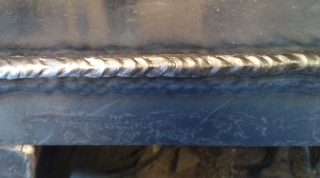

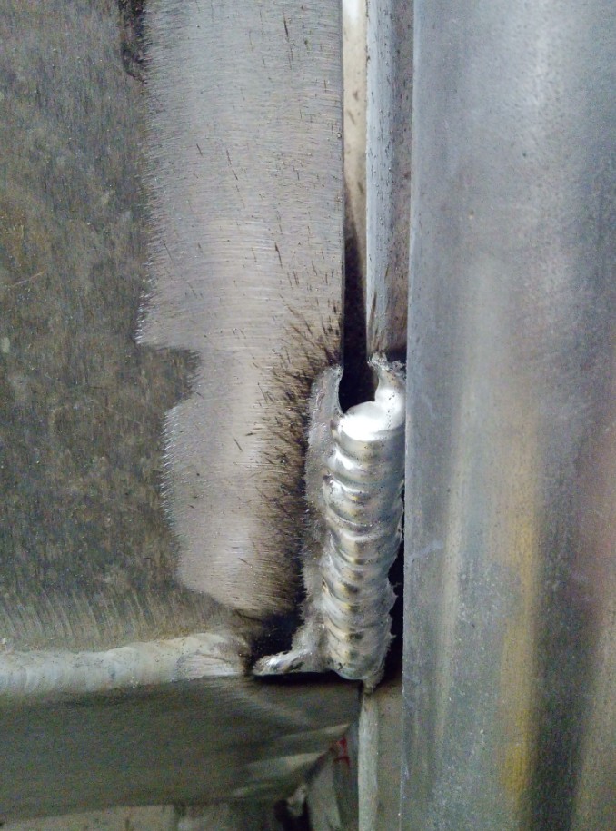

Have been messing with the settings again in SuperPulse and I am starting to like the results a lot, especially on outside corners

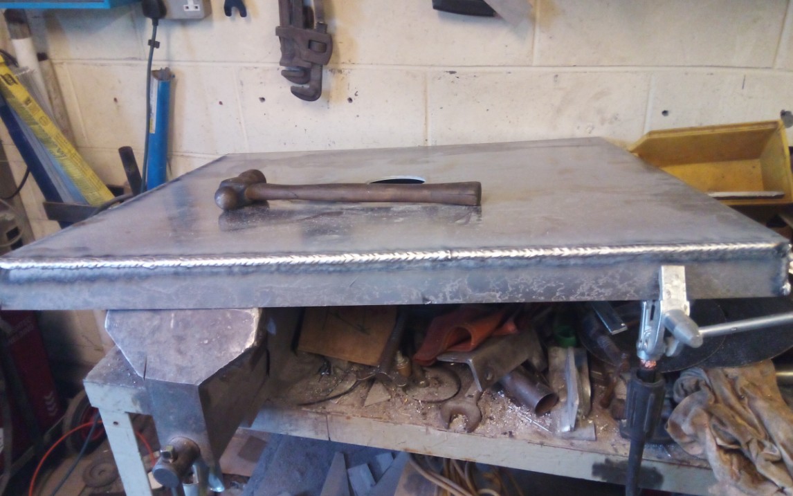

Pic of the outside of the Donkey enging box lid I have just done.
