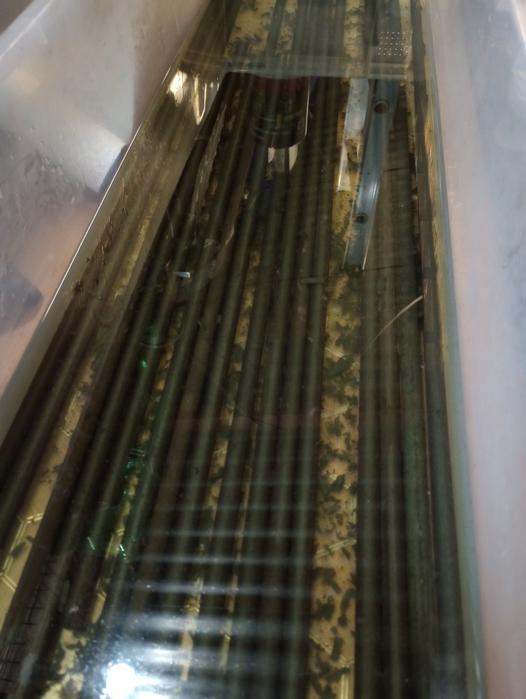

Plasticine dam around the scablooks impressive , shame its not so easy to dunk a wing or door with a scab in the middle
unless we club together and fill a paddling pool with it

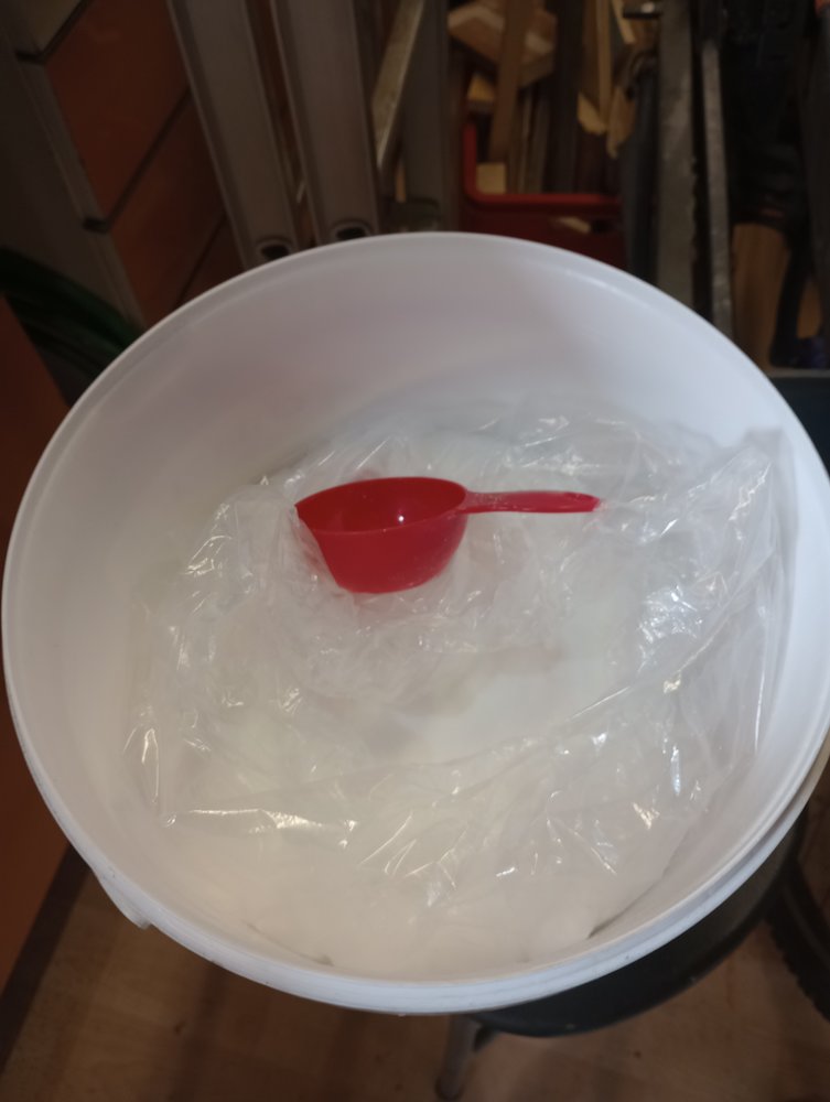

Another trick with it is heavy duty rubble sack.
Part inside sack with some ER solution.
Place sack in a large bucket /container and fill container with water.
That way you don’t need a huge tub and litres of evaporust to get a result, just enough active fluid to do the job and water compressed it around the part in the bag

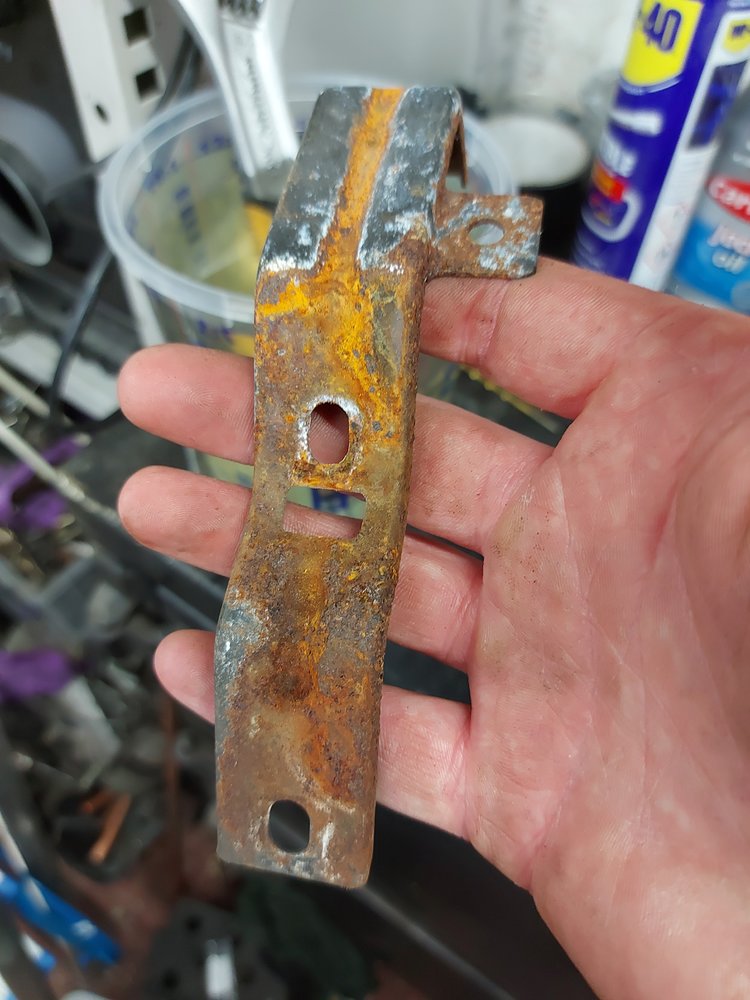

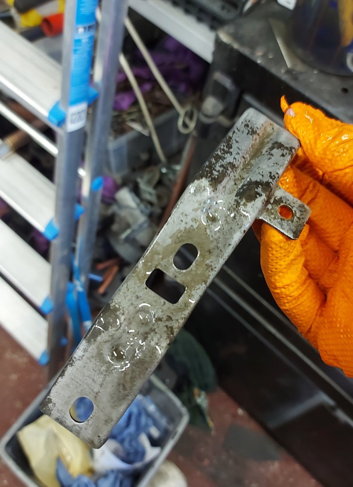

Was that citric or evaporust?This is that rusty bracket left overnight. All rust gone when I wash it, it will be clean metal ready for etch primer.
View attachment 406482View attachment 406483
The stuff treated with it also doesn't seem to flash rust too quick. I know when I have used electrolysis etc it rusts before your eyes afterwards! That spanner has sat out since for more than 24hrs and not a single dot of flash rust. I'll treat it with the tool wax when it turns up in post.

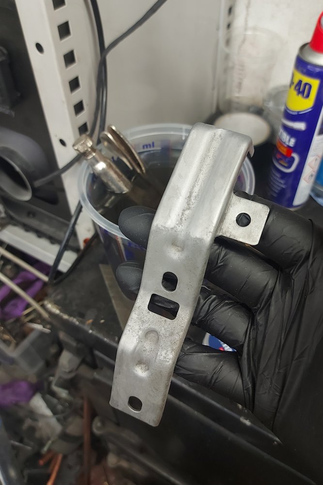

Evaporust I am the OP who is testing it out for the first timeWas that citric or evaporust?

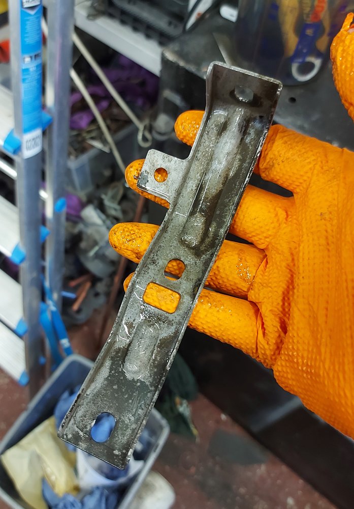

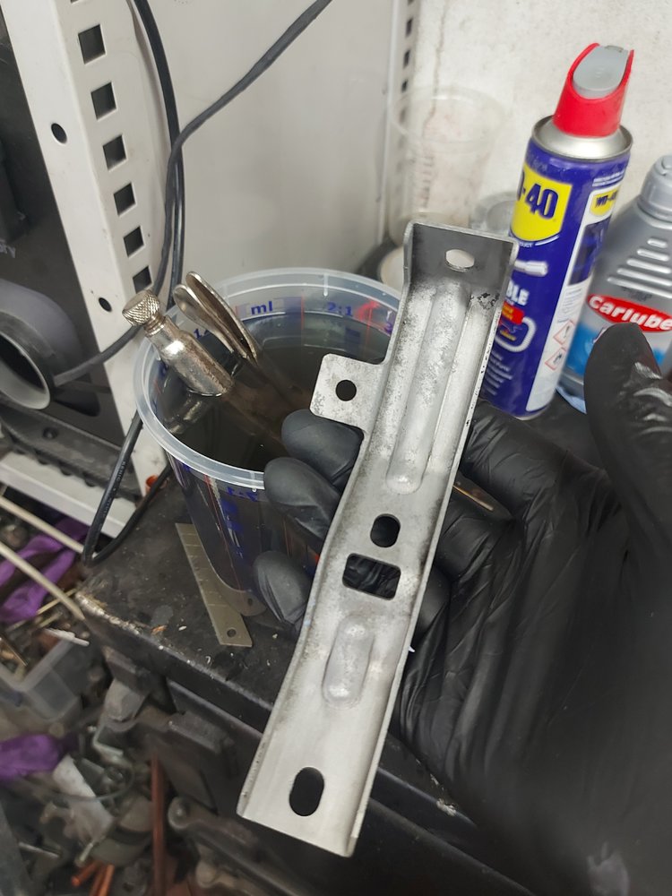

So when the part is removed from evaporust, what further work needs to be done.I had time to remove this bracket from the drink tonight after 48 hrs and etch primed it.
The rust removal is impressive, the light factory paint came off too
View attachment 406616View attachment 406617
