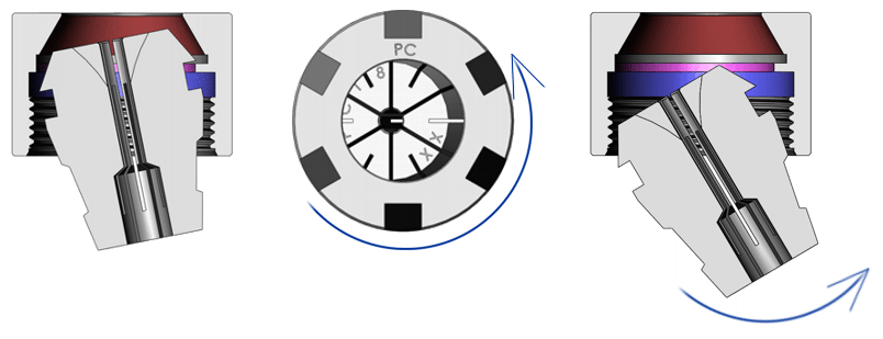

    Sorry to point out the obvious here but you are seating the collet in the ecentric ring within the nut aren’t you?

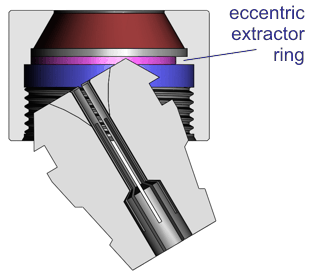

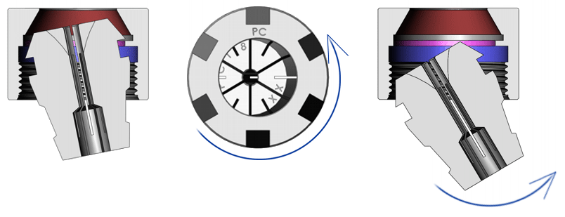

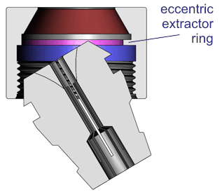

    The collet needs to be snapped into the nut before screwing both into the holder. The nut will retain the collet.
    You then have to put sideways pressure on the collet to release it from the nut.
    The ecentric ring within the nut is what breaks the taper when unscrewing the collet.

    I had exactly the same problem - ordered an ER32 MT3 chuck and a bunch of collets, couldn't get the nut to screw on when fitting a collet. I contacted the Chinese seller and they apologised and gave me a £5 credit so I could buy a new nut - bought one off ebay for £3.99, which was exactly the same.
    Then I realised my error, that it's an eccentric fit and you click the collet into the nut and then screw it to the holder. Oops :ashamed:

    I looked into mine and thought it had been machined badly when I saw the off centre ring...:ashamed::doh:

    Well after Matt pointed out what a Wally I was I tried it earlier and it is so simple.
    Just pop it into place and it clicks. Twist it to remove - no effort at all.
    Quite happy with it now.
    I haven't checked runout yet - now where on Earth did I put that DTI?
